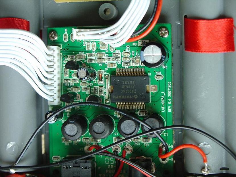

Nospam, I notice that your tri chip is not a 2024C? I have a gen 2 too and it's got a "C" at the end. How long ago did you buy yours?
Also, has anyone taken the caps and resistors out of the Gen 2 yet? I noticed that fastvideo said he had done the mods... but he also says that he gets a pop if he leaves the 4.7 cap in place??? Not sure what he means???

As can bee seen from the photo below, the Gen 2 I received has a "C" suffix and is REV 4. I guess they made the gen 2 with different chips and revisions in the gen 2 case.
I wonder if there are many differences in the two versions... 3 and 4. Looks like the circuit board has been changed... components look like they're located in the same trace streams... but then again, what do I know!

erpiii said:As can bee seen from the photo below, the Gen 2 I received has a "C" suffix and is REV 4. I guess they made the gen 2 with different chips and revisions in the gen 2 case.
Mine is Revision 4 with the plain TA 2024. 3 Weeks old.
