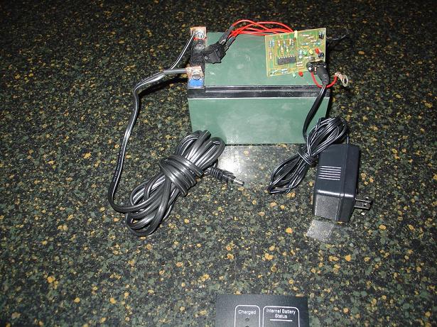

I have modded one of those 12 volt car jumper units which has a sealed lead acid batteries in it... just pulled everything out a resorted it. I plan on putting the charger in a box and then hooking it up to the battery. I can then recharge the battery when ever I need to. It also has an on off switch for the charger and leds for the charge and battery status. I had an old cord that powered from a car plug-in to the same size DC plug that's on the back of the amp... I just cut off the end and soldered some lugs and attached then to the battery. Not very pretty, but works very well. Now I'm portable!

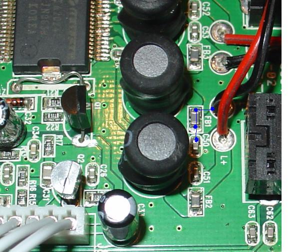

erpiii,
I have been looking at the above photo you posted & using it to get my board "älive" again. Have got the right channel back up but cannot see what I need to re-wire the left channel - connection.
Can you confirm that traces go to L - from FB1 & also from C50 please. This is the most damaged area on the board. Hopefully I can hard wire it & blob it with Epoxy.

ZL2BPS,
Sorry to hear about your mishap! Bad Dog!
I found continuity on both sides of FB1 and on one side of C50 from L-
See the picture for the spots I checked. Maybe the pic will help a bit!
Good luck!
Eddie

erpii.
"See the picture for the spots I checked. Maybe the pic will help a bit!"
Thanks Eddie, your photo confirms my though's on what should be there., once the dog's have gone to bed I will re wire the left channel & give it a whirl. If all is OK & we have liftoff, tomorrow night I will get on with the cap mod's. ( without the dog's helping.. )
Thanks again.

Hard wired from the junction of FB1 & C50 to the L- output & it's going 100%.
For your info J2 connections are from Left to Right,
Red & black, the switched +power lead.
Right Channel Sweeper.
Common Ground left & right.
Left Sweeper.
Left Input.
Right input.
( the last 2 not being used when you use RCA's as you wire directly to the pot. )
Still have to work out the Headphone plug connections.

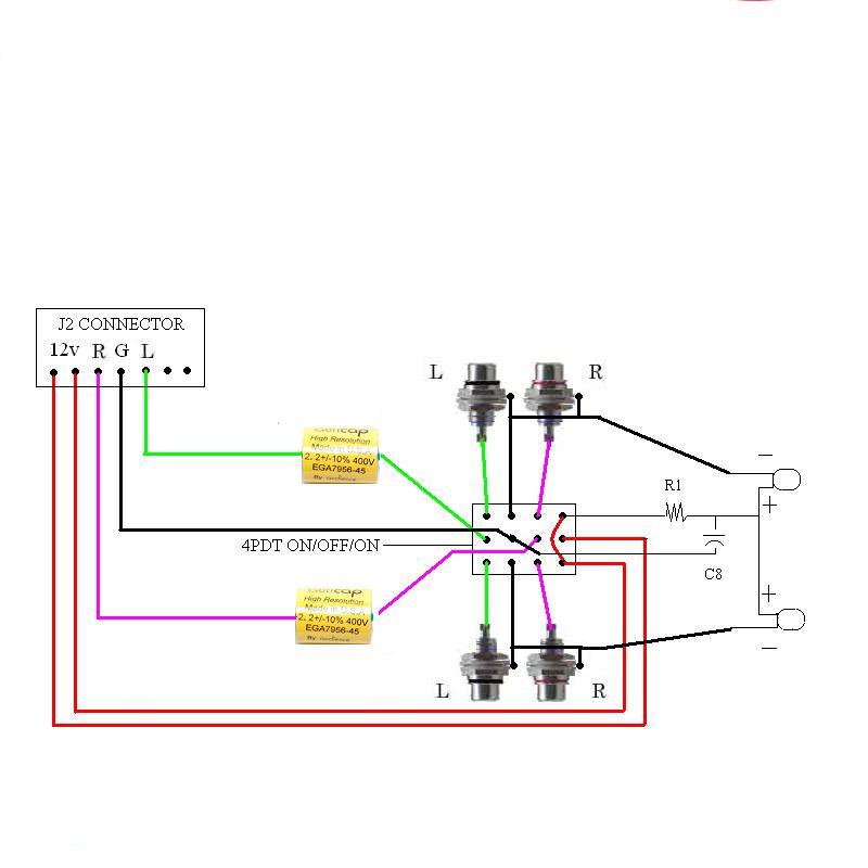

Hi everyone!
This is my plan for having 2 inputs using a 4PDT switch. The switch also functions as on/off and will light one of the two led's, depending on the source side of the switch. I'm just going to use the pcb for the led circuit and as a mounting platform for the led's. I Don't know if I've done this right or not... it looks logical to me. If anyone should see anything wrong please lemme know.
I have also bypassed the pot all together. My source (iPod) will be the volume control, as the levels I listen at are around mid volume on the iPod; my speakers being pretty efficient.

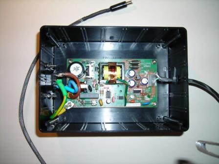

Just got a Skynet SNP-9037
I recently purchased a Skynet SNP-9037 SMPS for my SI Gen 2 T-amp and installed it in a Radio Shack ABS case. The DC cable is a twisted pair of 18 AWG Teflon-insulated Silver-plated OFC with a TechFlex sleeve and terminated with a Switchcraft 2.1mm DC power connector. I will do some critical listening comparing this new SMPS and the stock SMPS.

I bought the Skynet SNP-9037 for $28 direct from American Skynet's operations in the San Franicsco Bay Area. Since I stopped by their offices and picked it up, I saved on shipping. It's a 12VDC/2.5A SMPS, and so far, it has made an improvement over the stock SI Gen 2 PSU. I really noticed the difference when I switched back to the stock PSU. The Skynet is cleaner and definitely smoother on peaks. When I checked the output, it consistenly locked in at 11.96VDC. The stock unit actually fluctuated at 12.10 +/- .25VDC.
I opted for a switch mode power supply over an SLA battery based on listening to a Red Wine Audio Reference 30 (Series 1) and some Zu Druids at RMAF 2006. It seemed like the amp would run out of headroom on peak transients. It didn't have that somewhat warm Tripath sound. Also, Michael Mardis has recommended this same SMPS.

Your Circuit looks OK & whilst I realise SI do it that way, I would not tie the diode - line to the signal - line. I would take the - line back to the input plug.
My understanding is that diodes introduce a degree of noise but am not sure regarding led's. Perhaps someone more technical can comment.

Refer to this data sheet for the connections:
http://www.skynetusa.com/images/stories/Series_Spec/snp-903%20series.pdf
I soldered the wires for the AC and the output connections to the board connectors. For mechanical integrity in the board AC connections, I snipped off spades from some insulated crimp lugs and crimped the lug over the soldered connection. It's not the most elegant solution, but it worked for me. You can do this at your own risk.
I did something similar at the outputs.
