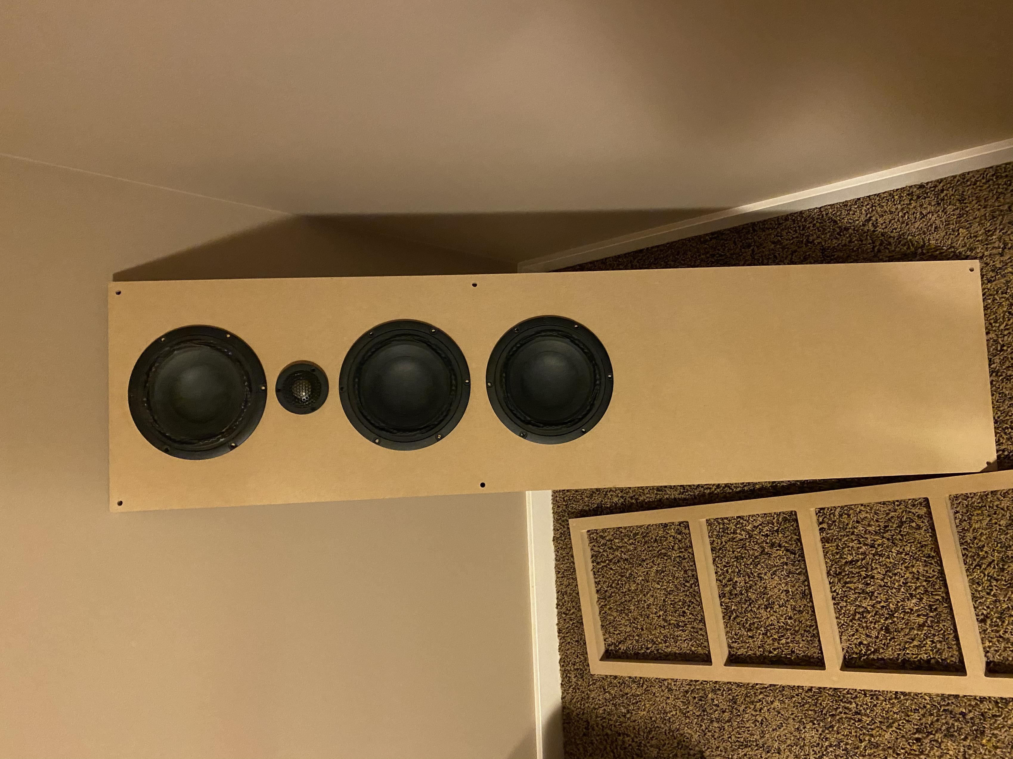

Yes I know it’s not for everyone. I just figured someone would have attempted an all out assault with these drivers by now. Maybe someone has. I just haven’t seen it yet.
Something I’ve been fooling around with.

I’ve seen a few twin woofer speakers. But not active twin woofers in a small sealed with Linkwitz transform. My project is an in-wall, so I get a free 6dB of boost in the low end as well.
But with the upcoming 8” Purifi and Bliesma mid, I’ll be replacing the Purifi for the mid role, and dual 6.5’s will just be a system for smaller 2 channel rooms.
My flagship setup will have 4x Purifi 8’s, and probably will go with an MTM with the Bliesma 3” mids and T34 tweeter. All fully active, and sealed. Just so I’m not working the bag off the Bliesma under high SPL conditions.

I go with sealed regardless of in wall or not. The only drawback with an active sealed is you don’t get the free non-linear boost at the port or PR tuning frequency. But if you can’t get the SPL’s you’re looking for, just add more woofers and more power. Nothing sounds better than a sealed cabinet. More room friendly as well.
Actually I’m helping a friend tune up a 4x 6.5” Purifi woofer sealed, active speaker next week. Using my amps to drive them.
