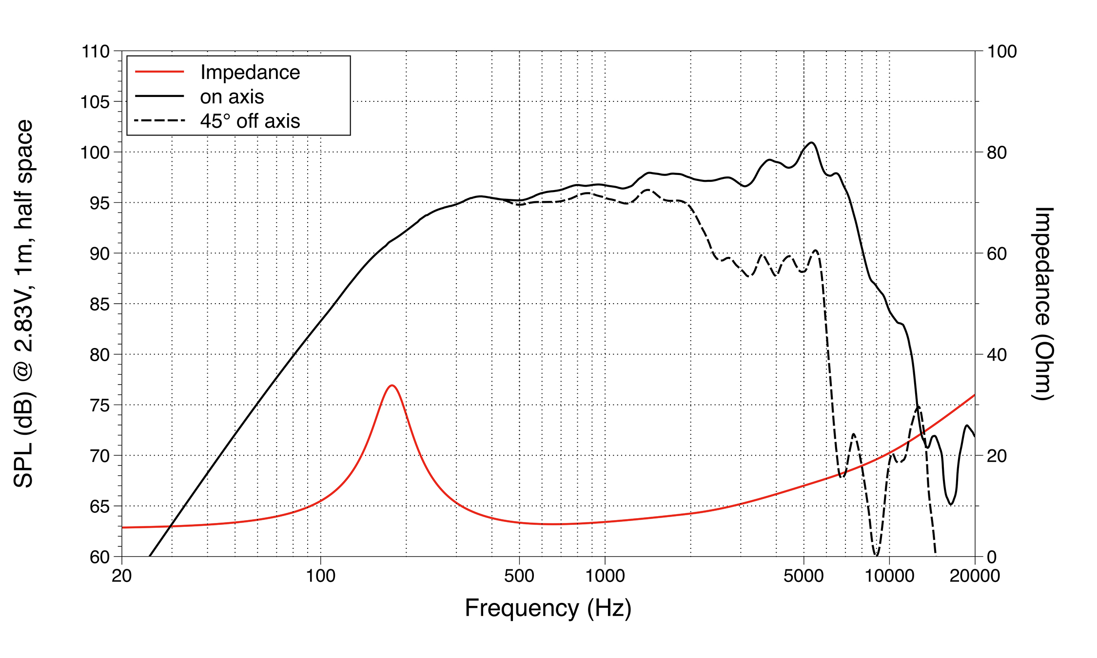

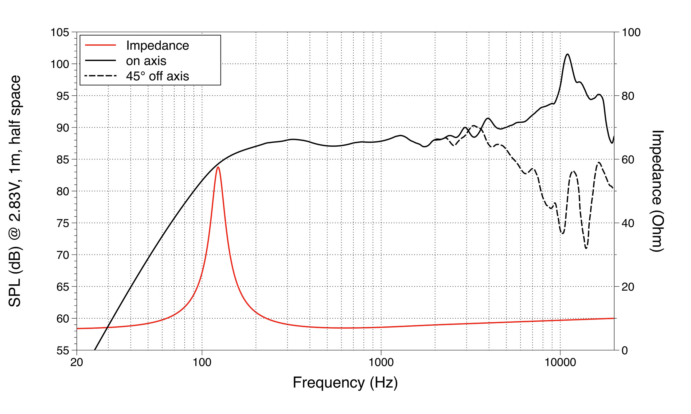

Looks like a decent 4”
http://www.lavocespeakers.com/lavoc...548144289_LAVOCE_WSN041.00_4in_WOOFER_C.a.pdf
LaVoce looks interesting, not all of their drivers, but they have a gang that could fit the home HiFi setup.
Not to be critical, but it seems an interesting design choice to me to add a neo magnet to a driver with a stamped frame.
LOL... maybe a tad schizophrenic or they ran out of development funds 😀Not to be critical, but it seems an interesting design choice to me to add a neo magnet to a driver with a stamped frame.
Look at the Le of this FR 3". Rms is 0.288kg/s - Max SPL should be around 118dB if I'm not misstaken

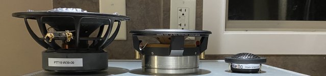

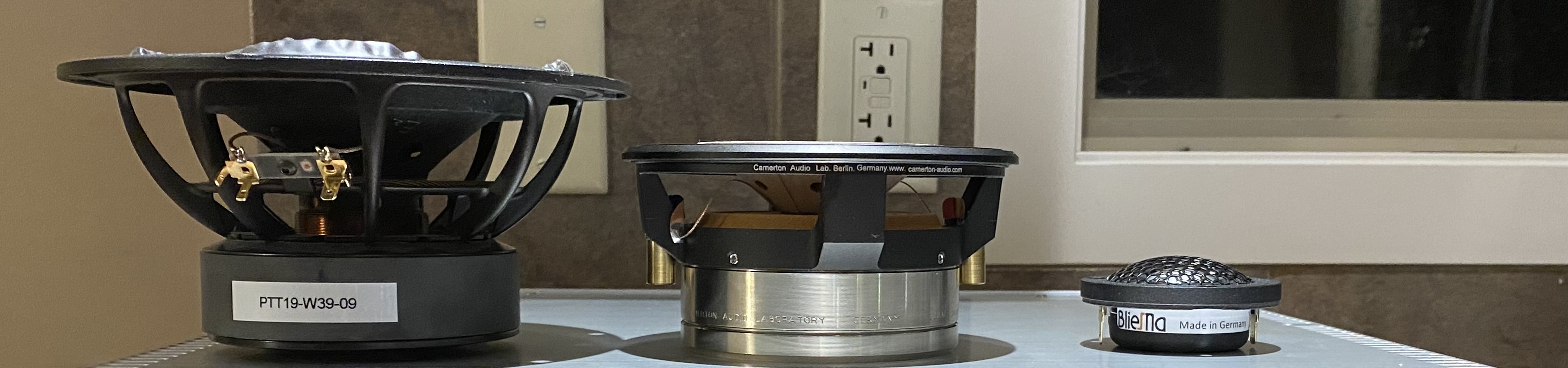

All interesting, but I don’t use budget drivers personally. Only interested in the best of the best. Purifi, Bliesma, and BMS cover all my requirements for the time being.
I think I mentioned it before, the Elipticor is probably the lowest distortion woofers currently available with Purifi at their heals at more than 50% less. I don't think a human can hear the differences, but we can see them via our screen.
Tweeters and small midranges looks to be completely owned by Stanislav at BlieSMa and BMS looks to be a very good choice for large woofers.
The Purifi’s have a beefy 4 layer voice coil, and more volume displacement. You can put the Purifi’s in a small sealed box, and with linkwitz transform can get them -3dB @30hz. And lay the power to them without worrying about burning the voice coil. And they sound best this way. This is the true intention of the design. Not for a ported cabinet. Or even passive radiator. This is why it shocks me nobody is doing this.
Well, for one, Linkwitz transform is relatively unknown and does not suit all drivers, but would be nice if the driver handled it. Maybe I should revisit that circuit - thanks for the reminder 🙂
You need to go active to do it. For passive speakers it’s not possible to get the best from the Purifi’s

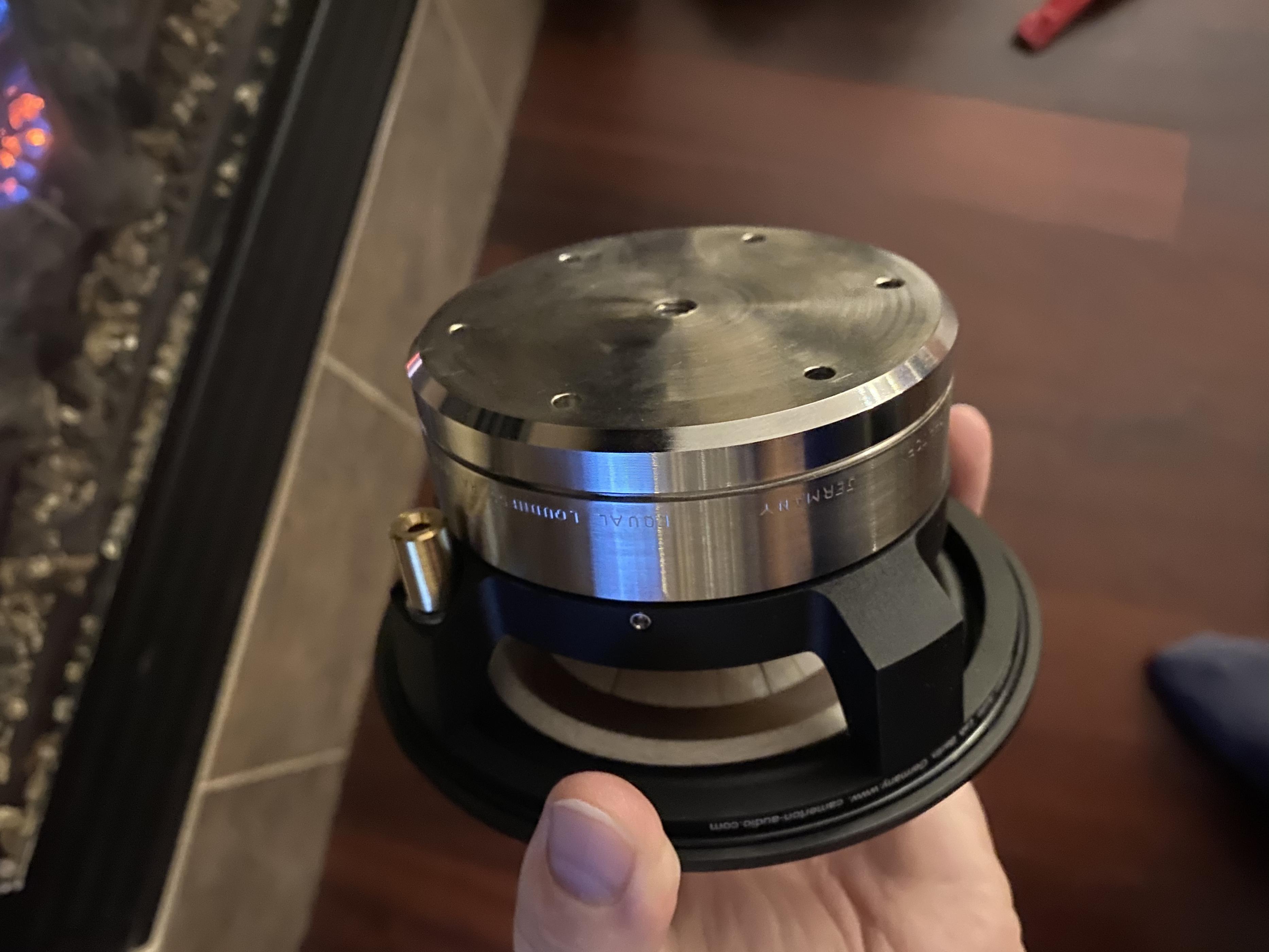

Interesting full range project I’m working on.
http://camerton-audio.com/wp-content/uploads/2021/06/Binom_A2_specifications.pdf
