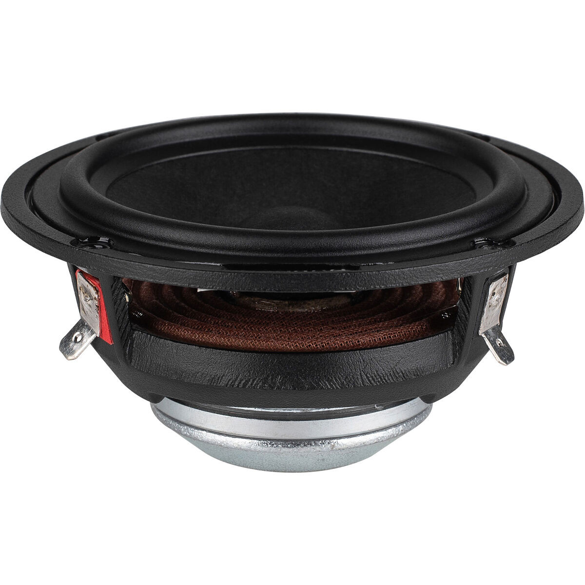

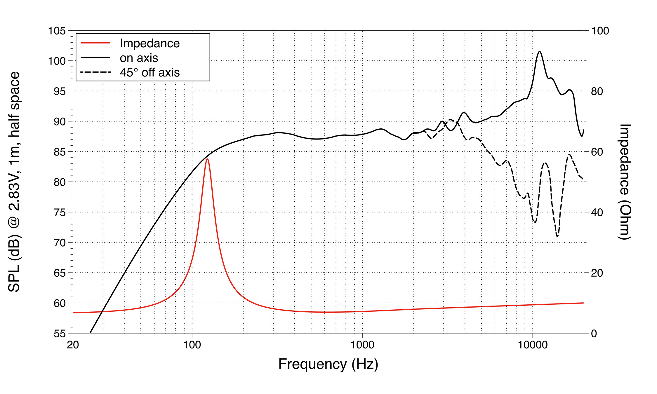

LaVoce FAN30.71 fullrange driver. 3" paper cone, neodym magnet, Le is only 0.05mH, Cms is 0.9mm/N, Mms is 1.8g, sensitivity of 89.5dB, Fr range is 120hHz-3kHz and Rms is 0.288kg/s (excellent Rms)
There is currently no independent measurement available for this driver, but I might do one at a later stage.

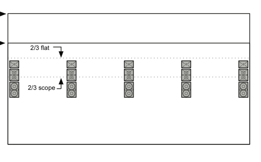

Yeah for my front mains, left and right centres, and centre, I’ll use 4x 8” Purifi woofers crossed over the the Bliesma mids. 20x Purifi 8’s should cover the front wall nicely. And 4-8 BMS 15N18V2’s for the sub channels.

Interesting driver and the price is right at USD$29, but 2mm xmax and 30W power handling will certainly go up in smoke for Amplifier dude's requirements

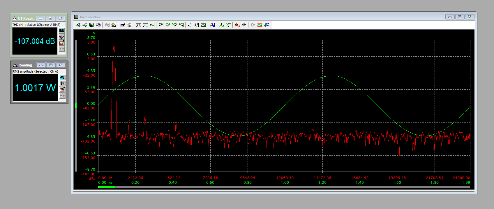

I make my own DSP amps already. Shared the THD+N a few posts back. They use Ravenna AES67 audio over IP so unlimited units can be clock synced. Each one has 4 channels of DSP, and 3 Purifi 1ET400A modules inside, and an XLR sub out. So good for a 3 way and sub each. Finally got Trinnov and Storm Audio on board with the Ravenna. So with their 32 channel processors combined with my DSP amps up to 128 drivers can be actively driven in a single home theatre. With audio quality on par with the best of the best 2 channel dac’s and amps to each driver. The amps build into the wall and have fibre optic Ethernet inputs. So there’s very short speaker wire runs to the drivers.
