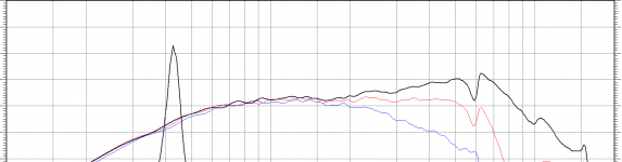

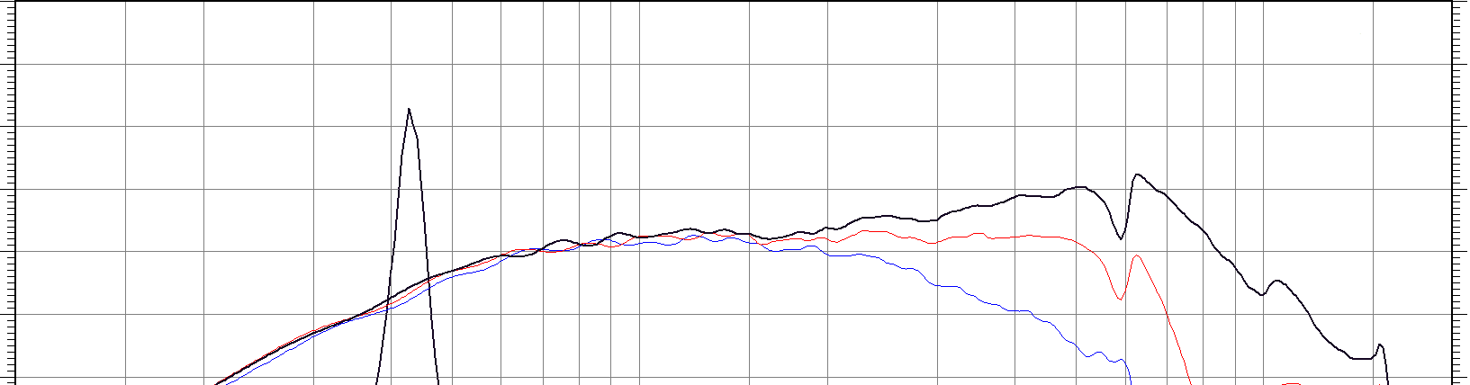

What am I looking for in these two graphs?
Whatever you want. Just a comparison of an alternate to the Bliesma. A bit higher extension, but can’t go as low.

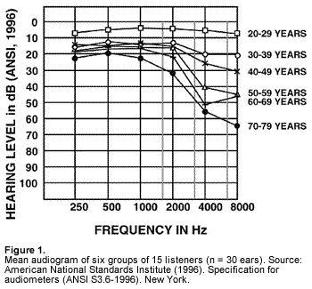

By age 50 the average hearing is 40db down by 5khz.
These graphs also show something much more important.
It's about the relative attenuation of higher frequencies, compared to the lower frequencies.
Not about the idea that people above a certain age can't hear any higher frequencies anymore.
What it shows us is it’s more important to focus on the best results in the range that we hear best. What it doesn’t show us is most instruments as well as the human voice is in the most sensitive area of human hearing as well. So ideally if we can get away with not crossing over in the sensitive range, it’s ideal. And this Bliesma mid allows us to do so without real world compromises.
The M74S have the lowest cone distortion/breakup of of the bunch (BlieSMa)Bliesma T74B vs Accuton C50

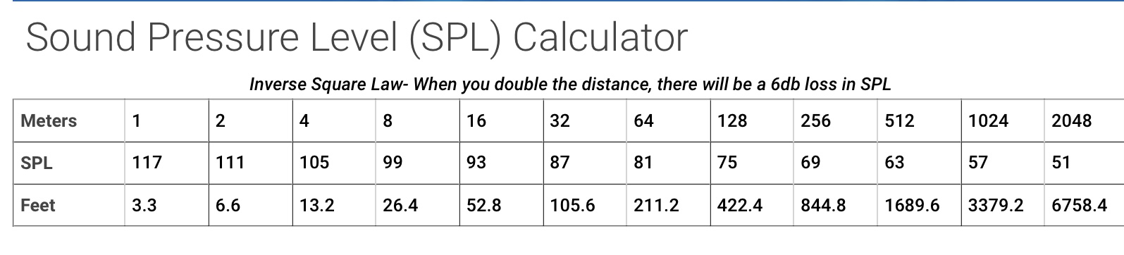

Yes it’s an amazing driver. And it’s going to be my go to driver in high end immersive sound theatre installs. Hoping it can handle 117db/1m with a 4th order at 600hz. This will allow for the Atmos standard of 105dB at the listening position up to 4m from the front mains.

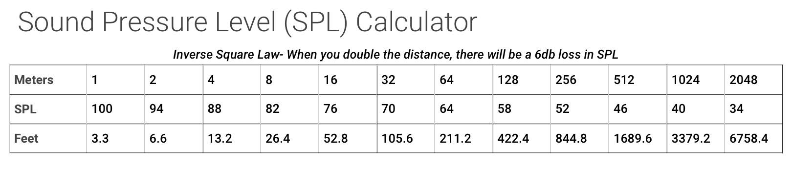

I loved the idea of the 4” Purifi woofer. But it maxes out at 102dB from 1m away. Great for use in a camper or motor home. I’d use it there.
ScanSpeak 15M/4624G00 with its 93.9 dB(2.83V/1m) should be able to do 108dB.

Personally I need at least 116dB/1m continuous from a mid for my applications. The Radian Beryllium compression has no issue with it. But hoping I can get that out of the Bliesma.
