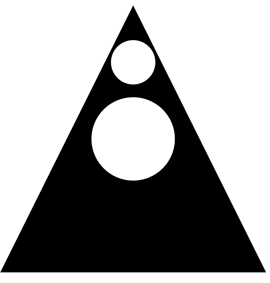

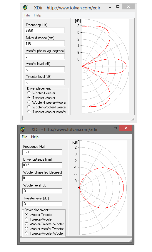

I am trying to shoot for 1.2 X c-c spacing for the XO. I came up with the drivers 18mm apart and an XO at 3650hz for the t25 + m74.
I attached a comparison to my other 3way. They look so different and I wonder what I can hear.
I have not simulated anything in vcad yet. Waiting for better data to know where I can place what. (thanks x1,000,000 hificompass!) The baffle shape might be a triangle. Ah, it will be so nice to give zero ***** what is happening behind the baffle. No box. No stuffing. Ahhh.
