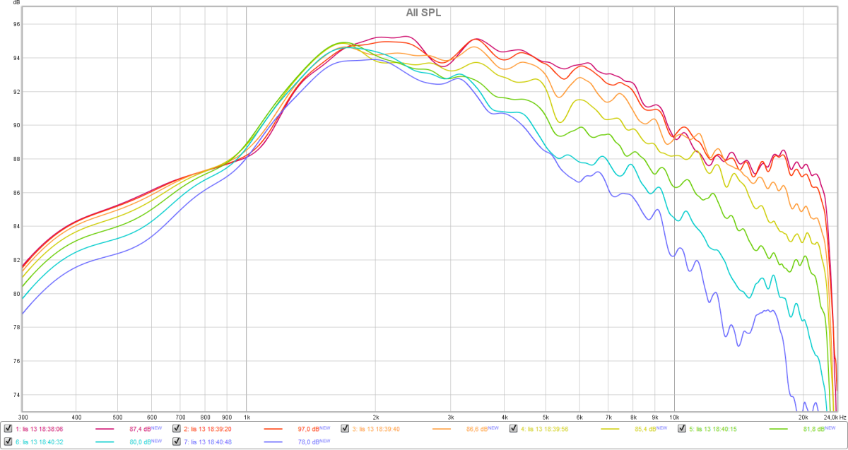

HiFiCompass: I hope you won't mind if I add DXT off axis measurement. Measured in 200mm wide baffle with faceted edges.
Thank you for an update, very nice curves really!HiFiCompass: I hope you won't mind if I add DXT off axis measurement. Measured in 200mm wide baffle with faceted edges.

Slightly dissappointing performance especially in HD area. Slightly abnormal axial response in comparison to a bunch of other DXT tweeters I had an occassion to measure in the past. Weird behaviour at 20 kHz rather not typical to them. Probably they are running into consistency issues with latest drive units? Pida's DXT unit from earlier post is more typical.

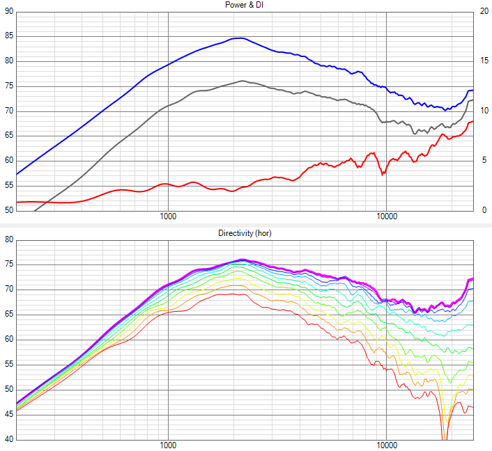

Paul, it is good to see that my baffle did not make the performance much worse. The main difference I see is in directivity. My baffle keeps wider dispersion to higher frequencies.
Pida, on the contrary, w.r.t. directivity it is even better with the baffle, keeping the directivity more constant down to below 2kHz.
I just wanted to say that the directivity response can be improved choosing the right cabinet dimensions and shape.

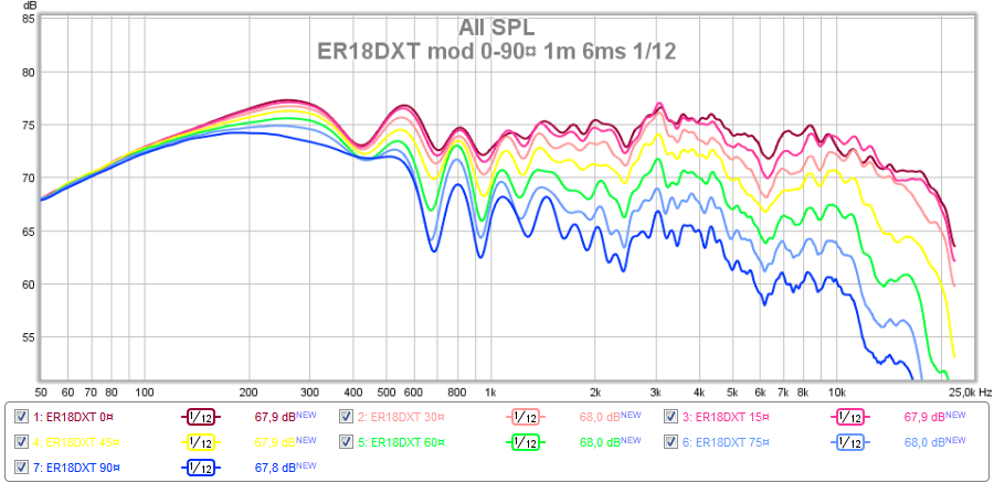

Here is my MarkK's ER18DXT speaker, both drivers with xo. My box is not exactly by his plans, it has offset tweeter and bevels on sides. My measurement doesn't show the cone breakup frequency at all. I should have changed the serial cap value for the tweeter.
DXT is a quite nice tweeter, but wg is actually very minimal so it works actually only from 3kHz up. Best match with 4-5" midranges!

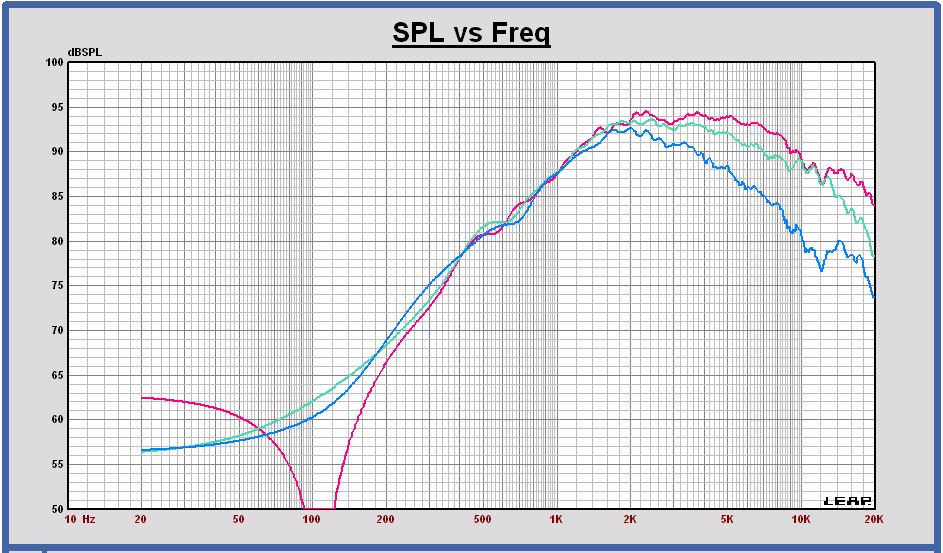

DXT tweeter on Grimm LS1 baffle in 10-degree increments.
2.83 Vrms @ 1 m distance, unsmoothed, 3.0 ms rectanguar gate, valid down to ca 1000 Hz.
There is diffranction on woofer suspension clearly visible at 2.8 kHz.
