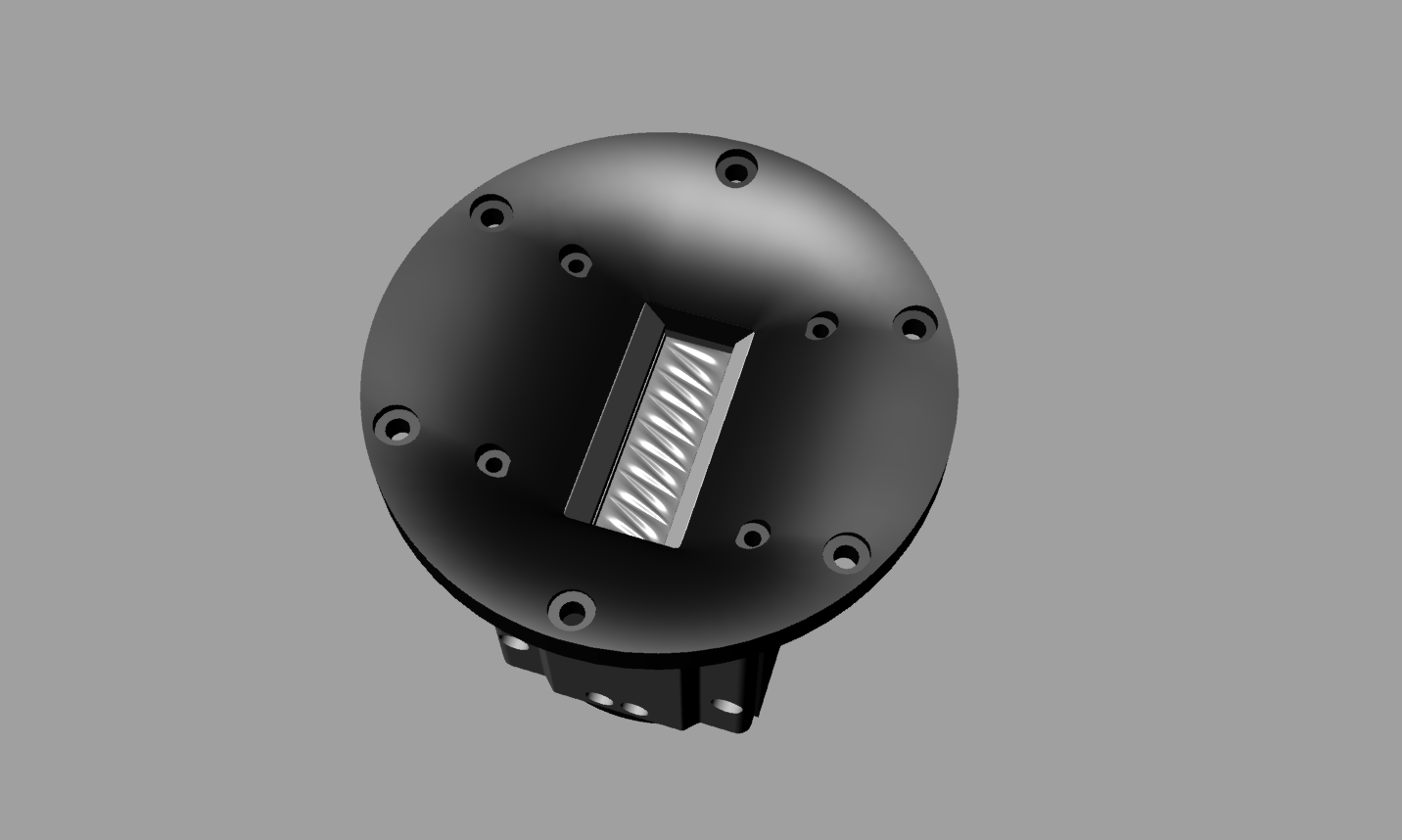

Your GRT-145 looks "ripe" for a larger waveguide/horn - with good extension and resulting higher efficiency, and very low resulting distortion. ..at that point you would seriously have to ask what a good treble compression driver was needed for. Hint.. Hint.. -this niche needs filling! 😉
Thanks!
Yes, of course, this issue deserves attention.
For starters, we are launching a shallow waveguide (like the RT850). The main task of this waveguide is the correction of the radiation diagram. It has a slight gain in the middle frequency region - only 3 dB.
There are thoughts about the development of a horn. But this task is in the more distant plans.
