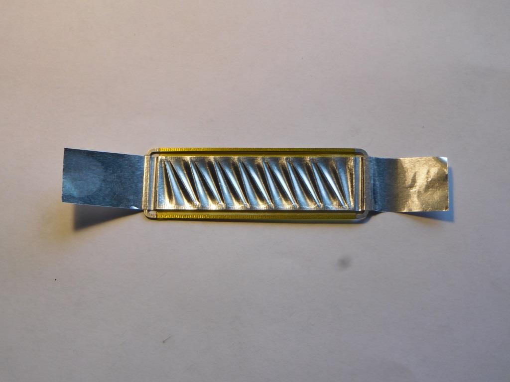

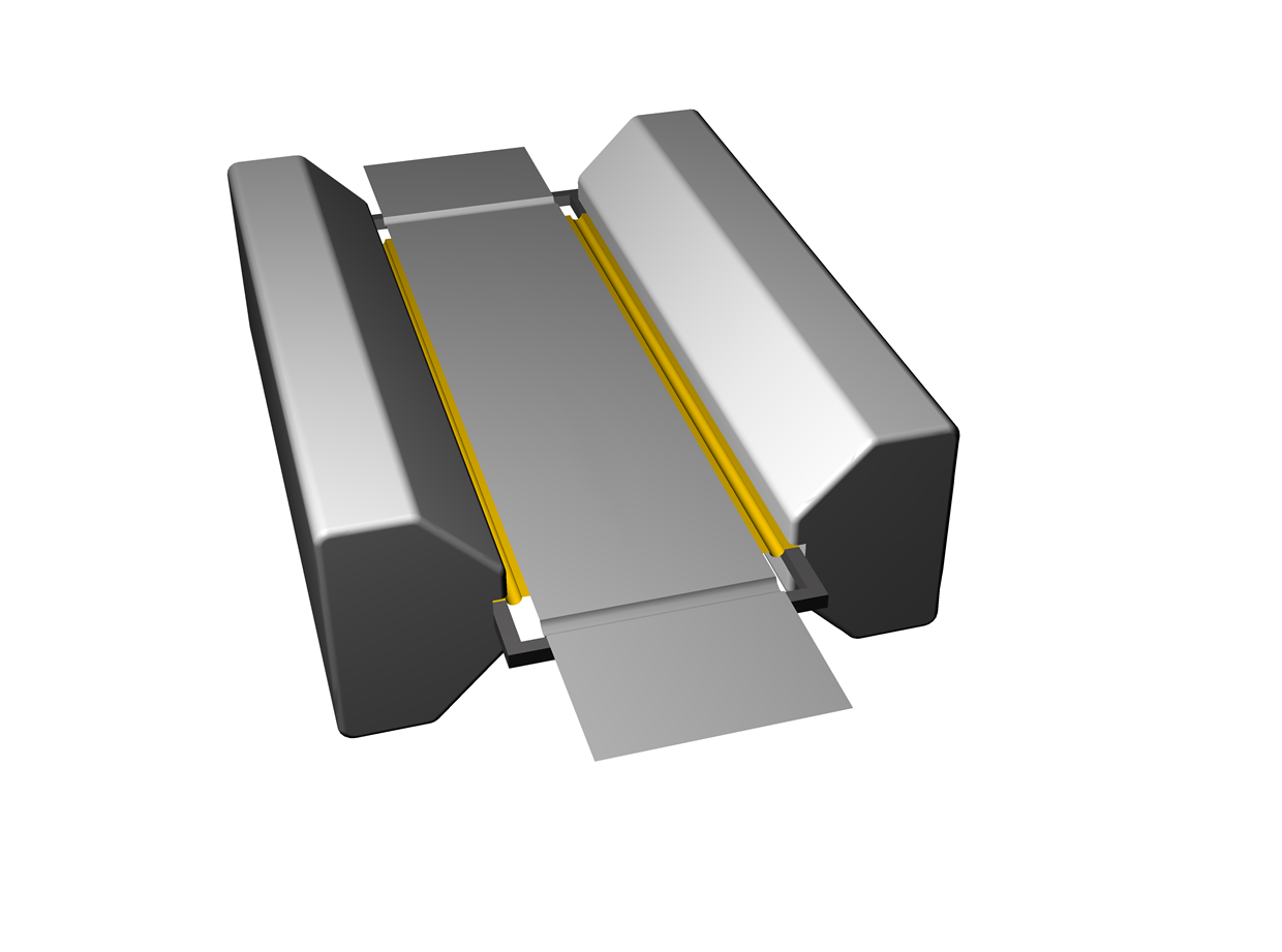

Now the GRT145.. that's interesting, but then so is at least one of the Chinese tweeters I linked to. (..and they have very similar construction.)
GRT-145 is a real ribbon tweeter.
Here is a photo of a ribbon cartridge. In this tweeter, the ribbon is the radiator and conductor at the same time, as in the classical ribbon.
OK, so suspension is similar, yet the Chinese design is more like a "direct radiator", and the GRT-145 is a ribbon.
It explains the differences in efficiency and the higher spl with the rising frequency.
Your GRT-145 looks "ripe" for a larger waveguide/horn - with good extension and resulting higher efficiency, and very low resulting distortion. ..at that point you would seriously have to ask what a good treble compression driver was needed for. Hint.. Hint.. -this niche needs filling! 😉
