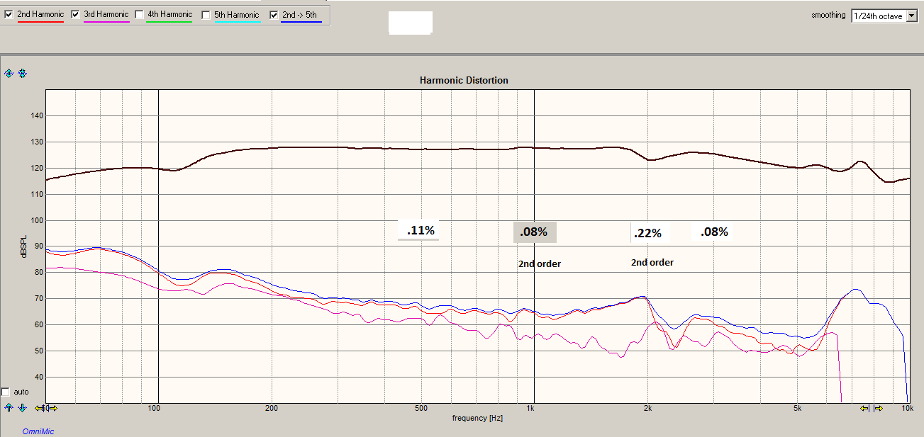

I did a 4 inch midrange "shootout" a few years ago, and for my mid-priced stocks, the Vifa NE123W had the smoothest FR and lowest distortion of 6 different models.
Of course my measurements are not up to your standards, but they proved useful for my purposes.
