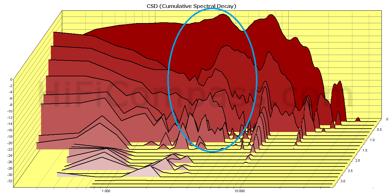

There is that thing going on above 2kHz, and can be seen in waterfall. Instead of having gradual fall without abrupt changes, it has this:
What's visible at waterfall under 1000Hz could very well be a measurement artifact. To be sure what you see is real, much longer gating should be used and/or observed peculiarity on impedance plot. There is some mild hill at that frequency at impedance plot so maybe it is resonance.

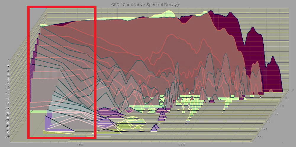

Just to find something to put in the "Plus" column... I think the 3-212 looks better when it comes to the decay after 1ms and between 300hz and 1000hz. The attached image has the inverted 3-212 on top of the 10f graph. Black lines = 10f , Pink lines = 3-212. The scales do not match. The eton's scale is -2db different at the top and -4db quieter by the time you get to the bottom of the scale. You can see that the black lines stay above the pink after 1ms in my red zone. This graph is telling me that the 10f rings between 300hz-1000hz more than the 3-212. Does 1ms extra decay and +10db of extra ringing mean anything? I dunno. I will probably buy a 10f to compare.
