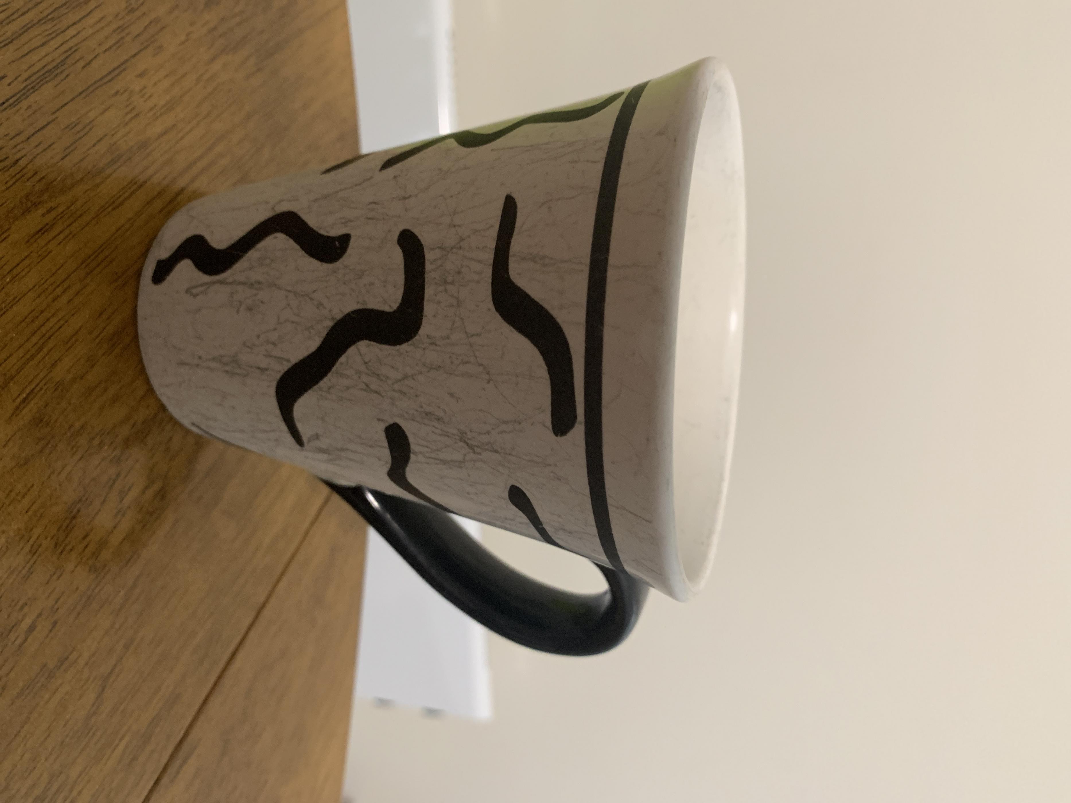

There’s a no screw/faceplate version ( D7608/920000 ) that’s 113mm wide that one could use with a 250mL ceramic cup; heavily stuffed with sheep’s wool that would probably extend the bottom end a hundred hertz or so.

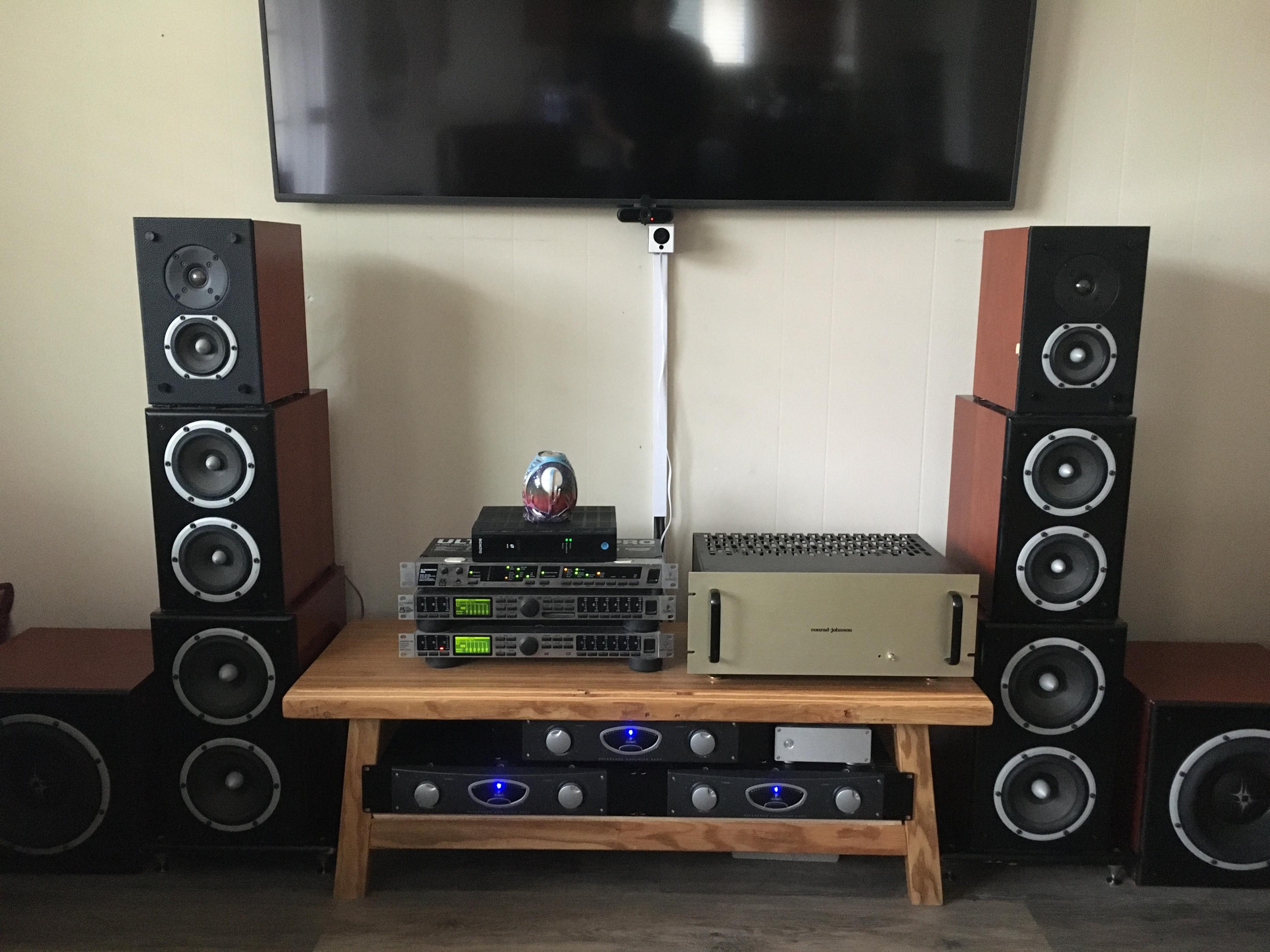

Yep. As you can see, when they all went on sale before being discontinued(HDS Exclusives) I couldn’t pass it up🙂
I do want to thank Zaph for doing the tests on most of these drivers. I was like a kid in a candy store when they went on sale. The subs are actually from the XXLS line, but had the same cosmetics The tweeters are HDS/ Scan-Speak

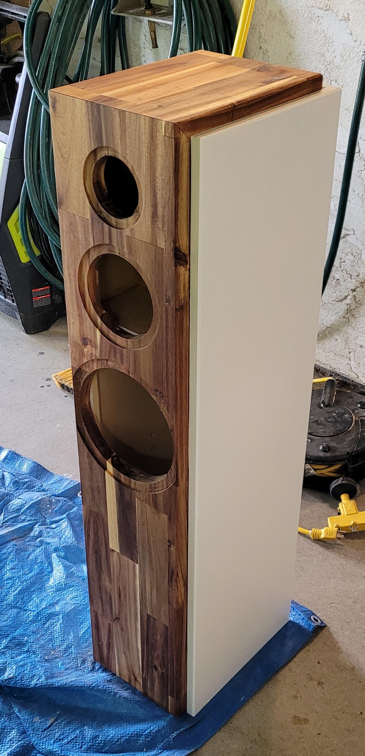

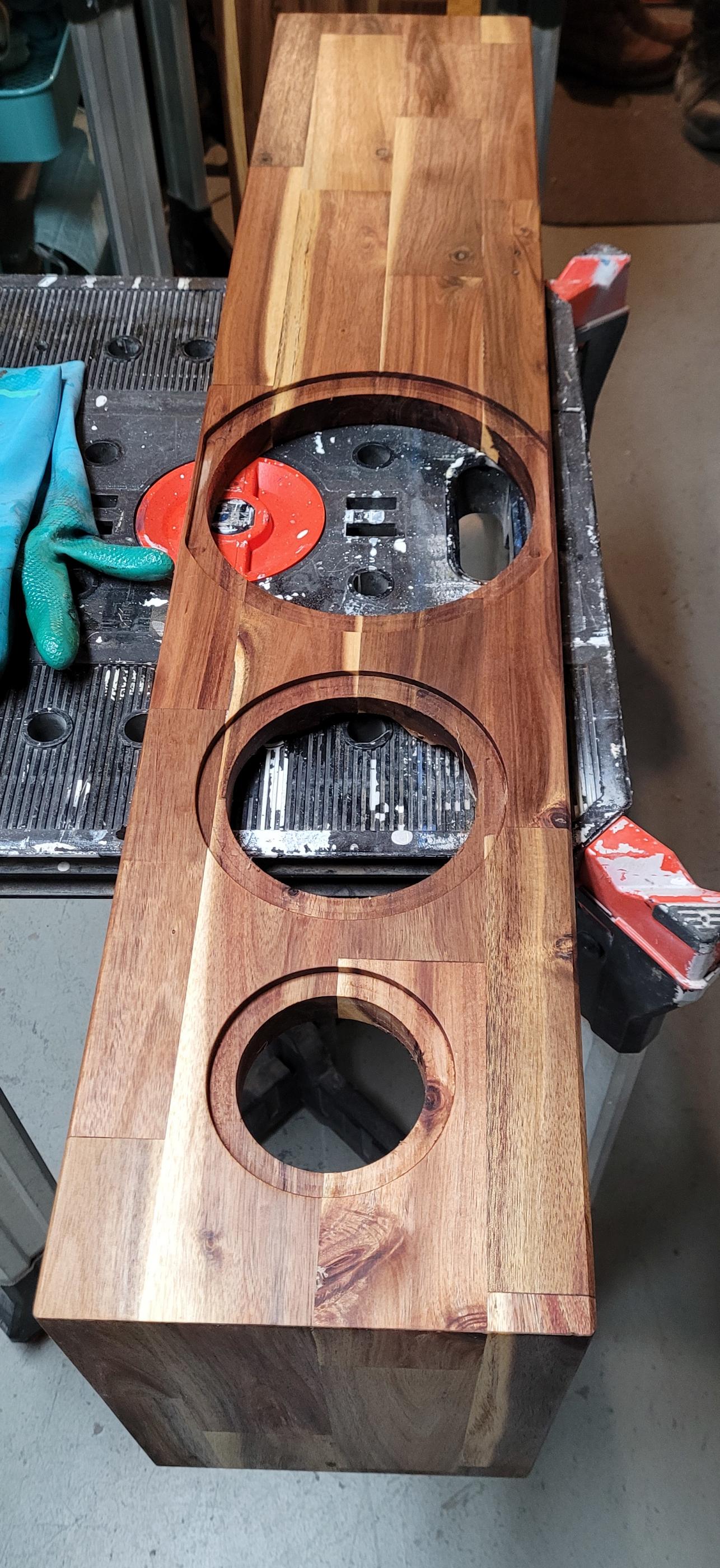

Some 10+ years ago when I decided I knew enough to competently design my own speaker and crossover, I designed a 2-way using the 8" 830884 woofer and the HDS 810921 tweeter. At that time the HDS tweeter was a new product that tested extraordinarily well by Zaph. Today it is still one of my favourite dome tweeters. The speaker performed rather well, and I enjoyed it for years and used is as a point of reference for listening comparison of my following builds. However, my woodworking skills were not great and the finish of the speaker wasn't great either (acrylic wall paint with a "crackle" texture).
Fast forward to today and it wasn't that long ago that I found a pair of the 5" 810882 midwoofers for sale, so I decided I would rebuild my old 2-way speaker as a 3-way. To keep something original I am modifying the existing cabinet to fit a new baffle and base, and keeping with the original style I am even painting the cabinet with acrylic wall paint, but the baffle and base are a nice acacia countertop boards finished with Tung oil.
Some photos of the original speaker progress of the redesign, I am just starting to finish the wood and priming the cabinets, so probably 2 weeks away from taking measurements for design.
