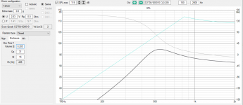

D2708 may be rather useful after all, keep in mind when comparing that it includes no chamber, only a thin felt as dust protector where most other dome midrange I see include a chamber from factory which doesn't provide a real apples to apples comparison on the frequency response. The D2708 also has rather high Qts, so a small sealed chamber will provide a fair bit of lift to the response to make it more comparable to other dome midrange drivers.
I wonder what impact putting it in a suitable sealed chamber would have on the < 1kHz distortion. It might also be fun to see what an appropriately designed TL would do for it.
