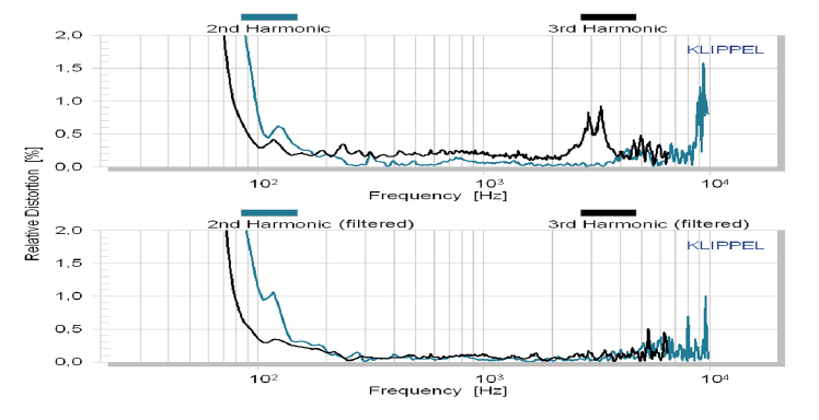

Thanks for the response. The series notch could definitely flatten out the peak in terms of the frequency response, but are you saying that the notch can actually reduce the amplified subharmonic distortion (e.g. H5 from 600-1500 Hz in the W22EX) as measured with a sine sweep? How is that possible when the notch has no acoustic effect on the driver's self-generated distortion?
Yes, of course. The notch can down 3rd and 5th HD peaks corresponding to the breakup resonance as much as the peak is attenuated. This distortion is born in a speaker's motor and manifests itself as a distortion voltage source in the voice coil circuit. This voltage source creates the voice coil current, which drives the voice coil and is subjected to the resonance amplification by the cone at the breakup frequency. You need to break circuit for voice coil curent at breakup frequency by adding hi-impedance notch in series with the voice coil. It really works.

For the sake of interest, here are a couple of examples from an old Accuton pdf where they do just that:
