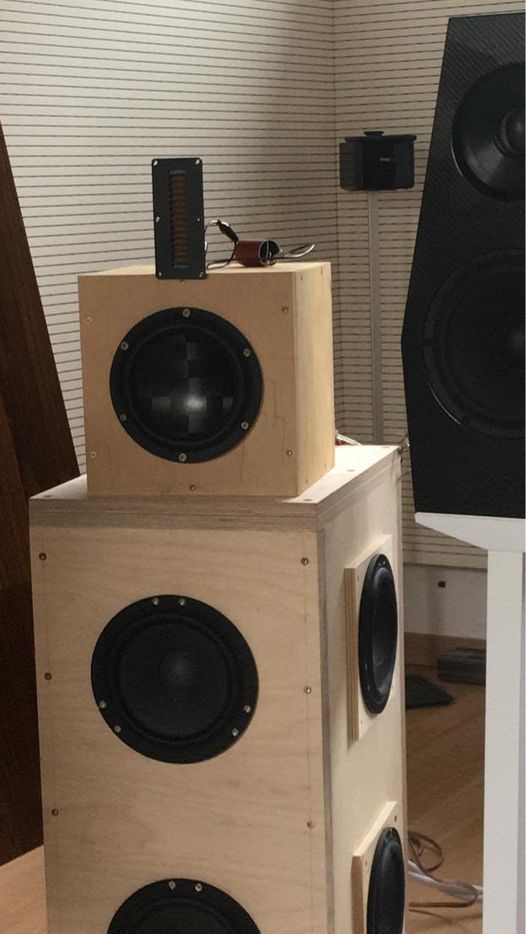

Ms Rainer Weber (from Kaiser Acoustics) received the SBA MW16TX and auditioned it today with the following comment(s)
So I asked if it was on par or better than Accuton Ceramic and he replied withThe long waiting seems to be highly rewarded. Extreme clarity and speed and no harshness
in my opinion better
Now I am finishing its review...
Oh okay. Will be an interesting read 😀Now I am finishing its review...
