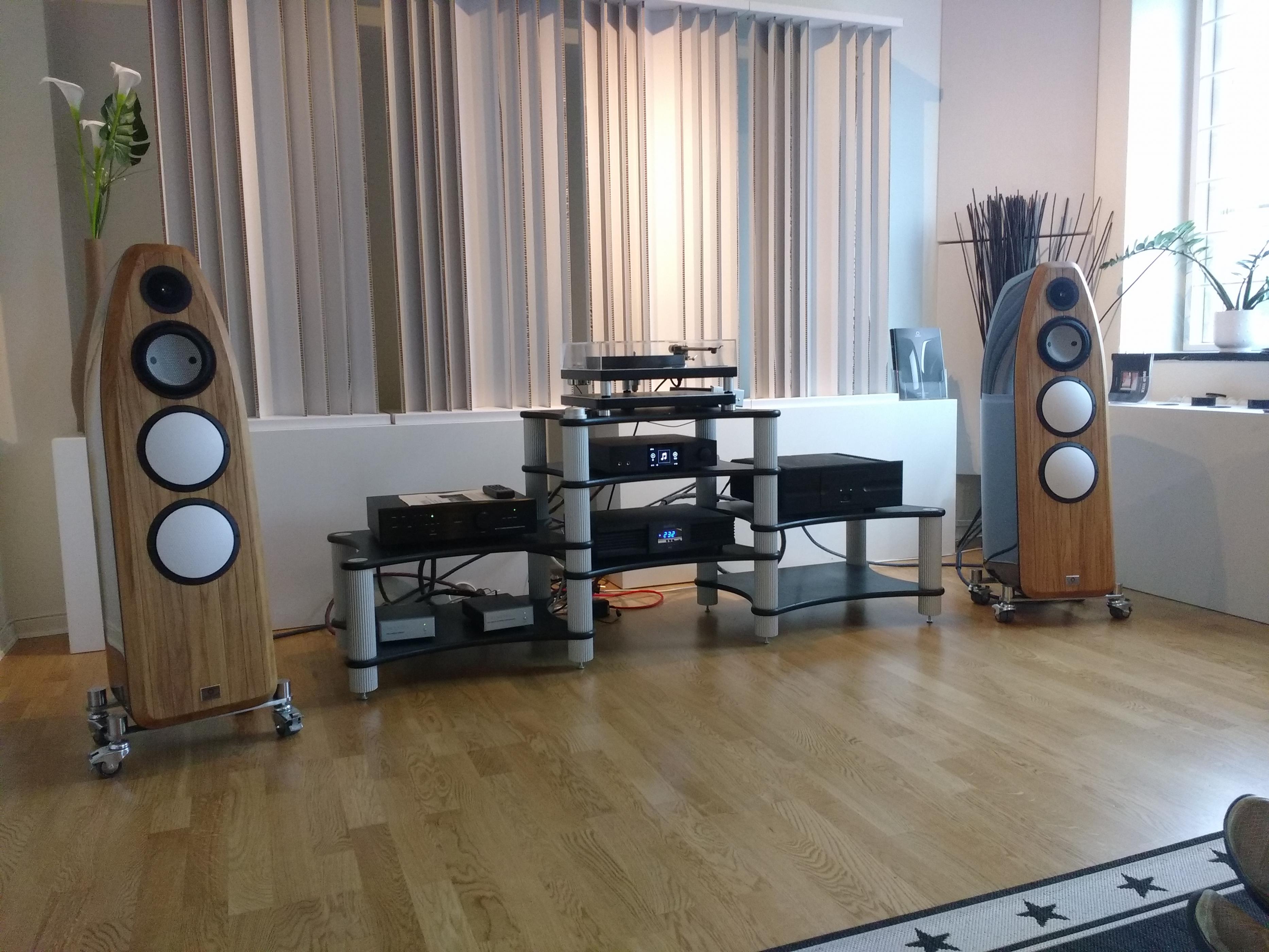

I was listening to the Marten Coltrane Tenor which uses the older BD 20-6-031 and it was fatiguing, so I can't say anything about the BD25 - but no matter, I found the C25-6-158 CELL was better than the BD20-6-031.
