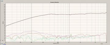

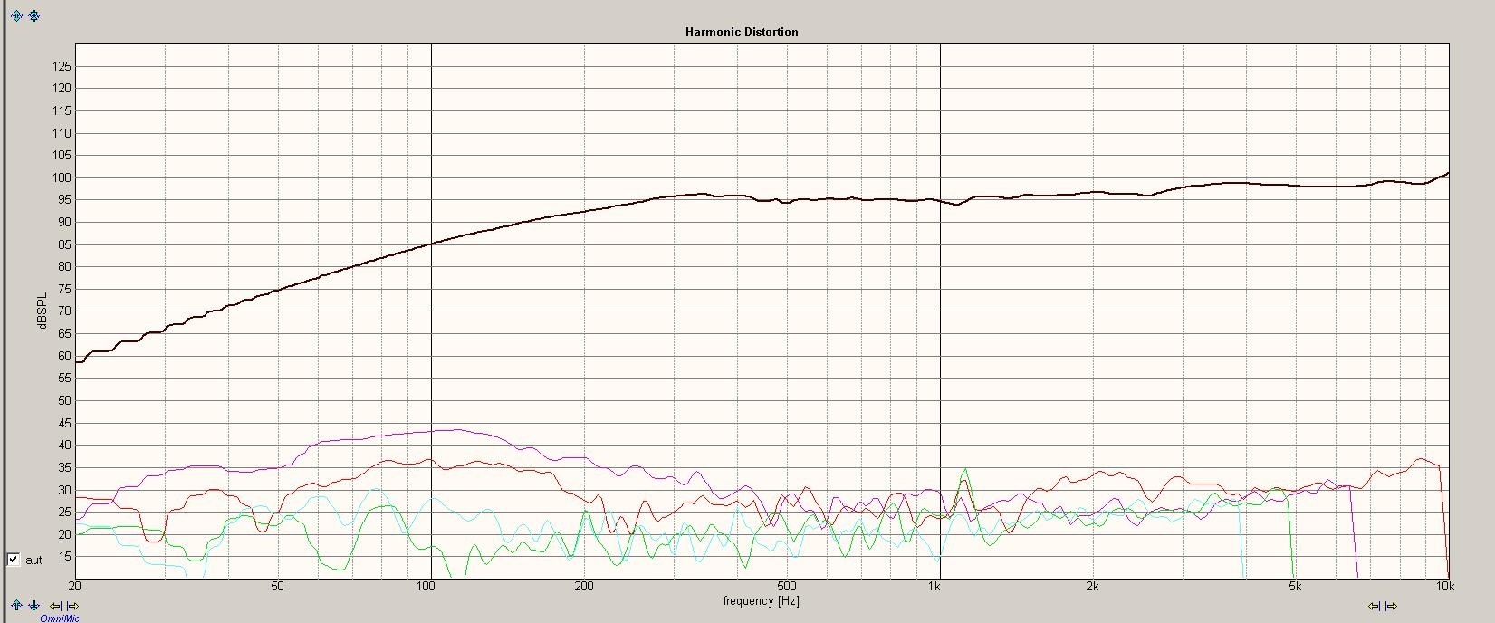

The Peerless TC9FD18-08 fullrange speaker measurements:
Peerless TC9FD18-08 | HiFiCompass
Amazing speaker!
Amazing speaker!
Excellent driver for the price indeed ! Very close to the performance of the ScanSpeak 10F while being 8 to 9 times less expensive.
I read your thread about the TC9 based line array. You spent a lot of time and did a huge work, but the reached result is very impressive, really. Take my sincere congratulations![emoji106]I love the TC9, especially in an array 🙂.
Now do the Peerless TG9 with glass fiber cone. That one should be a bit more closer to scanspeak 10f
Fullrange speaker Peerless TG9FD10-04, 4 ohm, 3.3 inch
I'll do, of course, when the opportunity is[emoji846]Now do the Peerless TG9 with glass fiber cone. That one should be a bit more closer to scanspeak 10f
And the SB65WBAC25 pretty please!I'll do, of course, when the opportunity is[emoji846]
The TC9 looks like it might have slightly better distortion performance but at the same time it’s significantly bigger (relatively speaking)
Nice ! I haven't found any measurement of this driver online and personally wished you would measure it someday. I wonder if it will be as good as the SB15 and SB17 as far as distortion is concerned.I don't have them for a while... SB12CACS25 is the next
Any idea what’s going on with the shelf between 200 Hz and ~1200 Hz?I love the TC9, especially in an array 🙂.
One of reasons can be the unsufficient thin measurement baffle (19mm), that can lead to some resonances of air mass restricted between the cone, rear side of the basket and the baffle.Any idea what’s going on with the shelf between 200 Hz and ~1200 Hz?
