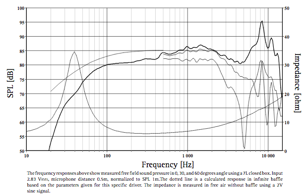

Here's something else one could try:
Since dispersion on almost every driver decreases as frequency rises, it's not a far road to imagine higher frequency resonances would fall off away from the azimuth, for example as with the Seas 15cy001. From the spec sheet we see the on-axis peak is about 10 dB above the midband response, whereas it's at the same level 30 degrees off axis.

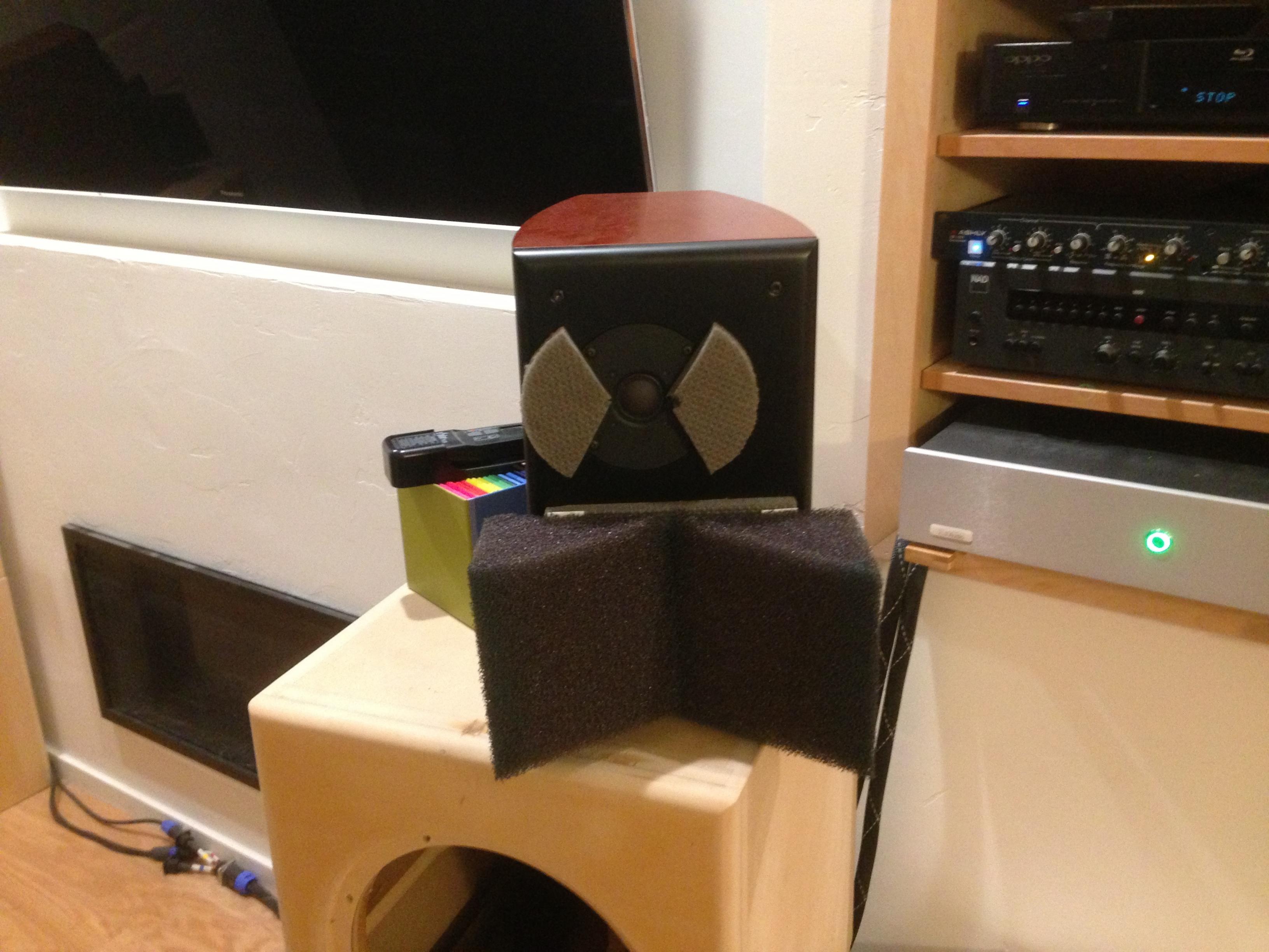

Now we could try increasing the dispersion above the midband with an acoustic lens such as the arrangement here, where the foam pieces act as a divergent lens mostly above 2 kHz. An entirely unscientific no-blind listening test hints at slightly smoother upper mids on Dayton RS150s, so once I clear away the rubble my next homework is getting distortion charts with & without lenses.
If someone wants to try experimenting with the same foam, I used this. It's originally intended for keeping leaves from gutters, featuring open-cell construction to keep water draining through it. Reviews for that function aren't great, but it seems to work a treat for audio! In North America Ace Hardware has some in stock.
If the distortion products are going to be out of passband, you can just cover the whole driver with (thin) absorber. That is, if you have access to DSP, as your name suggests, to EQ any possible attenuation at the upper end of driver passband.
You could do that. The difference between top of passband and resonance peak is typically less than two octaves, however, so the cover would need careful designing so it doesn't screw up the passband since the driver shouldn't be equalised too hard lest distortion products rise and then you're right back where you started.
Absorbing material tends to be denser than open cell foam, too, so one must take care to avoid setting up a resonant chamber between the cone and the absorber. Guess how I know that one? :p

... so you're more on absorber around than in front of the cone ? a foam round pad in front of the dust cap is attracting me... staying in place with wires tied on the screws of the driver basket !
