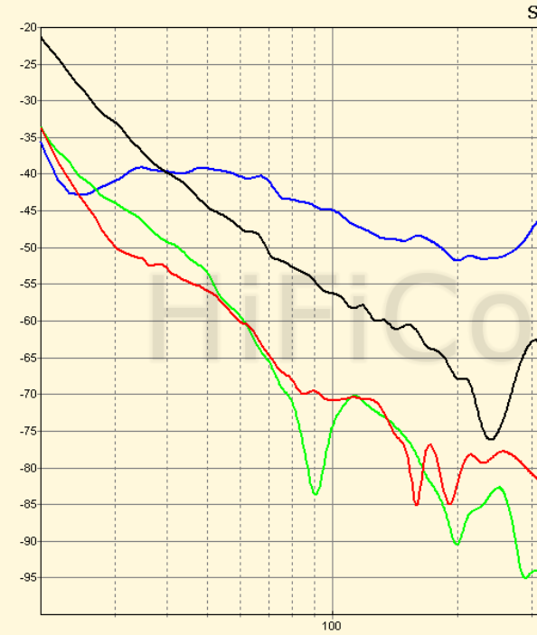

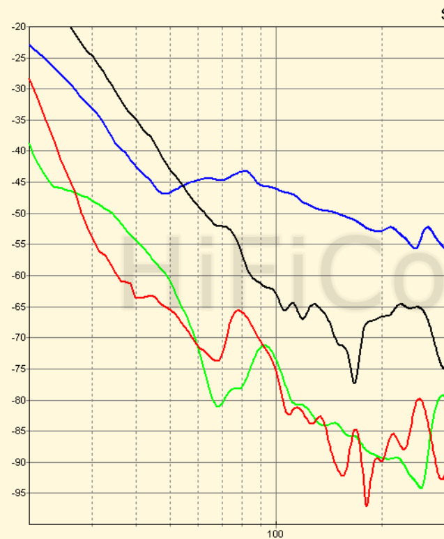

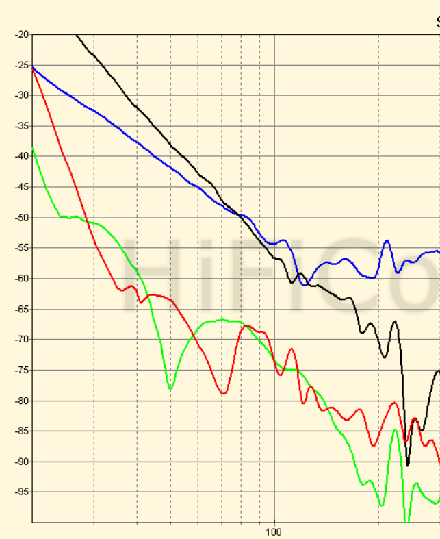

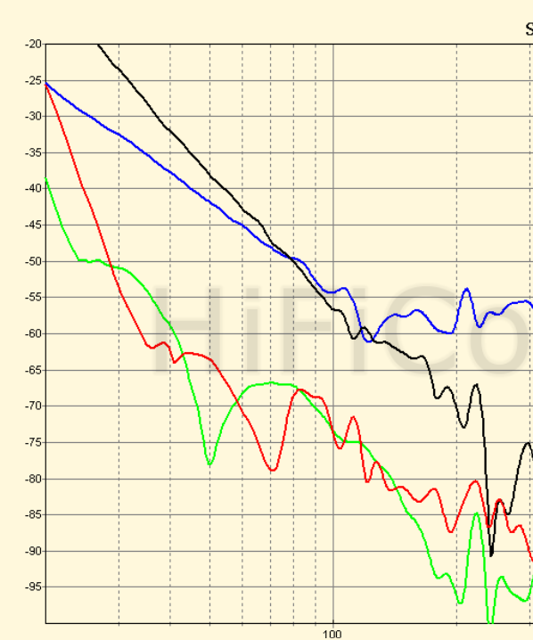

I agree we don't have to dig down into -80dB, which is likely buried beneath the noise floor of the room.
But I feel you may have not had a chance to take a deep dive into the graphs.
Do you have access to the Login/3 driver comparison feature?
Have a closer look again at how it compares to bigger bass drivers.
For brevity- I have attached 2 images below, cropped from Hificompass.com for educational purposes.
Both drive units are driven @ 5.6V, cropped at 300Hz to show what this novel 6.5 unit can do, compared to a 9" woofer.
Yes, your eyes are not deceiving you- the PTT6.5W04-01A is the left, the NINE INCH Satori WO24P-4 is the right...

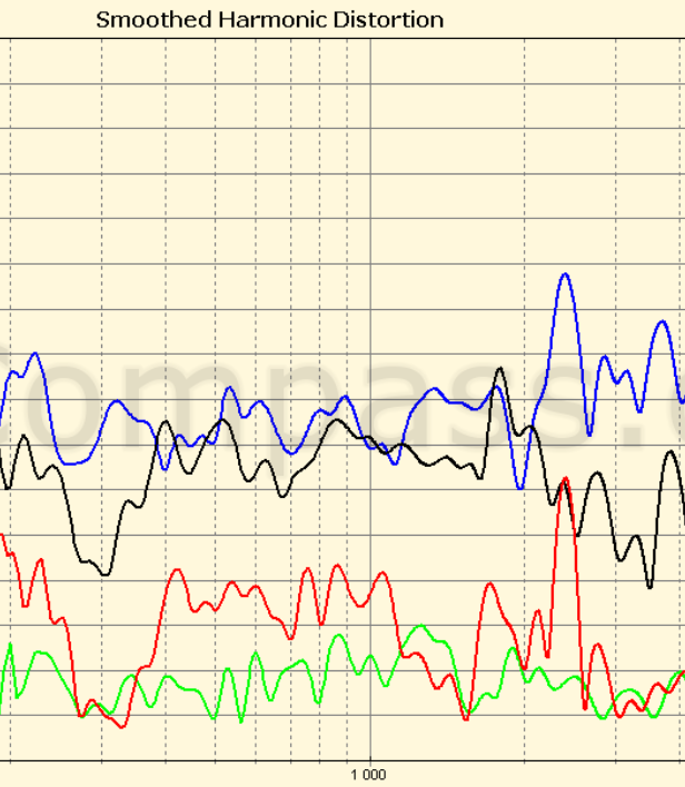

A narrow 2H peak around 2.5kHz also appears in the new datasheet, but it will be attenuated by crossover filtering if it even mattered in the first place.
As a point of comparison, it doesn't seem to be cleaner than SB17NAC/NBAC/CAC in the midrange and up. The SB metal cones and the Purifi have an easily worked response, but the Purifi has far more linear stroke than any of the 6-7 inch SB drivers. Beams slightly higher up than NBAC even though Sd is slightly greater.
In terms of LF HD spectra, it seems to come in just below the 23NAC as measured. Needs two-tone tests to probe Bl(x), Kms(x), and Le(x, f) of the SB.

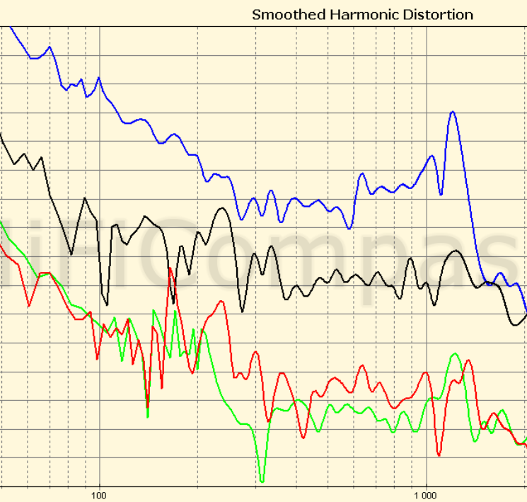

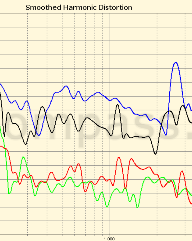

Here it is again, in (200Hz to 3.2KHz), ~midrange, driven at a cracking 11.2V
That's the PTT on the left, and the SB17NBAC on the right.
Winner winner, chicken dinner!

I have compared it actually. I'm in agreement that it has lower distortion than lots of other woofers and midwoofers. Thing is, i don't consider distortion under 100Hz has any correlation to perceived bass quality anywhere else but in an anechoic chamber - though it has just 2nd harmonic lower, not 3rd. Also, what are SPL's of those woofers at that voltage? Distortion in rest of the spectrum is stellar but is the difference between a driver that has 3rd at -70dB and the one that has it at -90dB perceivable at all ? Which parts of percent are we talking about - 0.03% vs 0.003% ? That is measurable progress but not where is needed the most in my opinion.
Let's expand a little bit. This is a loudspeaker that has low distortion, no question about that. Then it remains low distortion at higher SPL (100dB). I'd argue that for midwoofer of that size it isn't necessary. If you are making Purifi PTT play at 100dB spl, since you have two, that gives 106dB at 1m total for two loudspeakers. That means to me that you either have a large room or you are deaf. If you are deaf, then it might be justified. If you have a large room, it negates the main advantage of this loudspeaker of being small and needs a small cabinet since you obviously have room and can accommodate larger cabinets with higher SPL output potential.

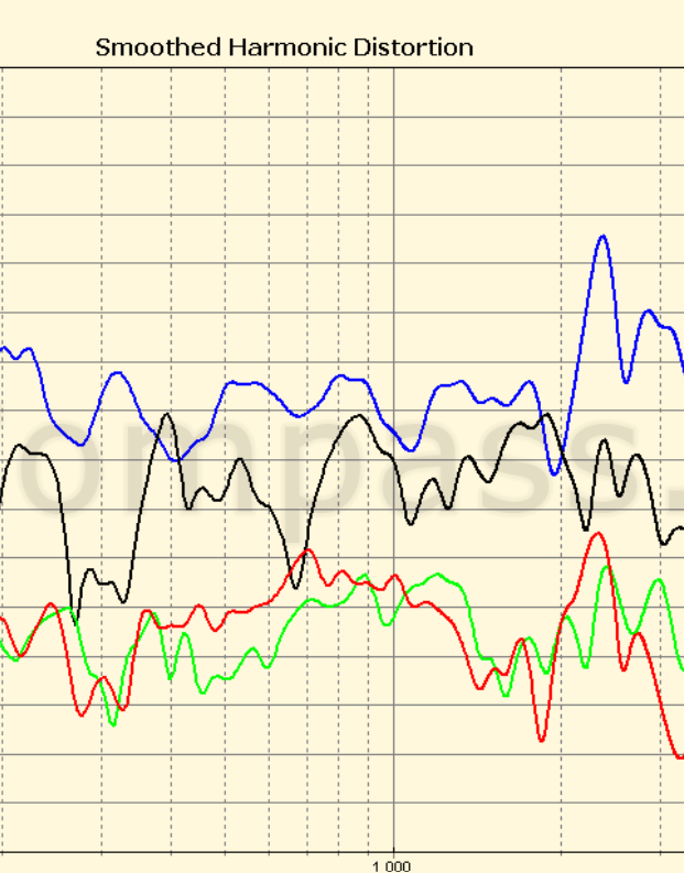

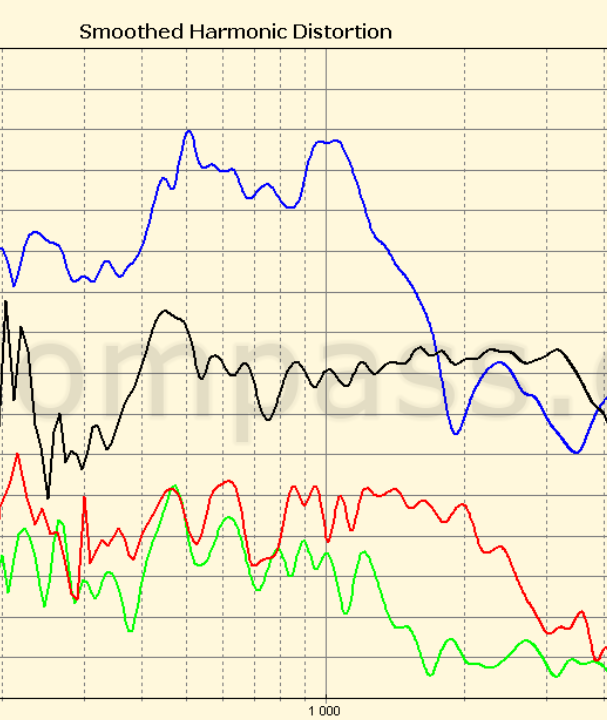

Third comparison
Here's it again, @11.2V input
vs Satori MW16P-4 @2.83V input
In lay terms-
During rolling crescendos (eg. 32W input), this driver is cleaner than the Satori at 2W input!
Taking into account the difference in SPL sensitivity, at 10dB louder- it's still cleaner.
Incredible midrange
Incredible bass
Incredible dynamics
