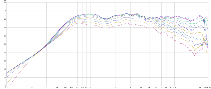

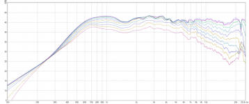

It's not puzzling at all. You are comparing a waveguided tweeter with regular one. Bliesma is smaller so CTC distance will be smaller also, unlike SS. Put Bliesma in a shallow waveguide and compare it then.
This is a good point.
It's still puzzling for me. Going the other way round: Compare the Bliesma to the SS D2905/970000. The latter is exactly the same build, identical to the D2905/990000, except for it's waveguideless, plane faceplate. And this 97..-type has an incredible smooth frequency response, better than Bliesma below 20kHz, e.g. +- 1.5dB from 900Hz ... 20kHz. This comes at the price of some more THD above 10kHz and less sensivity because of no loading of the highest octave compared to the SS 99...-type.
Comparing all thoghether and allowing the waveguided 99..-SS, the Bliesma is better than the SS above 2.5kHz. Below 2.5kHz, the Bliesma is rather a regression.
As you suggest, it would be really interesting to investigate a waveguide-equipped Bliesma. But it will not be me spending money for this experiment, I would rather expect this kind of investigation from the part of Bliesma.
