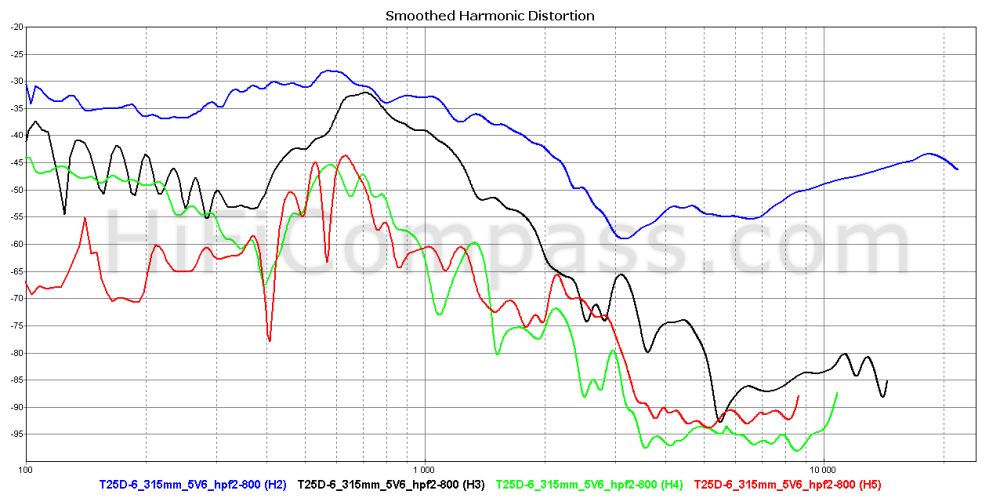

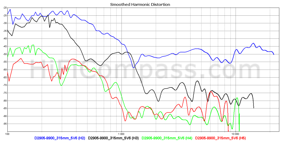

Obviously, not much has changed in 30 years of happy development ... at least THD-wise. Why that ???
BliesMa Beryllium vs. Scan-Speak D2509 99000
That might be, but if nothing els, you are doing clever marketing.. :). Looking at the frequency response, then things change. While harmonic content can be said to have matured years ago, the on- and off axis most certainly needed an update, and that is what we are getting with some of the newer tweeters.
Maybe I might be clever, thanks for that one, and you might be right in this term, maybe. But I don't intend to do any marketing at all. Here you are definitively wrong. I am simply comparing different drivers. And also I would most be interested in having the opportunity to compare multitone IM measurements, also.
The brand nes Bliesma is certainly a nice driver and better than most other tweeters, but not overwhelmingly better. It's not a magnitude better in all terms, but slightly better in some terms compared e.g. to the (old man) SS:
Comparing both speakers in terms of frequency response, Bliesma is indeed smoother and extends this way from 1.2kHz to some 32kHz within +-2dB. This is really nice. Scan-Speak is slightly more irregular and within +-2B from 950Hz to 20kHz. +1 for Bliesma.
Comparing both speakers in terms of CD, again Bliesma is the winner.
But still, in the range around 2kHz, ScanSpeak is the clear winner (<50dB/0.31% for SS vs. <40dB/1% for BliesMa @ 5.6V input). And this is puzzling. After all these years of development, CAD and new materials, I am really disappointed that no driver is on market with less than 0.1% THD @ 96dB/1m troughout 1.5kHz to > 20kHz. Should be possible, though.
No marketing at all, then. Just comparing and hoping for the really, substantially better to come, yet.
And please include multitone IM measurements.

It's not puzzling at all. You are comparing a waveguided tweeter with regular one. Bliesma is smaller so CTC distance will be smaller also, unlike SS. Put Bliesma in a shallow waveguide and compare it then.
You're right about one thing though, performance is just a bit better. Dome tweeters are hitting the limits of what is possible with todays materials and software.
I think that biggest advances are being made in planar tweeters (amt and ribbon in particular). Viavawe ribbon tweeters are remarcable. Also, HEDD/ADAM type AMT and Mundorf AMT measure great. Now, smallest Mundorf has around 24cm^2 surface, equivalent to 2" dome and it has great horizontal directivity. Subjective difference between 8cm^2 (regular 1" dome tweeter) and 24cm^2 ( 1" wide amt) playing the same tone is phenomenal.
