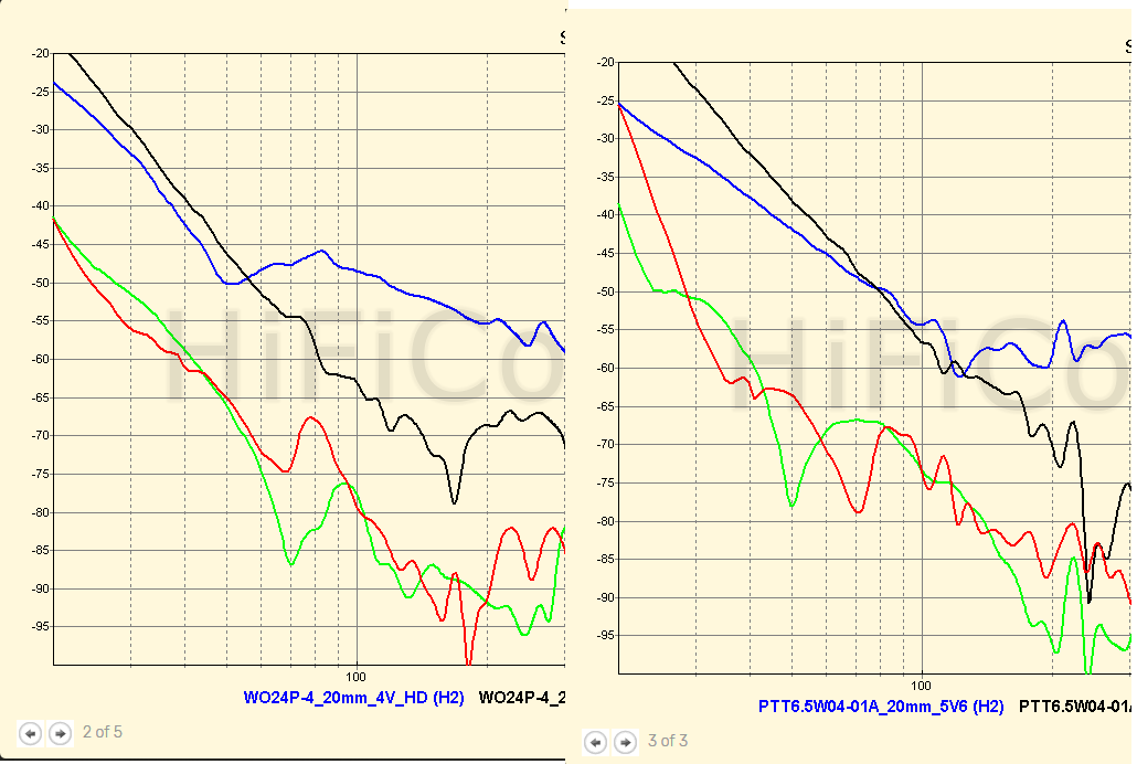

Two can play that game of course. This is my point of view:
Satori WO24P-4 vs Purifi PTT up to 300Hz distortion at 94dB (since that is maximum measured for PTT):
As seen from the pic, somewhat higher 2nd order in WO24P but everything else is better.
SB17NBAC35-8 vs Purifi PTT 300Hz-4kHz at 100dB loudness
WO24P-4 and SB17NBAC35-8 combined cost is 265 euros. Throw in Peerless DA25TX and you are at 340 euros, still bellow 450 euros which is a price for one PTT midwoofer. That doesn't mean that you get lesser of a result of course. Three way mentioned would do more SPL with same (or better) distortion and for less money. At the expense od 50 liters enclosure, true.

Not neccessarily. It just might happen that PTT sounds better. Who could know fir sure before listening these two loudspeakers side by side. We throw around numbers and figures of harmonic distortion and at level that is quite insignificant in my opinion.
