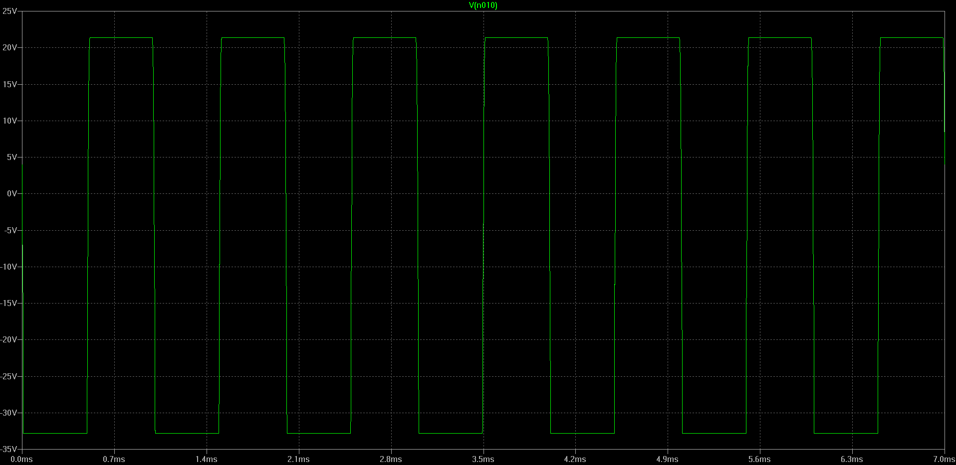

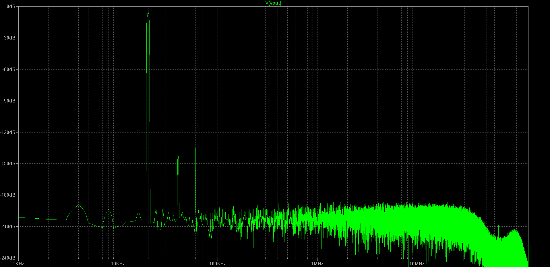

Some other Source Follower Configurations
again

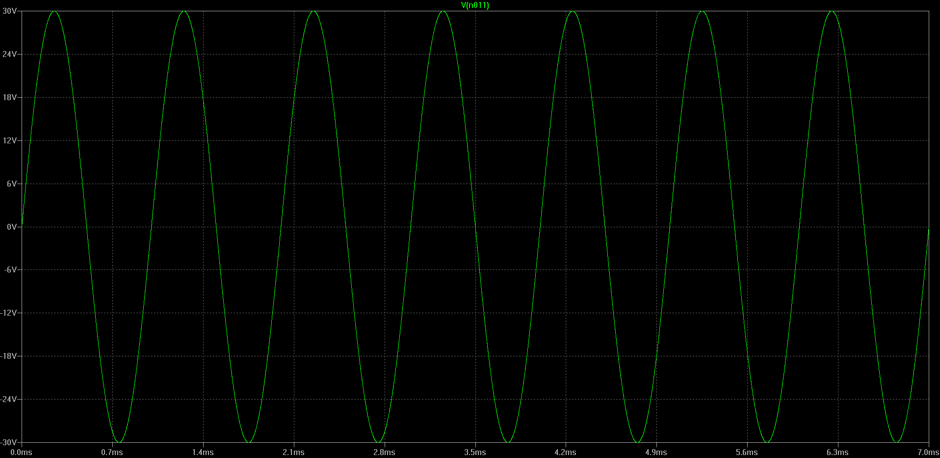

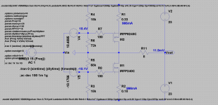

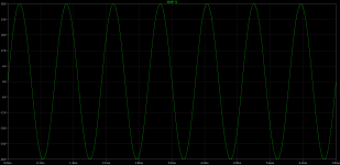

inverted source follower:
I would like only remain that it
has good linearity,
high input impedance,
~270mA bias,
negative thermal coefficient for fets
and is so simply...
do you know other followers running @swing 30V with distortion ~-150dB?

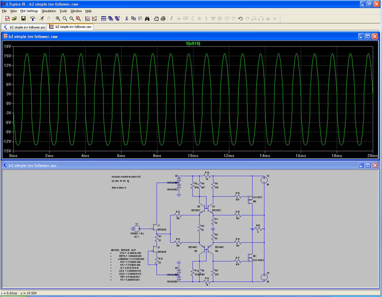

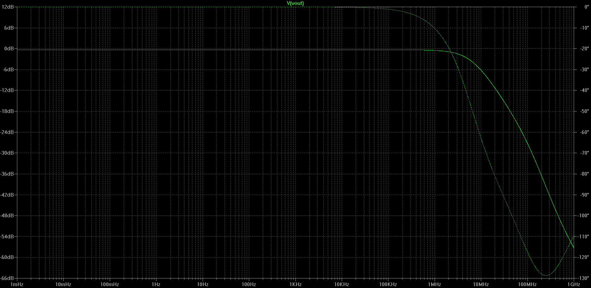

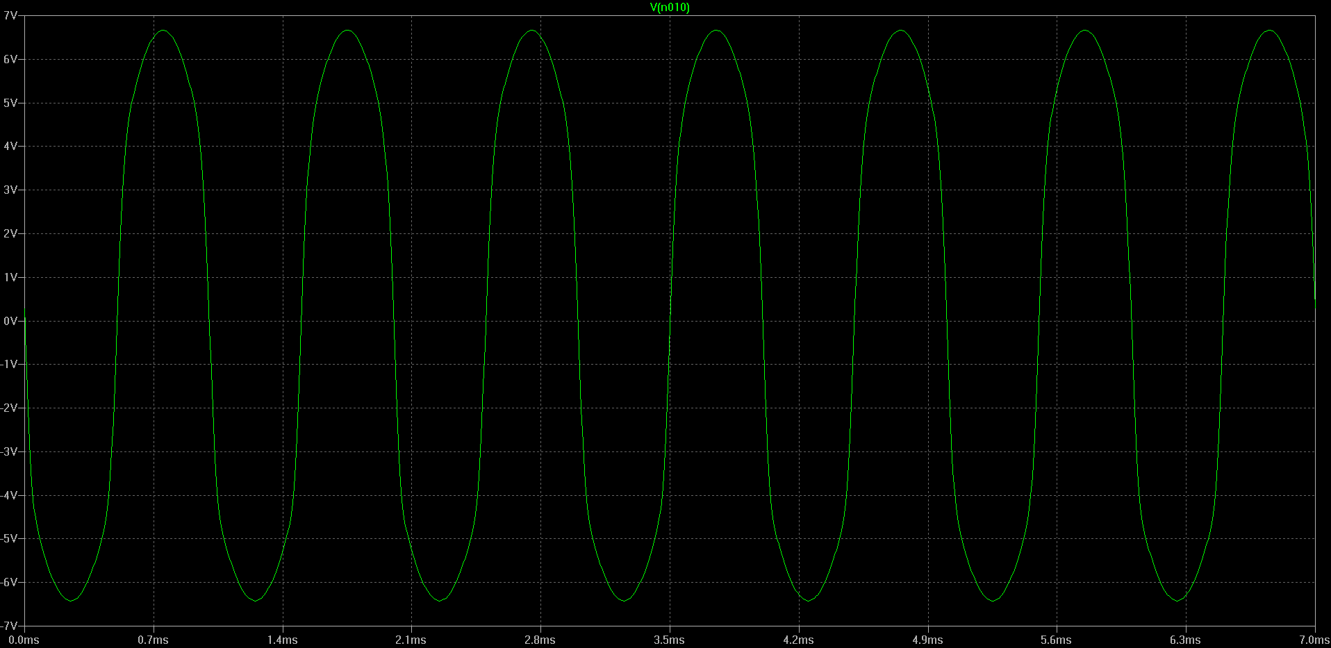

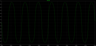

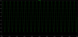

Guys
it looks like the circuit has got the gain during the night😀
(250mV at the input)
sorry for inconvenience, I have no idea why the circuit's behavior has changed, I will try to find and correct the mistake🙂

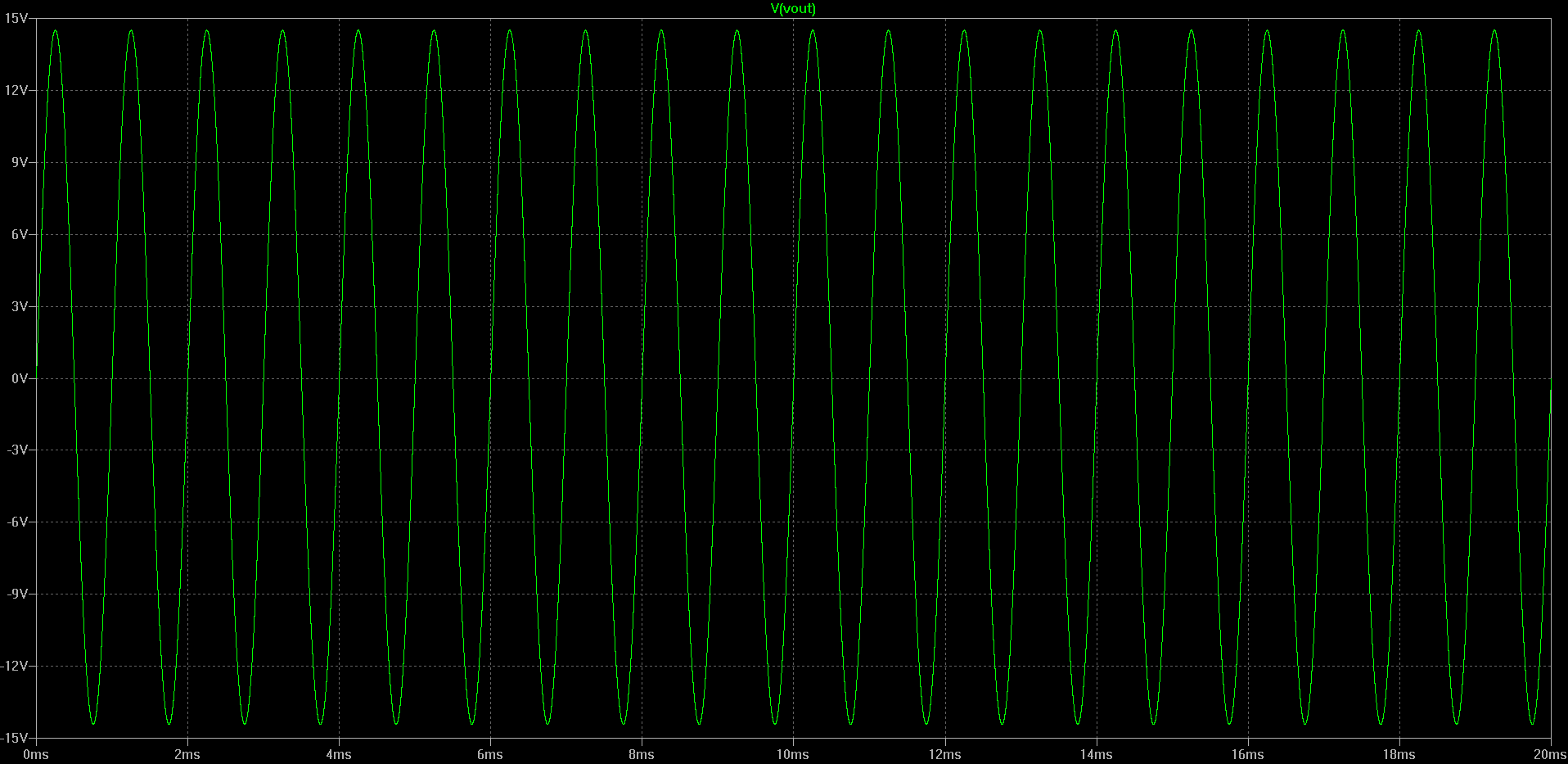

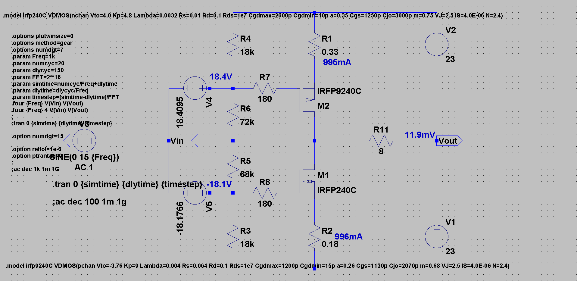

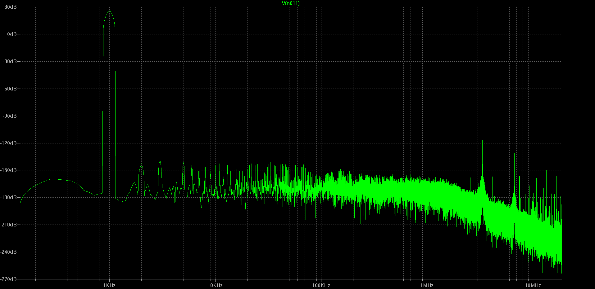

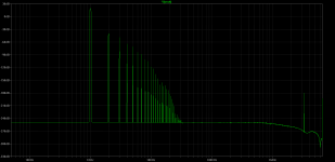

this time I have checked
this is clear inverted follower with voltage sources instead of big caps at the input to let ltspice make good calculations/simulation.

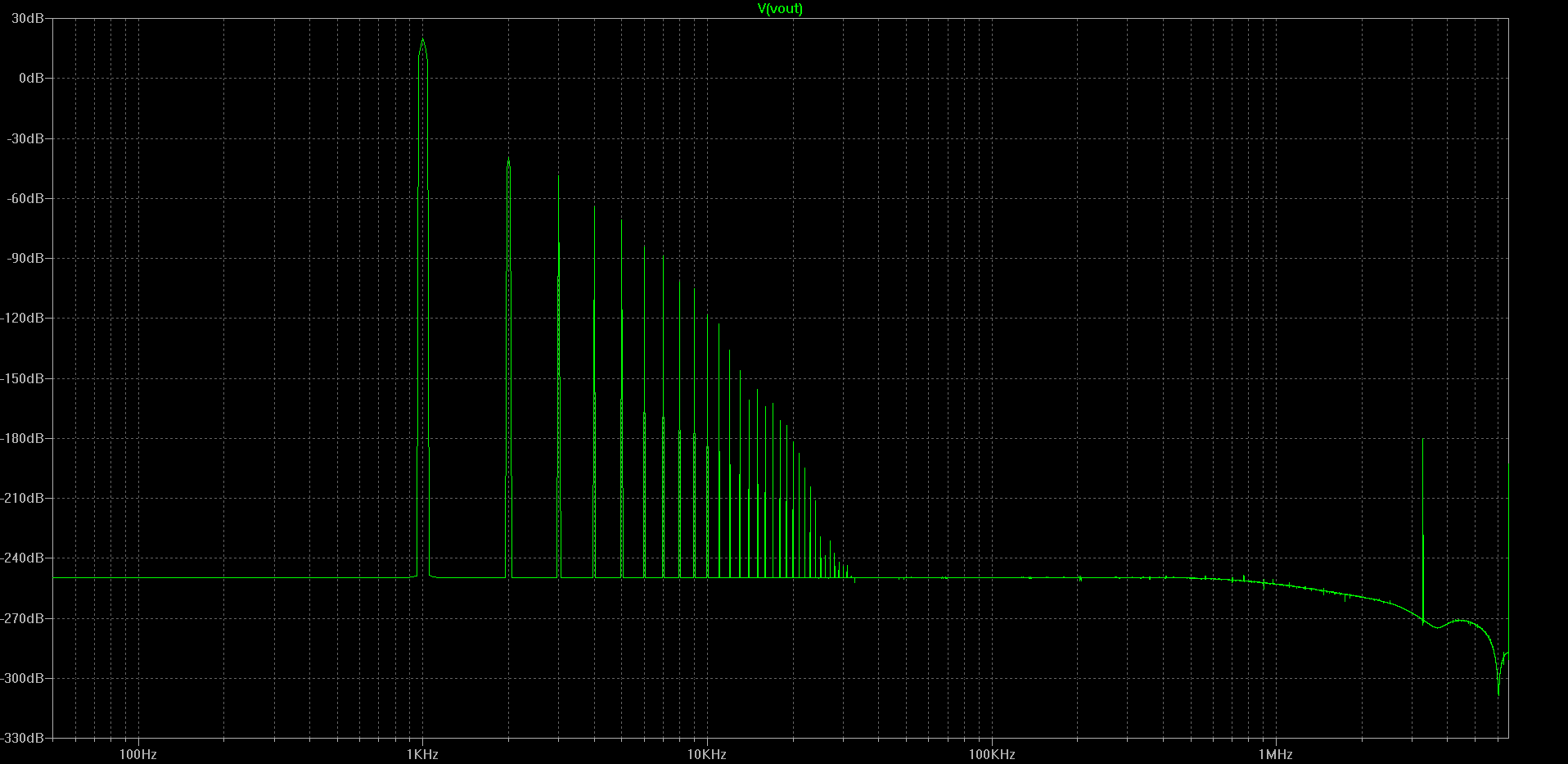

thd:
N-Period=1
Fourier components of V(vout)
DC component:0.0260207
Harmonic Frequency Fourier Normalized Phase Normalized
Number [Hz] Component Component [degree] Phase [deg]
1 1.000e+03 1.447e+01 1.000e+00 -0.01° 0.00°
2 2.000e+03 1.492e-02 1.031e-03 -92.14° -92.12°
3 3.000e+03 5.350e-03 3.697e-04 9.32° 9.33°
4 4.000e+03 8.804e-04 6.084e-05 80.75° 80.76°
5 5.000e+03 4.018e-04 2.777e-05 -149.71° -149.69°
6 6.000e+03 8.482e-05 5.862e-06 -113.99° -113.98°
7 7.000e+03 5.179e-05 3.579e-06 52.64° 52.66°
8 8.000e+03 1.114e-05 7.698e-07 46.49° 46.50°
9 9.000e+03 7.858e-06 5.431e-07 -115.42° -115.40°
Total Harmonic Distortion: 0.109745%
  • inv foll 2409240voltsource.asc

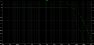

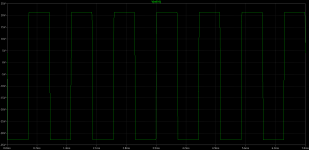

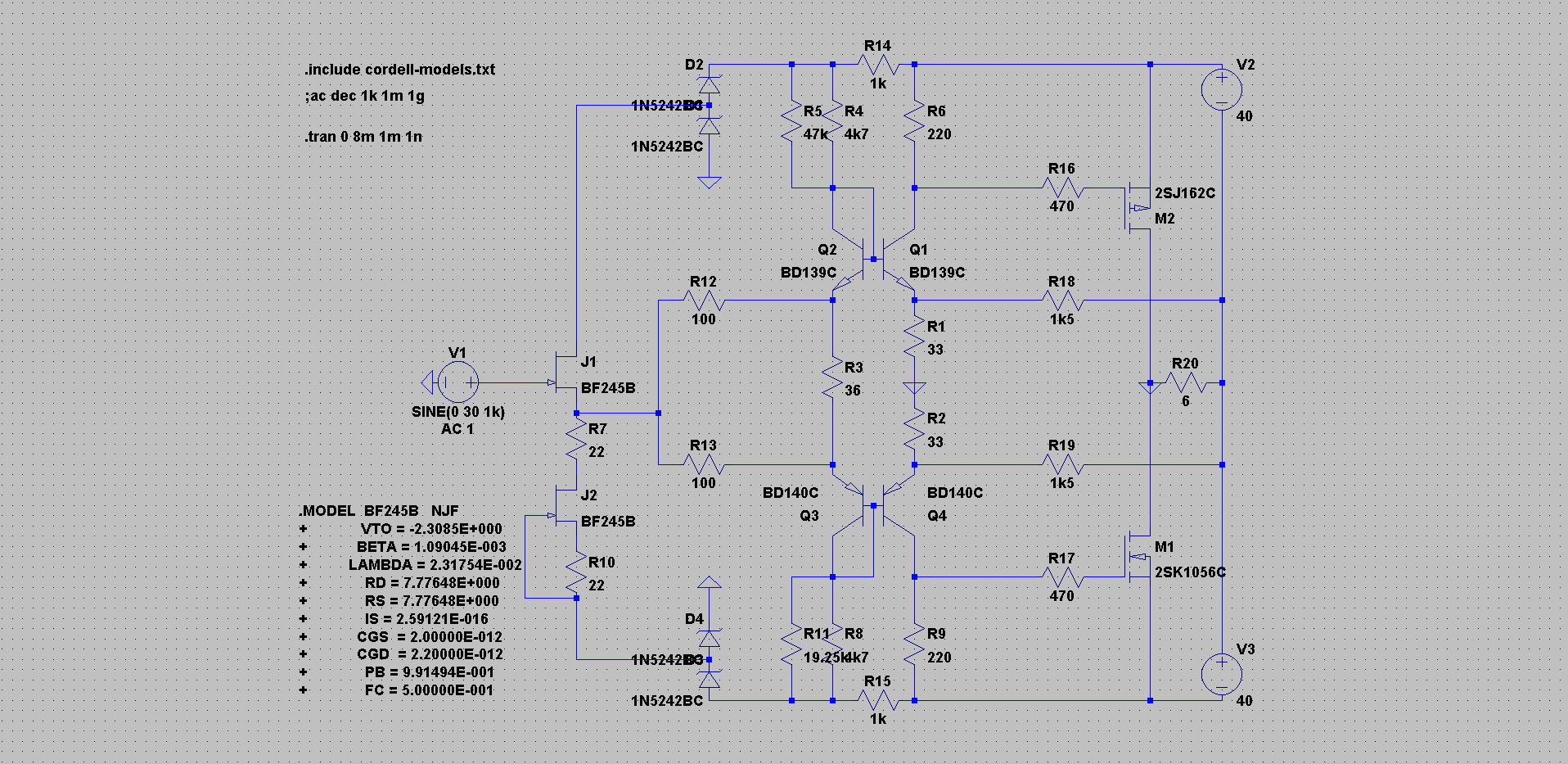

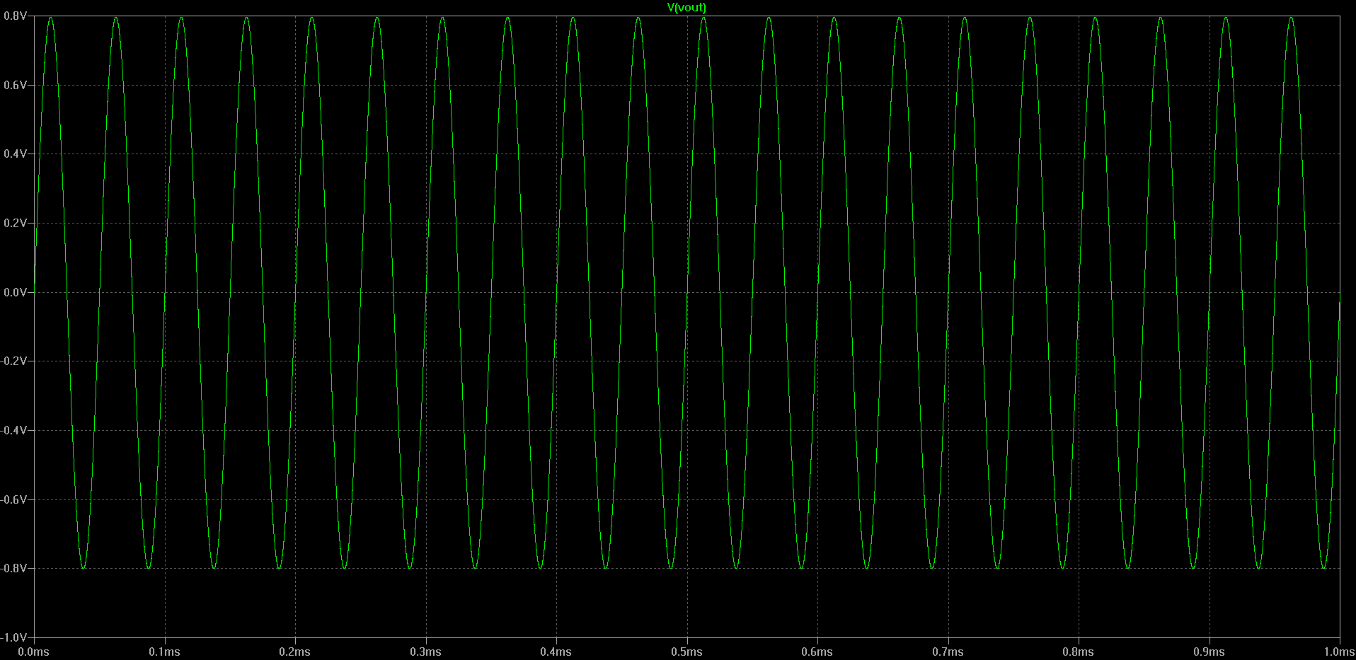

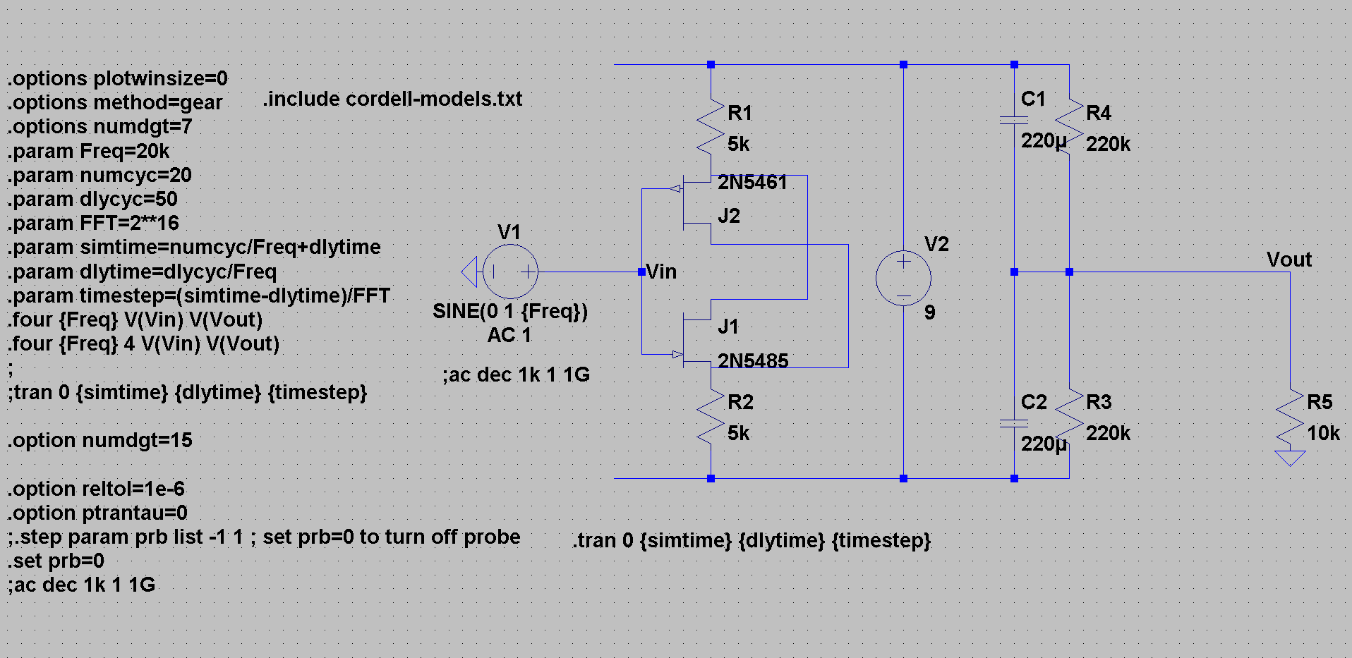

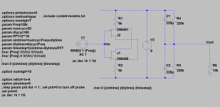

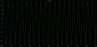

guitar/line buffer
Hi
this time I have the idea of small signal pp source follower buffer with floating power supply.
the results are for 1Vpp at the input, the load is 10k.
for guitar the loads are much higher, 220k-10Meg which means lower distortion.
the circuit is easy for mounting inside the guitar together with the battery.
remember about hf blocking circuits.
  • inv foll guit buff jfet.asc
