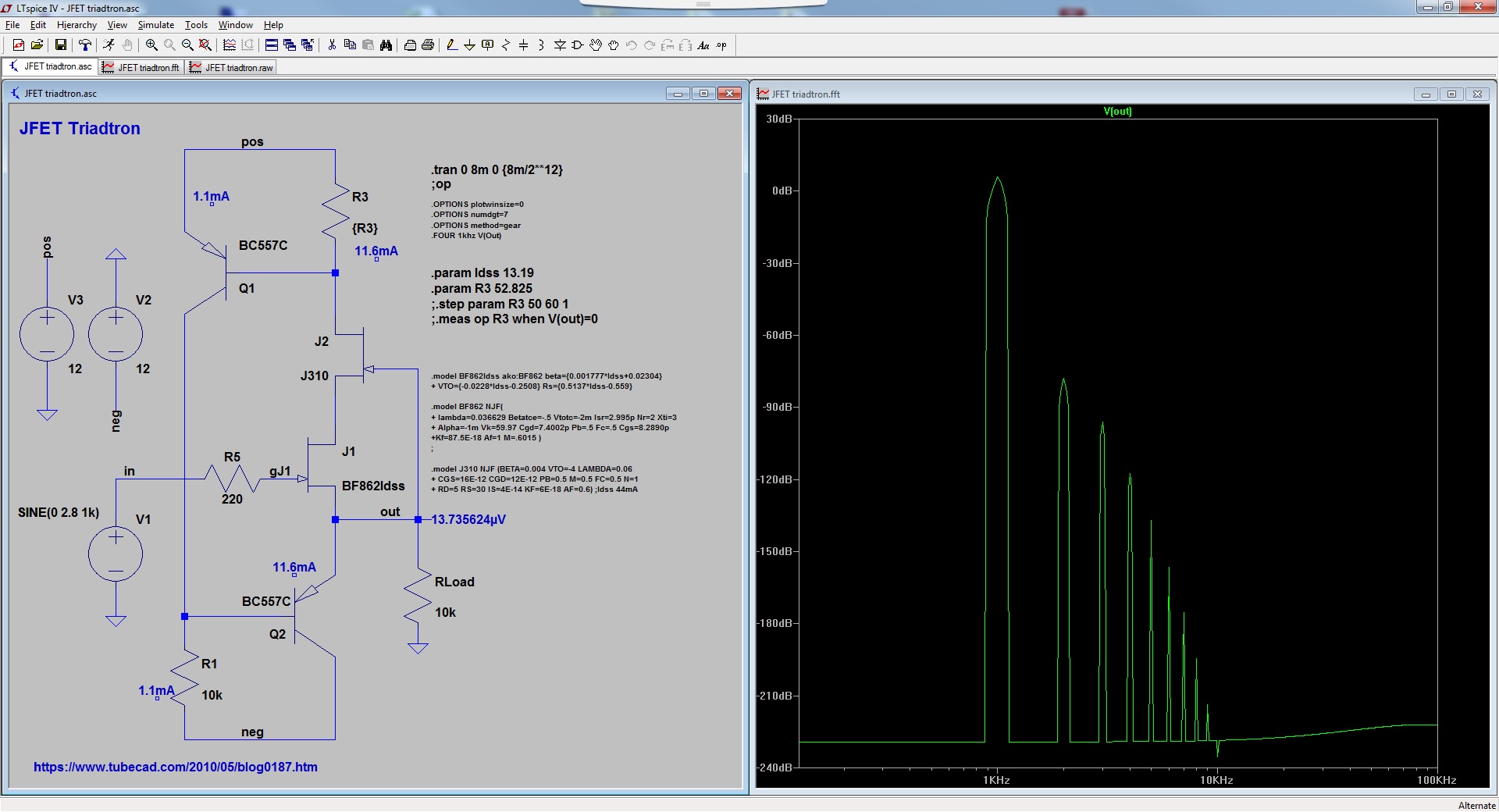

Here's another source follower:
A JFET Triadtron after John Broskie. It has a Zout of 28 mOhm (mind the milli). I prefer my BF862 to be cascoded as they tend to gate leak with higher Vds.
Let me know your thoughts.

Many of these circuits, including the TCS, do not always justify their complication when driving high impedance loads.
You can achieve the same performance by just using 2 pairs of matched NJFET in parallel.
And they, when thermally coupled, have very stable DC.
They come to play when you want to drive 30 ohm loads, as in the DAO.
Patrick
A TCS follower is push-pull, like a complementary follower.
So it halves the Zout of a NJFET follower.
Using 2 pairs of NJFET in parallel achieves the same.
The only difference is even harmonic cancellation in push pull.
My first DIY preamp using 5 pairs of 2SK170/2SJ74 in parallel.
Zout is < 3 ohm.
Patrick

The reason why I got attracted to TCS follower is predominant Second harmonic distortion.
What is the type of distortion in B1 and 2 Pairs of matched Jfets in parallel? Anyone measured or simulated them?
