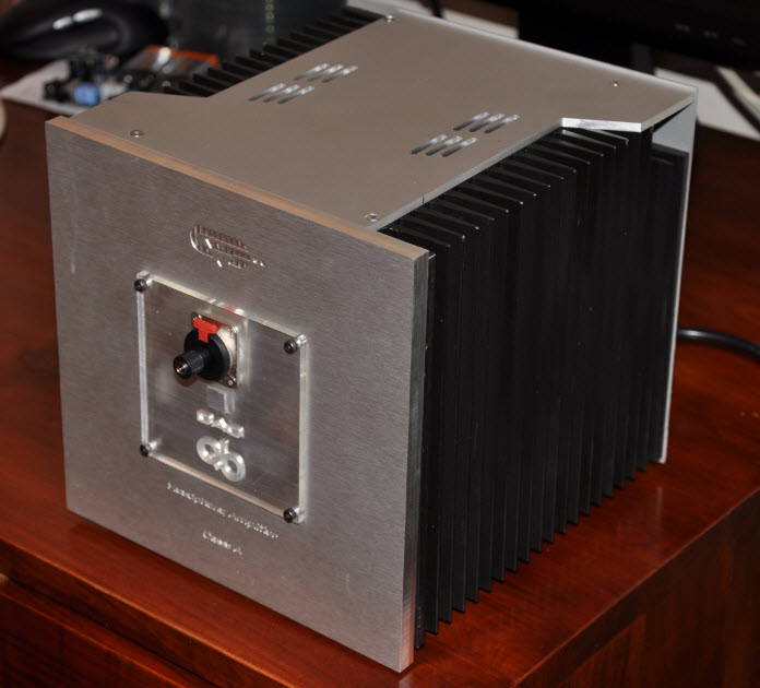

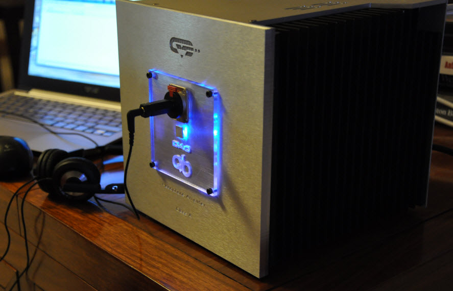

Some pictures...built arround some heatsinks i recycled...maybe too big but looks ok.
Thanks Steen for the inspiration .
It does get slightly above warm !

Immaculate metal work.
Pity that you are too shy to show us the electronics inside as well.
Did you build the standard version or the Taylor current source ?

Thanks Patrick,
I was too busy enjoying the music to take the lid off again ...also wanted to see how temperature would stabilize with case closed.
After about 6 hours running time i can say it stabilizes pretty hot, no crickey hot ...but a fair bit above warm !
So in hind sight it's not too big, as a matter of fact it's just right.
I'm running it from CLC PSU with +-18V Toroid.
It's the TCS version and i use motorola 1N5314 instead of J511.
I had to fiddle around a bit with R1 to get Dc offset right because of bad matching.
I'll end up replacing the boards after decent matching new transistors and will probably go for your new boards as well in the process....but for now it sounds so good as is that i can do that relaxed with the knowledge that it's going to be even more outstanding

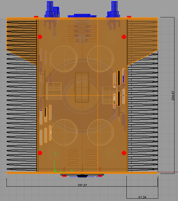

PS In our own case, we use a sink 200x250x37mm.
What size is your ? And how hot ?

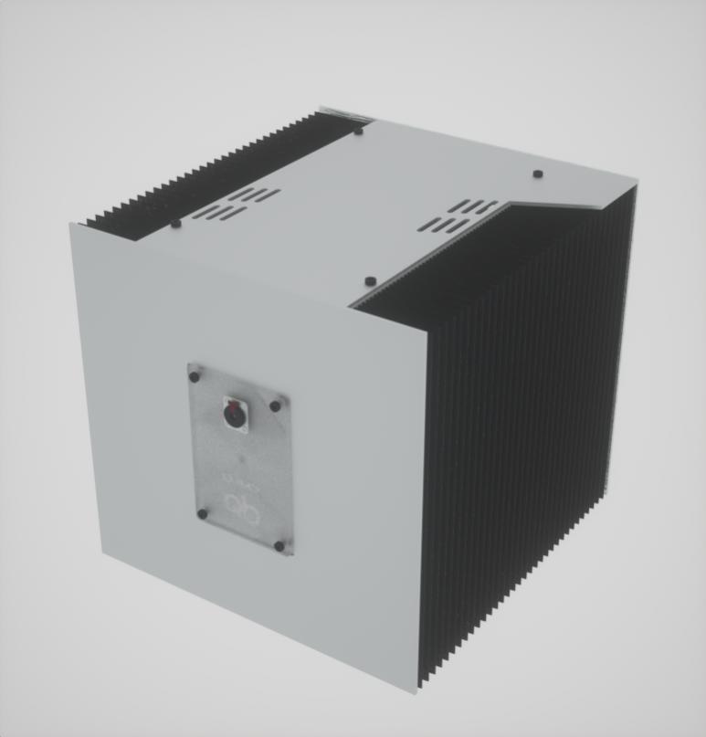

My case is 200 x200x200 ...hence DAO QB in face plate.
Heatsink is 4cm deep.

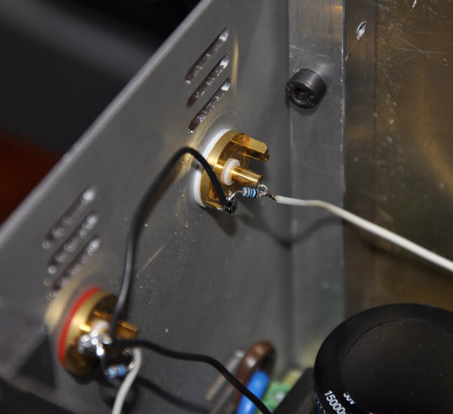

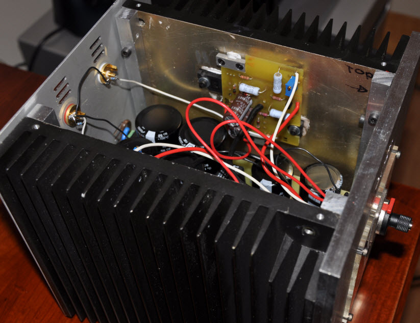

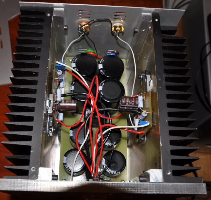

Ok Patrick...as promised ...some numbers and pictures.
Another 6 hours running and....in my son's room , no moving air, 20ish ambient temp:
Whole cube stabilizes at 41 ºC..with my lazer thermometer.
Took lid off ...measured the Panasonic 3W resistors...53 ºC, transitor case 46ºC ( not the JFETs , those are cooler ).
So i would say that this is pretty much worst case scenario and what is clear to me is that we should use parallel power resistors to lower individual temp but all else looks pretty good, case size and heat-sinks are optimum.
Any little air flow or lower ambient temp causes stabilized heat-sink temp in the region of the 30sºC.
I was listening in my living room with the windows open and that's what i got.

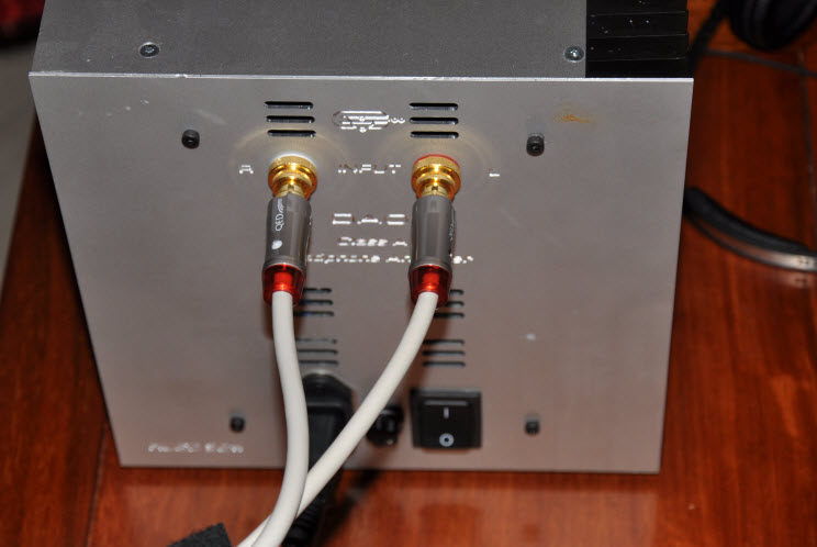

note:resistors in parallel with input are 10k !
PS: wiring is a mess but it's early days, output and input, ground wires are silver from old coms equipment, power is run of the mill copper.

Thanks for the comments guys,
Well james , you are right ..that is how i run my F5 and it sound gorgeous.
We now have objective detailed numbers to fine tune, we can ;
0 - remember i measured temp in the evening at around 20ºC ambient temp...
1 - make smaller heatsinks or...
2 - crank up the bias a bit or...
3 - Leave as is because i want an all year amp and the weather in summer here in Lisbon is quite a bit above 30 ºC...sometimes above 40ºC.
As for the heatsinks...you are right also Patrick, my Chip amp ( Pavel Dudek's actually ) has an heatsink half the size of one of these....for both channels !
Since i happen to like the cube format, which happened by mere chance, i can take a cm of each side and be right on the magic formula.....but i don't think i will take that route....maybe next one.
