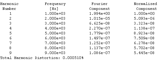

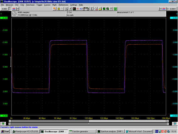

I wouldn't call this trouble; more like fun 🙂 I intend to build it as soon as I get the parts and will put it through the spectrum analyzer. No reason to expect disappointment.
Remember to load it with low impedance (66 ohm or less).
I get perfect square waves with 67 ohm load.
(Magenta is input; orange is output under load.)
Patrick
Patrick
Definitely will test with load, since my interest is in an amp for my 63 ohm headphones.
Is that step response a real measurement?

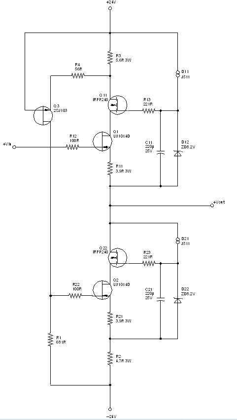

No doubt you've explored this circuit a lot. Would replacing the lower jfet with a mosfet result in a significant performance drop? (Can you tell I'm cheap?)
If you use the standard DAO, then in theory you can use any constant current source. It so happens that the cascoded LU1014 is a very good one. But more importantly, I used them because they allow identical thermal drift on the upper and lower halves, thus guaranteeing near-zero DC offset. This is the same argument for using my 2SK372V heatsink for the current sourced loaded source follower, or the "B1".
In the TCS version, you are actually using the lower device as well to provide current. Thus the linearity of the lower device becomes equally important. And I certainly would not recommend you to use a mosfet there.
Patrick.
Patrick.
You can either trim R1 (681R) or R2 (4.7R) to set the DC offset back to zero.
I would try 681R first as it is low power and high value.
Patrick
Patrick

Hi EUVL,
I'm finishing my DAO build and i've just found an inconsistency between the schematic ( post 309 )and the PCBs of post 15 and 47...
The top ( in the schematic ) J511 connects to the +24v line but in all PCBs i've seen in this forum it connects directly to IRFP240 Drain.
Could you clear this up for me please ?
There are very few who noticed that. 😉
In theory it is better to connect the current diode (J511) to the positive rail.
In that particular layout, it was a bit difficult, so I took the next best point that was more convenient for the layout, which was the drain of the cascode MOSFET. Because of the use of the current diode, this does not make much difference.
However, since the J511 is now obsolete, and you would probably want to use something like the E452 as a replacement, you can conveniently connect it back to the positive rail. In fact, this is what we are doing right now (in designing a proper PCB for the DAO TCS).
Patrick
Patrick
