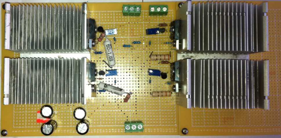

built a prototype. have not compared it to anything, but i have a suspicion that it is very high bang for $$. so far so good 🙂
next step: taylor mod
one thing is for sure... my hd595 seem to be happy with this much gain 🙂
one question:
what should be the idss of 2SA970 if i want to use it instead of 2sj103?
...and+-2,5%?
i found out that buying a lot of 100 2SA970 to get a close match is half the price of the 2sj103 100 lot. 20$ vs 40$
