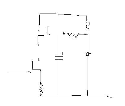

would it be a good idea to move the zener bypass cap after the mosfet gate resistor to form a low pas filter, i.e. put the cap between the mosfet gate and output for the top mosfet, between mosfet gate and V- for ccs mosfet ? i m not sure but thought i might ask.
The cap is there to filter Zener noise, not for low pass filtering of the cascode FET.
The Vgs of the cascode FET cannot be constant as the output current modulates.
Patrick

very good question.
i m kind of beginning to learn how electricity works and didnt not bother with learning LTspice...yet.
just thought i might ask for some guidande first. i would eventually have tried it to judge from my ears but they never tell me me if it is proper implementation.
i also dont have a scope yet.
i ll probably spice it or mod it and let you guys know 🙂
