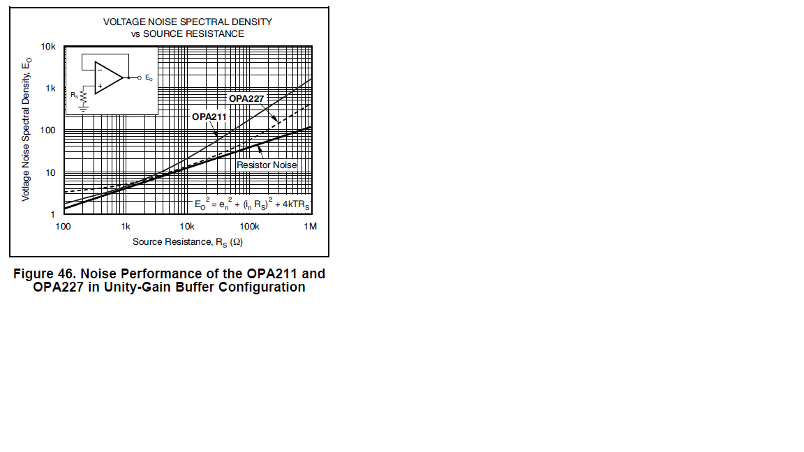

Gerhard,
Parallel opamps can lower the voltage noise by sqrt(N), where N is the number of opamp.
How about the current noise? Will parallel opamps reduce it or increase it?
It increases by the same power law. This is an advantage of JFETs, as the parallel ("current") noise is so small to begin with, at least up to about 100kHz, when one begins to see induced gate noise from the channel thermal noise.Gerhard,
bcarso, thank you for the explanation.
I do have the same thought.
I have done some calculation before. It seems that the resulting current noise is quite large unless we can keep the resistors values very low. As far as I know, most bjt opamps' current noise lies 1.x ~ 2.x pA /sqrt Hz. After parallell, the noise voltage will be in the same magnitude as the voltage noise of the bjt opamp used. However, the input impedance cannot be so low when using bjt opamps. Right?
So, I expect that there may be limit or a sweet spot about the number of parallel opamps.
Think in terms of the parallel noise flowing in the source impedance, not the input impedance of the op amps. This, for many interesting measurements, or for applications like moving coil cartridge preamps, can be quite low. For example suppose the source impedance is 10 ohms. Suppose our candidate op amps have voltage noise density of 1nV/sq rt Hz and parallel "current" noise (at each input) of 2pA/sq rt Hz. What is the optimal number of op amps to be paralleled? Let's suppose we use them in the noninverting configuration, and have a very low impedance feedback network to set the gain so it has a negligible contribution to total noise. So we need only consider the parallel noise at the noninverting input.bcarso, thank you for the explanation.

For the moment let's suppose the 10 ohm source has no thermal noise (it's in a 0 Kelvin refrigerator). With one op amp we see the 1nV/sq rt Hz and 10 ohms times 2pA/ sq rt Hz = 20pV/sq rt Hz. Clearly the 1nV dominates strongly.
Knowing that a given result is a value of a smoothly varying function except for the lumpiness of N being an integer, we can determine the lowest value of e sub n attainable from methods of differential calculus, or at least by trial-and-error. For example, parallel 100 such amps. The voltage noise is now 100pV/sq rt Hz and the parallel noise is ten times 2pA/sq rt Hz times 10 ohms, or 200pV/sq rt Hz. The total input-referred noise assuming no correlation between e sub n and i sub n will be the rms sum, or 223.61pV/ sq rt Hz. So with 100, we have gone too far. The optimal number is related to what is more frequently shown as part of the expression for optimal source resistance, given series ("voltage") noise and parallel "current" noise, as e sub n/i sub n, so in this case we can derive a quadratic equation in N, the number of paralleled amps. The real positive root of that equation will be some value for N, unlikely an integer. So we pick the closest integer. Or look at this as making the "current" noise contribution flowing in 10 ohms as optimally being the same as the voltage noise contribution.
I'm too lazy to solve directly for the roots of the quadratic right now! It has been a very long day. But one can see where this goes. And I think the argument leads to a simpler expression.
So I just guessed Nopt is 50, and that seems to check. Total noise density will be the square root of the expression ([1nV/(square root of 50)]^2 + [(square root of 50)(2pA)(10 ohms)]^2), or 200pV/sq rt Hz. A big improvement over a single amp but a lot of them to get there.
So the shortcut is: determine the optimal source impedance for noise for the candidate op amp. In this case that is 500 ohms. Divide that by the actual source impedance, in this example 10 ohms. The answer is the nearest integer to that quotient, and in this case it is exactly an integer: 50.
One can see why amplifiers with negligible parallel noise are useful, although integrated JFET op amps' series noise is usually much higher than bipolar types.
Really good explanation.
You can see the noise vs. source resistance parabola in every data sheet
of op amps or transistors that assume bragging rights about their noise performance.
The sweet spot is simply the lowest point.

bcarso,
Not until this morning did I really how the source impedance interact with the current noise.
I also found that Douglas Self smartly chooses 5534/5532 for parallel opamp. Because these opamps are the few bjt opamps which have current noise lower than 1pA/sqrt Hz.
Let's compare doubling AD797 (0.9nV and 2pA) and 5534 (3.5nV and 0.6pA) with Rs = 500. For doubling AD797, we get 0.64nV and 2pA x 500 x sqrt(2) = 1.41nV. The benefit of decreasing voltage noise is counteracted by the increased (and comparable) current noise. For doubling 5534, we get 2.47nV and 0.6pA x 500 x sqrt(2) = 0.42 nV. We can see that the increase in current noise is less significant due to the small base value 0.6pA.
Douglas Self wisely chooses 5534 for parallel arrangement because of its low current noise (but the voltage noise is large enough).
