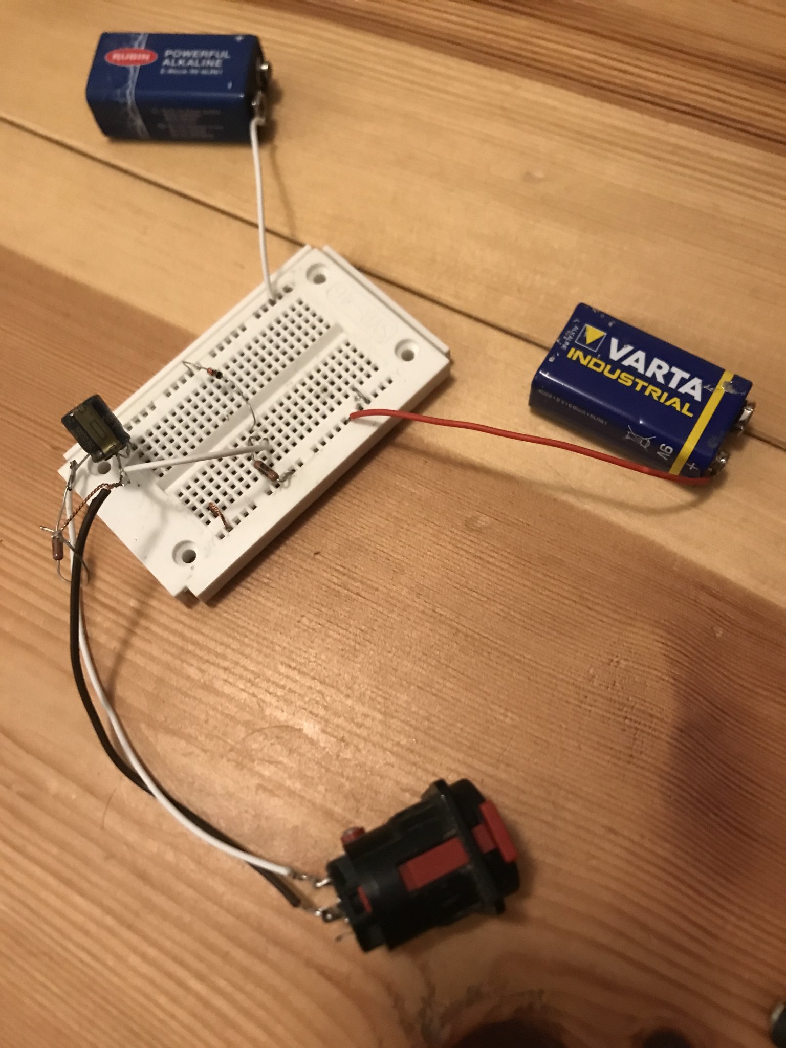

You could expect SiC to be noisy as the material purity and crystal flaws is poor compared to pure silicon
Is there anything better than a red led for a cathode biased triode ecc83 at 1mA. I need the grid to be at least -1.5V between 1mA to 1.5mA cathode.
I was goind CCS but then i wondered if the hassle is really woth it ? i want the lowest noise but only passive solutions (no external power).
Thank you.
Thank you.
