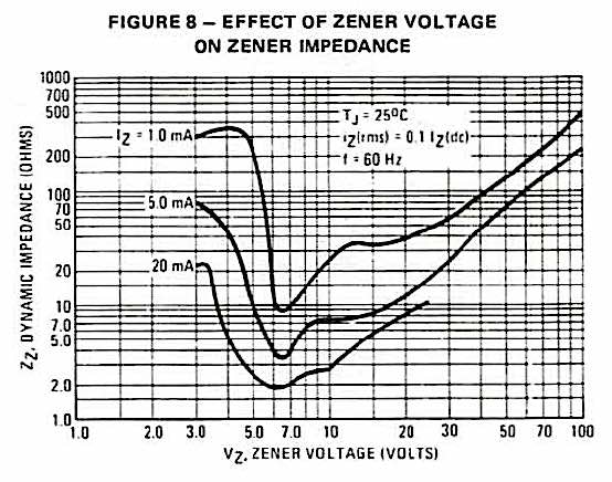

The noise reduction works the same with low voltage zeners.
The dynamic impedance of a zener depends on its breakdown voltage, and according to simple network theory, the filtering effectiveness of a shunt filter cap will then vary according to the zener voltage.
For zener voltages near 6V, the dynamic impedance is orders of magnitude lower than zeners with an avalanche of 3V. Zeners are not all one thing - there is the zener breakdown effect and the avalanche breakdown effect, and varying combinations of each are used to manufacture "zener" diodes of specific voltages. Not so important here, but the two effects also have opposite temperature coefficients, so an optimal blend of both effects will result in a "zener" with very low temperature coefficient.
Attached is a graph from a Motorola zener datasheet showing the range of dynamic impedance vs. zener voltage.
Again though, for zeners around 6V, their dynamic impedance will be very low, so their internal noise will only be able to be filtered with a large capacitor. It's simple network theory and what dynamic impedance means.
