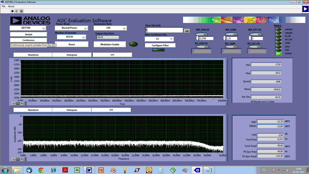

Hi ... here's one on the EL204YD (made with AD7760 evaluation board). The LF spectrum in my measurement setup has a bit more noise than the upper frequencies - thus the LF noise spectrum probably is better than shown. The ~3 kHz spike is an artifact (other noise). Current is 5.7 mA.
