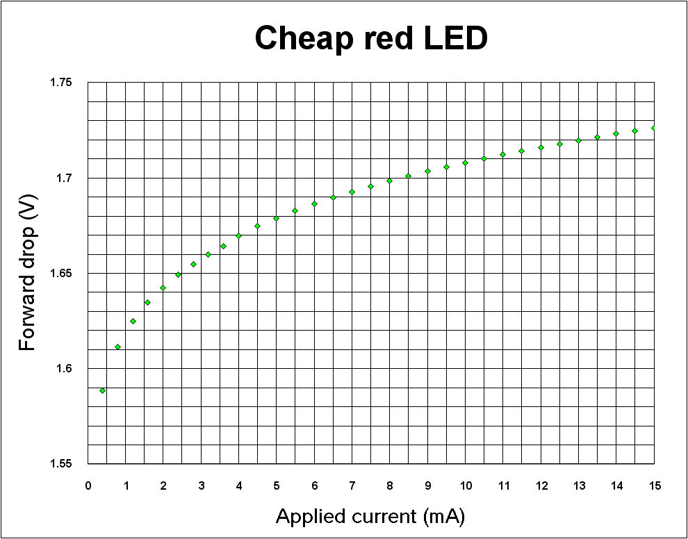

Great work, Christer! How about different color leds from the same family of devices? Did I miss this in reading this thread? You have a great test rig. Just plug in a red, yellow and green one at two ma, and compare. You will have my appreciation, (to save me from doing this). 😉
John, you may want to do it anyway. Christer mentioned that he hadn't really determined the relative noise contribution of the current source versus the LED (BTW, major props to Christer for both the measurements and his directness about possible limitations and errors!). Now, his measurements may be correct, but I'd like to see some confirmation with a different test setup- after all, don't you think it's odd (albeit interesting) that there's a minimum to the noise at a current well below where the impedance of the LED is at a minimum?
I'm attaching a Vf versus current graph of a cheap red LED, courtesy of Morgan Jones. I've done some single point measurements which give me very similar results. Naively, you'd think that there would be lower noise at 10mA than 3mA since the dynamic impedance is lower. If indeed the minimum is real and not a measurement artifact, that's a VERY interesting result.
