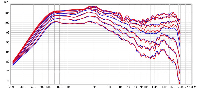

That ripple you are getting above 10KHz I'm certain will be mic mounting related. It was with my setup until pointed out. Can you put your mic in a long horizontal boom (e.g. inside some PVC pipe?) and make it long enough so that the stand is outside your gating window?
to demonstrate - here is a SB26ADC in a visaton WG148R waveguide in a trapezoid baffle with chamfers. The red is clip / mic stand in the measurement window. Blue is on a long PVC pole. That was the only change between red / blue measurements (apart from some slight off axis degree variation due to my shonky setup).

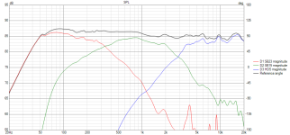

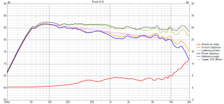

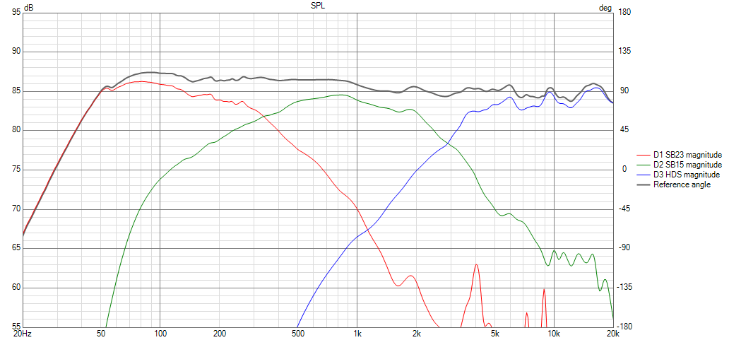

Some time ago I built 3 Way speakers on Sba 23 NBAC, 15 NBAC and HDS Tweeter. The project was created for a very long time, which allowed me to audition literally dozens of different filters, starting with 1st order filters and ending with LR8. On top of that, of course, I tested different speaker cutoff frequencies. Thanks to active filtering, I was able to do this quite quickly, and also just switching between filters was done in a fraction of a second. Each option played slightly differently, sometimes the differences were small and sometimes very large, nevertheless it was always possible to pick up the sound characteristics of the drivers used in the design. Unfortunately, not always what looked good in the simulation played correctly for me. Everyone has a slightly different picture of the ideal sound, and for me in particular the sound of the midrange was important. I wanted the midrange to be well saturated, vocals to have the right weight, and size. For the sound not to hide behind the speakers, but to be well radiated into the room.
After all the testing, I ended up with a fairly simple filtering.
The 15 NBAC on the midrange worked well, but somehow it didn't get me out of my shoes. If I were to do the same project a second time, I would choose the 15 CRC.

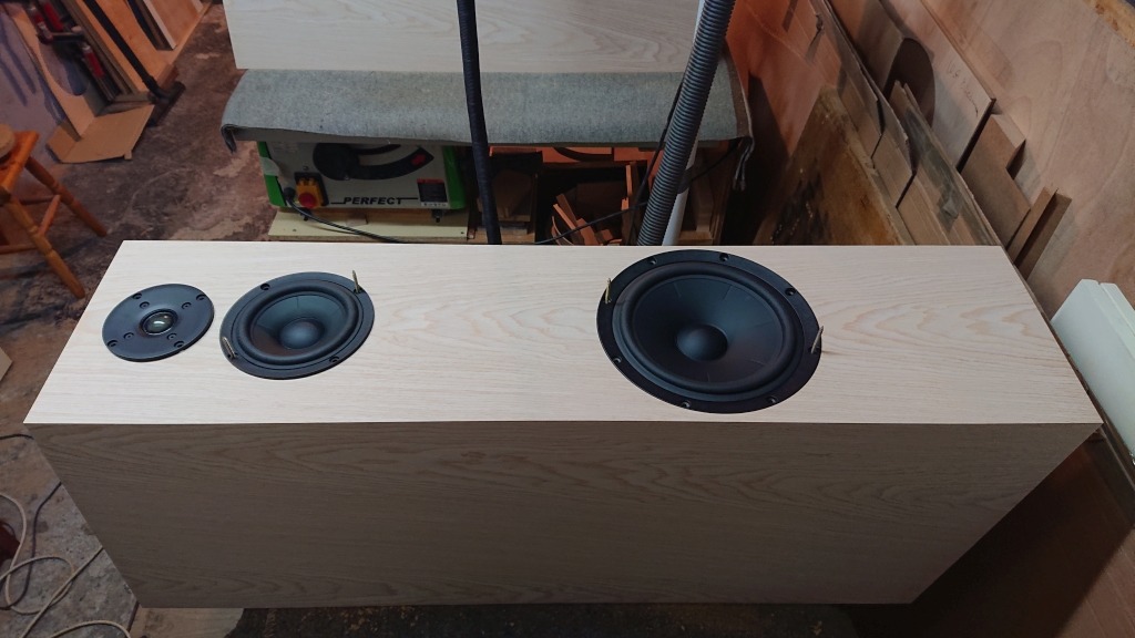

Well, the main reason is that I wanted to do a project with the new Sig225 woofer. My last project was an exercise in optimizing performance/cost ratio. For this project I mandated that I would use the Dayton Sig225 and the SB26STWGC, in a reflex enclosure, using a passive crossover. The only driver which needs to be selected at this point is the midrange.
The measurement was made with the mic in a 48" long PVC tube.
https://www.diyaudio.com/community/threads/purifi-waveguide-project.394174/post-7390062
I have made measurements of other tweeters in other cabinets with much less ripple.
I think the high frequency diffraction ripple you see in post #6 is coming from the cabinet edge. It is only a 20 mm bevel, so it will have some diffraction effect.

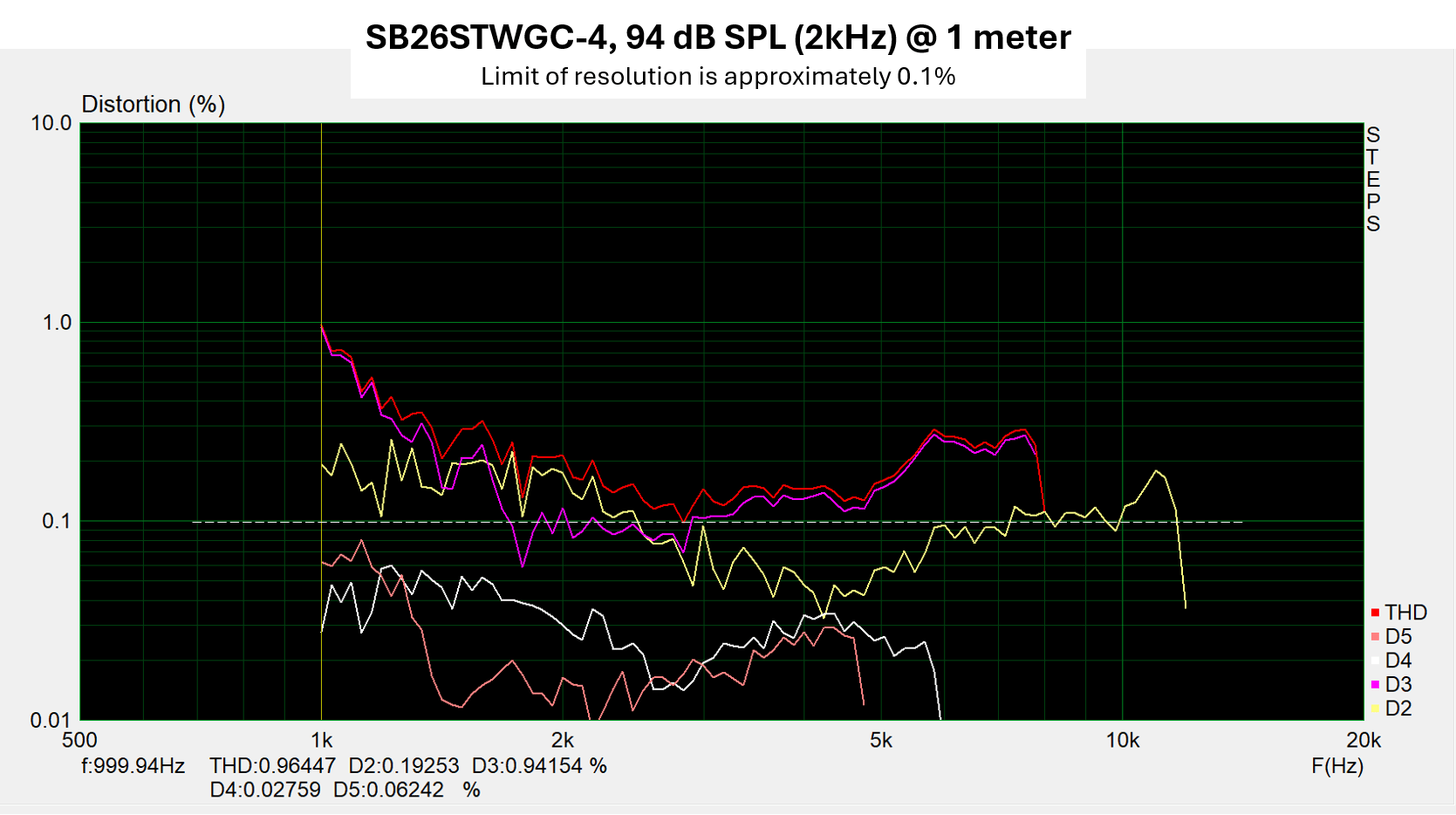

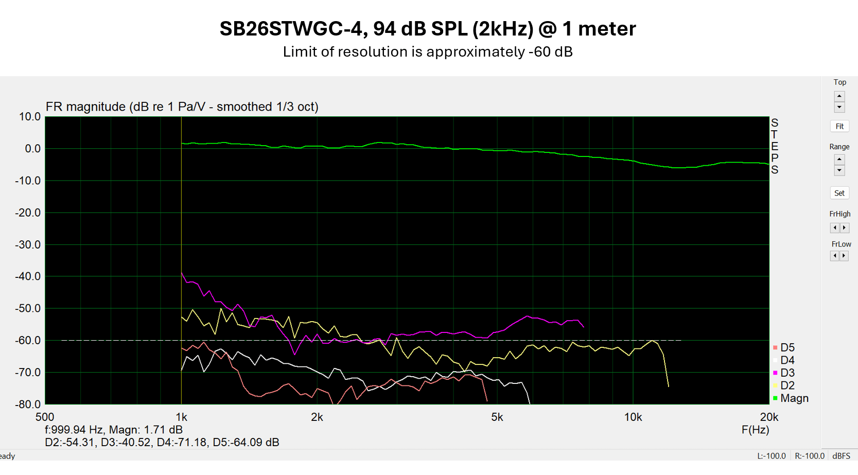

Here is some more data from vetting the tweeter. At this point I am completely satisfied with the performance of the SB26STWGC driver, and I will be using it.
All of these measurements were made in the XPS foam prototype shown in post #6. The distortion measurements were made at an SPL of 94 dB at 1 meter, but the mic was at 50 cm to get the best SNR. I added a dashed white line at -60 dB and 0.1%. Thanks to the work of @tktran303, I believe this is the limit of resolution for my test setup, both due to the noise floor and the inherent limitations of my microphone (Audix TM1).
The burst decay plot was produced from my 0-degree polar response scans: 1 meter, at about 1 Vrms which produced about 85 dB SPL.
