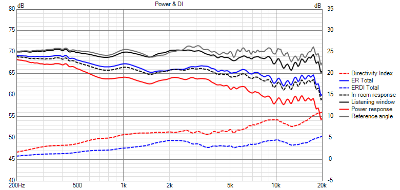

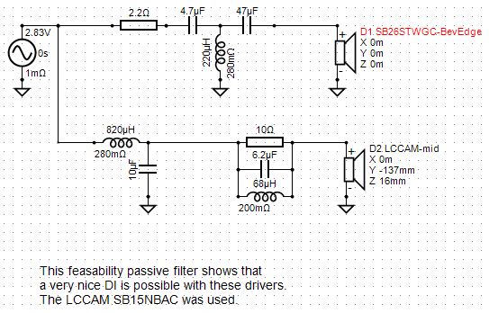

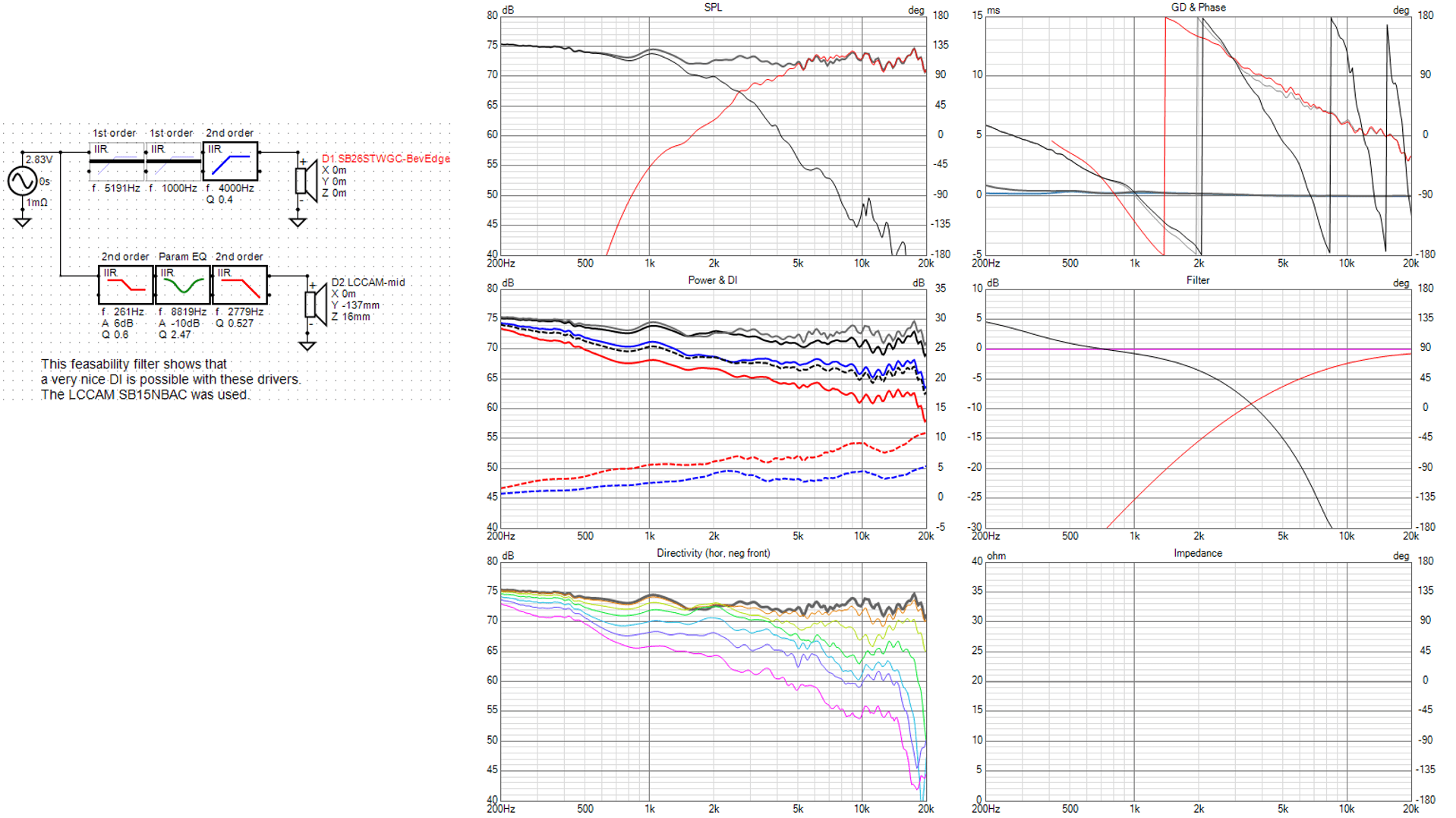

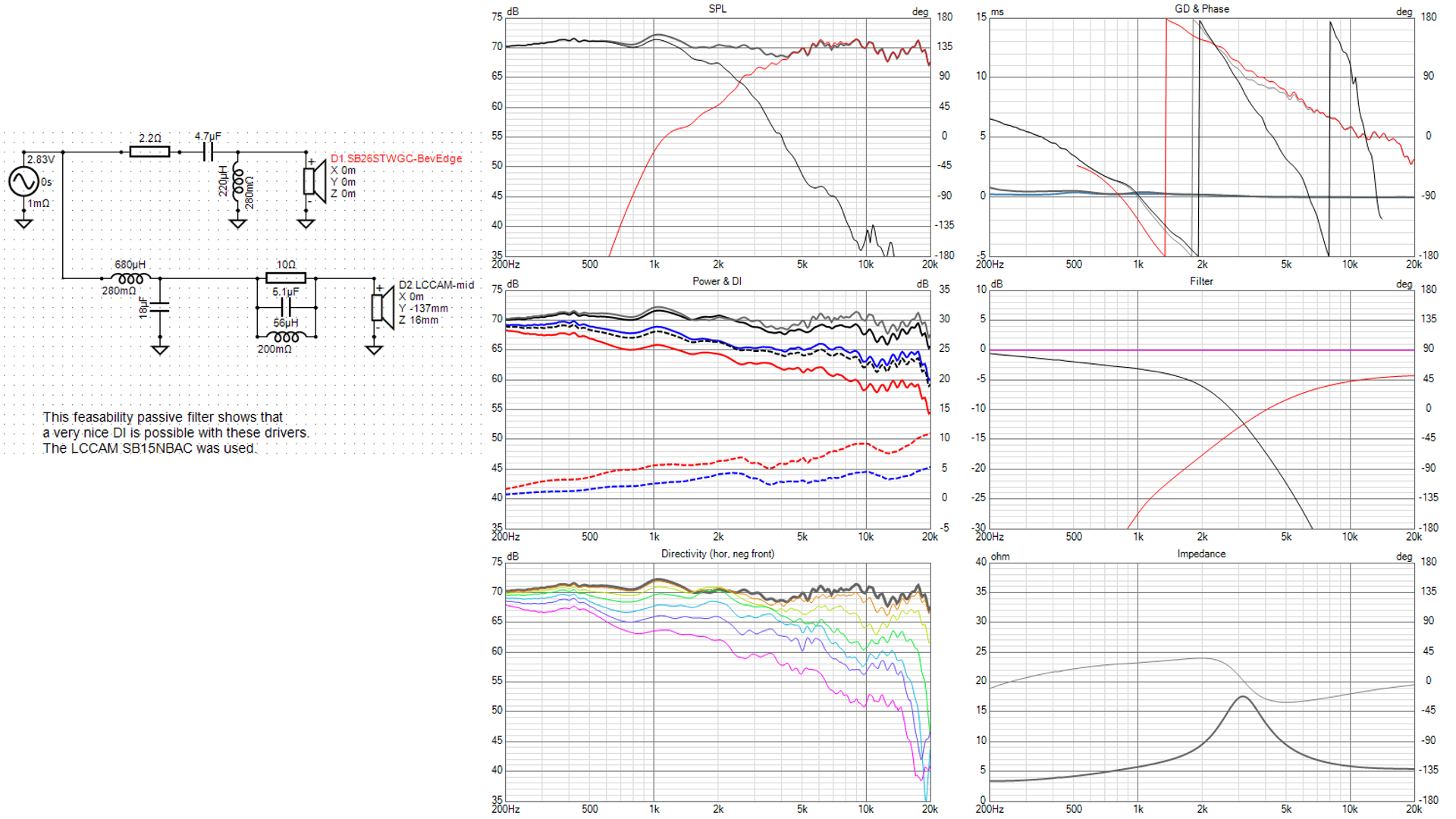

I have run some sims which seem to show that I can use 5" mid. The following VituixCad sims use the measured polar response of the SB26STWGC tweeter in the XPS foam prototype, combined with the measured polar response of the SB15NBAC30-4 driver in a cabinet of very similar width. This is a feasability study, not the planned implementation. All I am looking for at this point is a demonstration that I can manage the DI throught the crossover region, from approximately 1k to 6k
First, I implemented a filter using active components. The variation in DI from 1k to 6k is 1.5 dB
Next I implemented a filter using LCR components. I did not spend much time optimizing it, and I got a variation in DI of 2 dB.
So from a feasibility standpoint, I feel comfortable considering both 4" and 5" drivers.
Reactions: b_force

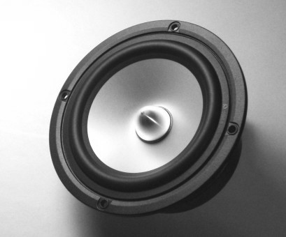

Second vote for ZA14. It's 8R
https://www.madisoundspeakerstore.c...aph-audio-za14w08-5-aluminum-cone-mid/woofer/
https://hificompass.com/en/speakers/measurements/zaph-audio/zaph-audio-za14w08
http://www.zaphaudio.com/ http://www.zaphaudio.com/ZA14W08/design.html
Problem when searching for mids is that "nominal diameter" is sometimes with the frame, sometimes radiating area diameter, or something between them. above 3kHz differences in response and directivity are huge! Surround shape, cone profile, dustcap/phase plug profile are very important. Specific mids tend to be smoother.
ZA14

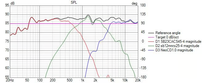

I tried using a aerogel Audax HM130-Z0 mid when I started designing a 3 way stand mount because I already had a pair. I finally gave up on it and used the SB Acoustics SB12MNRX2-25-04 instead combined with an 8 inch SB23CACS45-4. The main problem I had with the SB12MNRX2-25-04 was the 5 db wiggle at about 1.5Khz. I thought it was diffraction from my baffle, but in the end it seemed to be caused by the surround. The rough response of the HM130-Z0 was the reason I gave up on it, not to mention the difficulty I would have trying to flush mount it. Maybe the HM130-Z10 doesn't have the rough response I had with the HM130-Z0. Lastly, for Jim, the SB23CACS45-4 is a 4 ohm which he said he doesn't want. Here is the frequency response of the 3 way showing that I could not get rid of the 5db wiggle.
