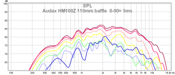

I have a pair of Audax HM100Z0 (NLA), Aerogel, which is close to 130Z0. No such wiggles, which are very bad with Vifa NE series
I tested them as narrow baffle dipole and finally used with a sealed box 3-way with LR2 acoustic (dsp)

Do you have some distortion measurements as well?I have a pair of Audax HM100Z0
