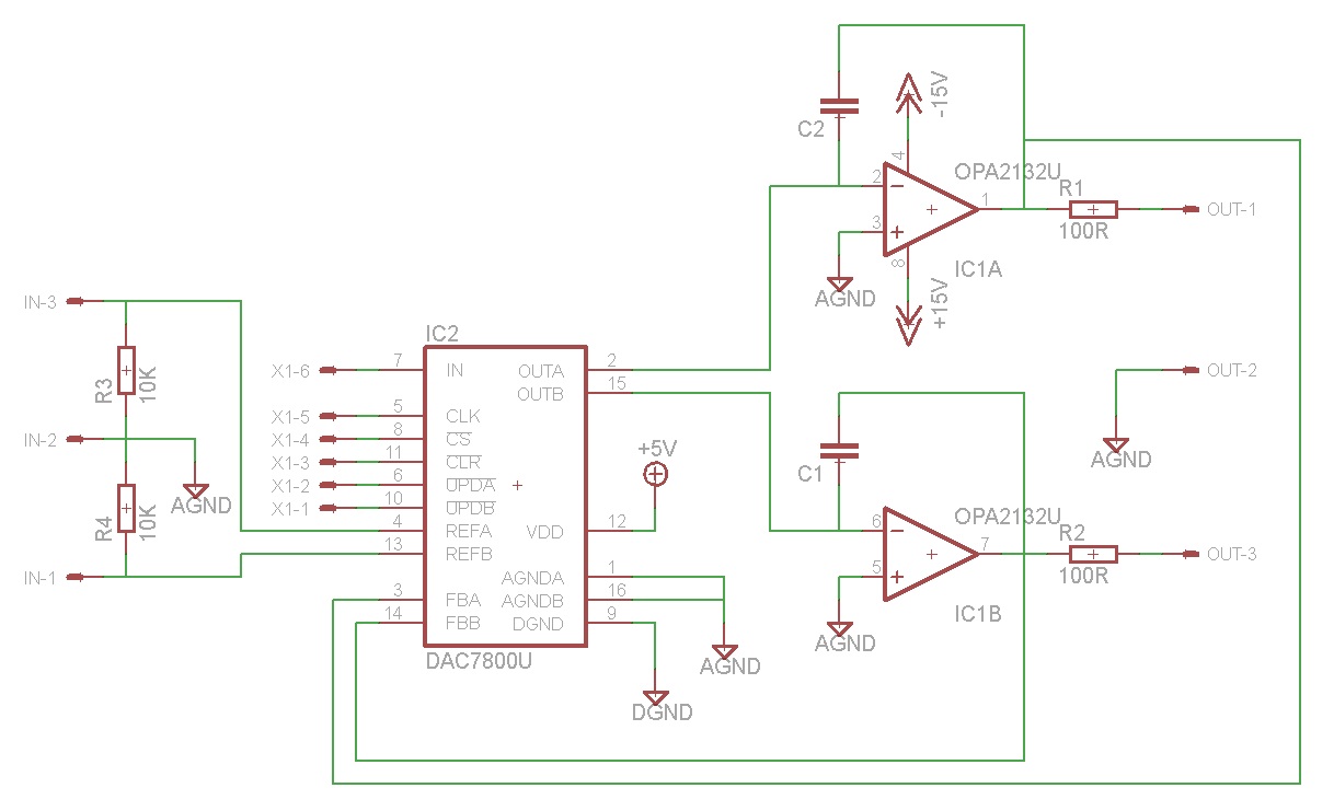

I've attached a schematic using a DAC7800 and a dual opamp.
What do you think? Anyone experimented with this? An SPI controlled 1024 step attenuator that is better and more flexible than a PGA2310 and easier to use than a CS3318?

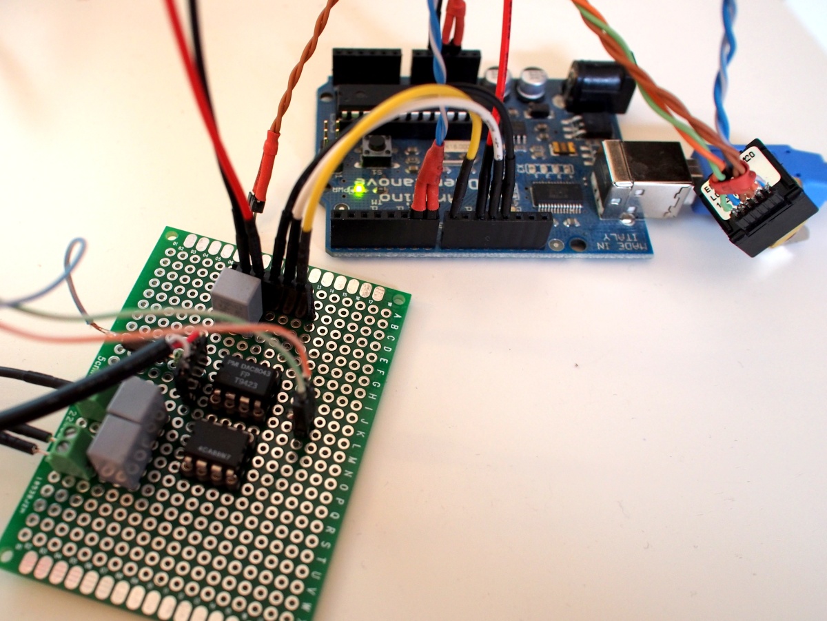

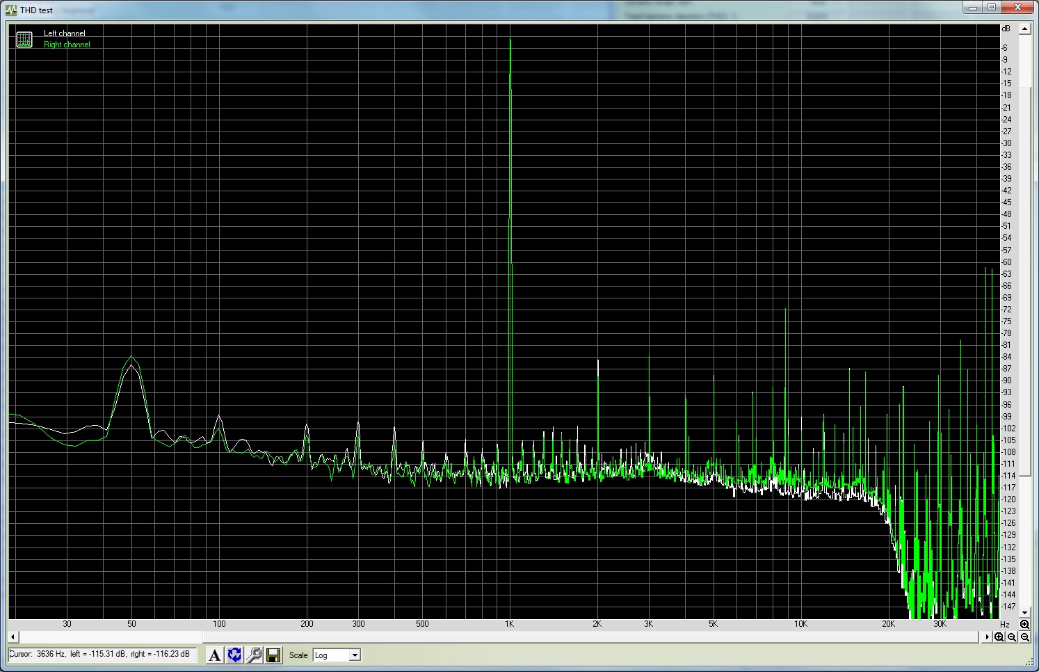

I got a DAC8043 from Ebay and used half of an OPA2132 to make the circuit posted above (Figure 3). I wrote some Arduino code to control the DAC to make a 4096 step attenuator!

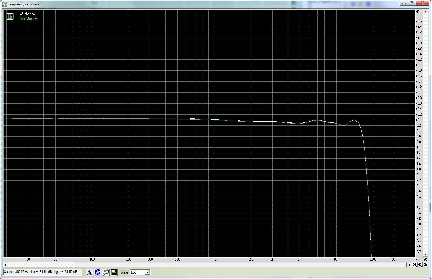

It works really well. I tested it with headphones and then ran some RMAA tests. These tests were just using the onboard line in from my motherboard so its not very good but allowed me at least some basic comparison. In the attached measurements the Left channel is just looped back and the Right channel goes through the R2R attenuator. Better than I thought it would be considering it was on perf board with long cables going everywhere and poor grounding arrangement.
I think I might now design a test PCB for a version with an AD5439 with ADuM7440 (SPI isolation).

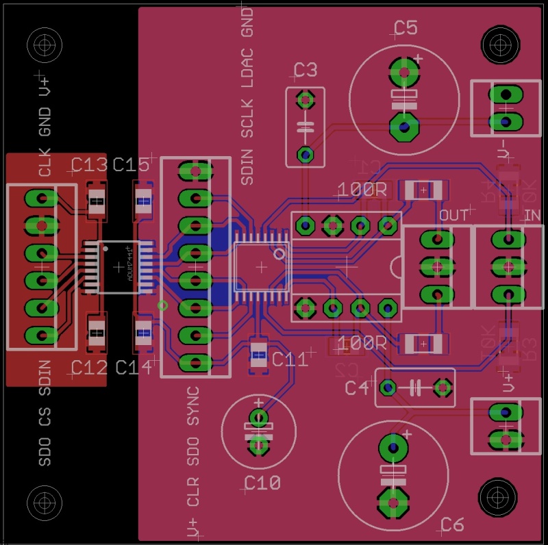

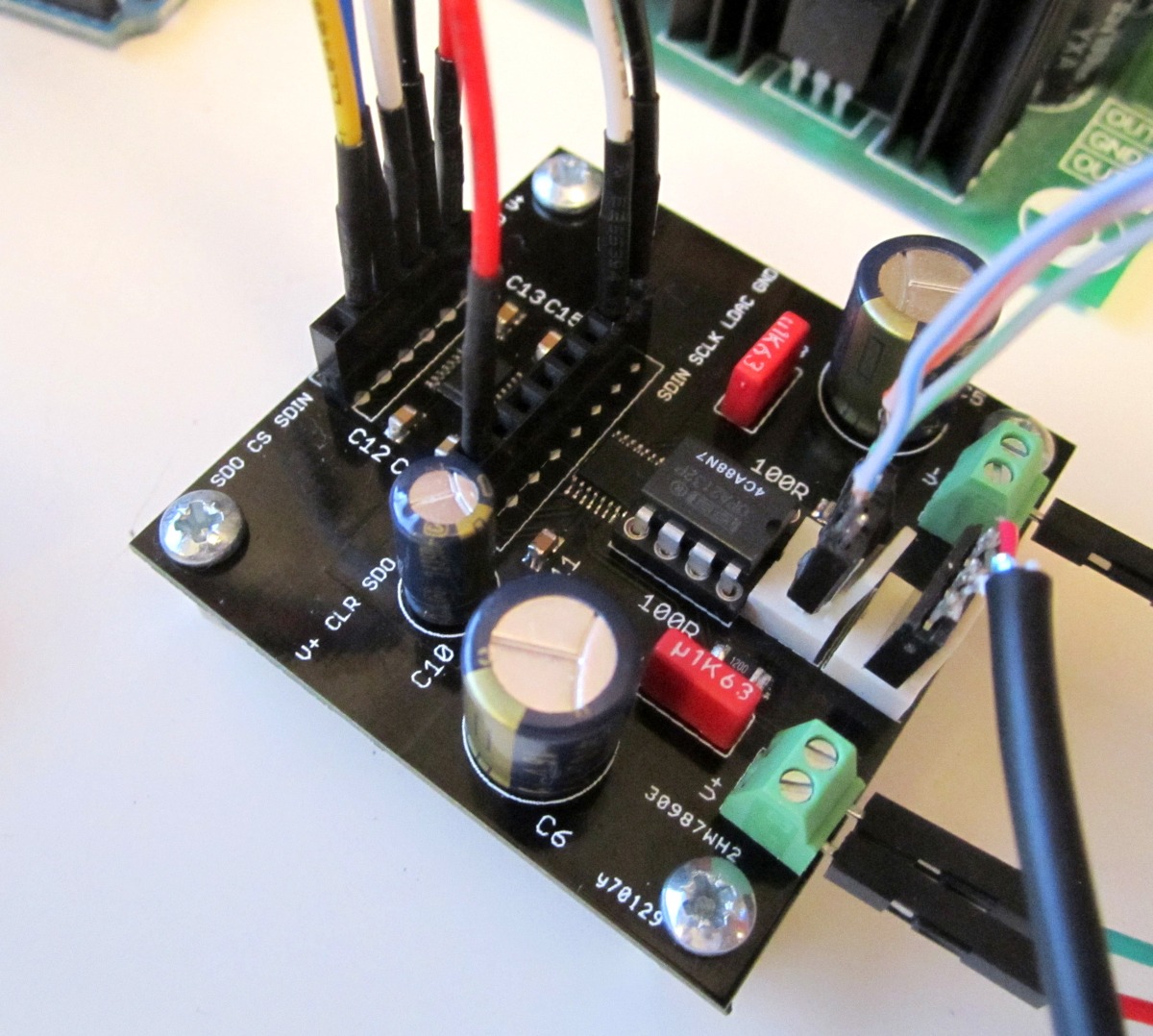

I've just designed a PCB for testing a AD5439, ADuM7440 and a DIP opamp. It's been sent to a PCB fabricator in China, should be back in a week or two.

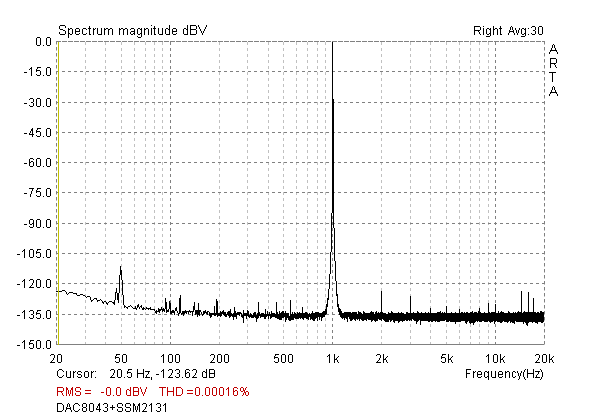

I used it since 2000 to 2005, with very good results, it is better than specialized IC´s (see attachment) like WM8816 or PGA. With stored table , 90steps about 1dB and mute it works very comfortable. Now I am using low impedance (1kohm) relay attenuator.
No problems with implementation (reset and mute at turn on for 1-2 seconds), also no galvanic isolation from microcontroller. But analog and digital grounds connected only in one point, as close as possible to noniverting inputs to OA.

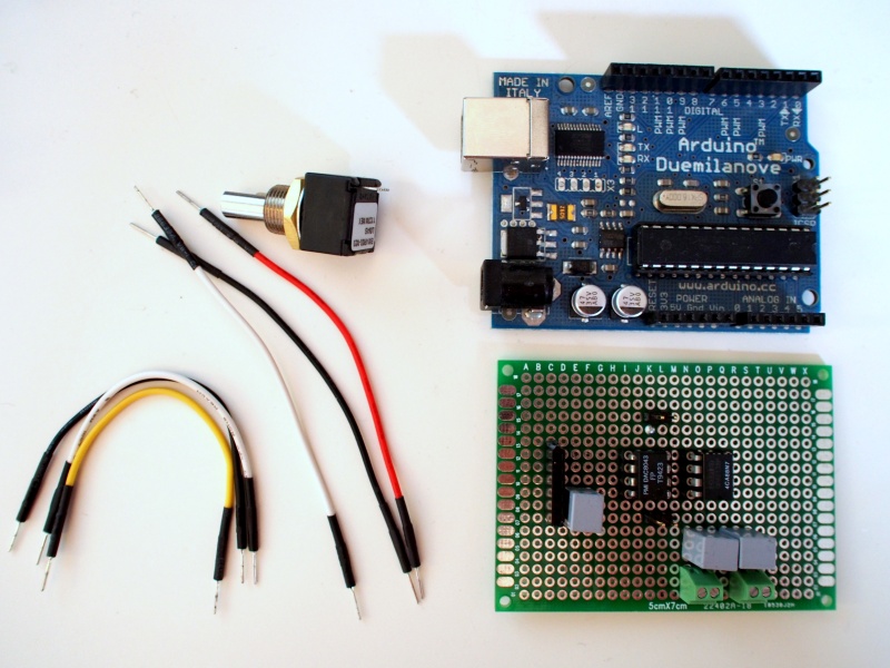

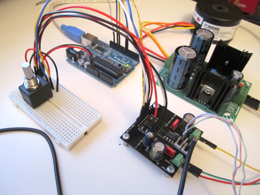

Got the PCBs, put them together and wrote some Arduino code and tested it just now. It works! Smooth volume changes, no clicks or pops. I've only tested with headphones though. Haven't taken any measurements yet and not really sure my equipment is worth using for measurements anyway. Will do more testing in the coming days 🙂
