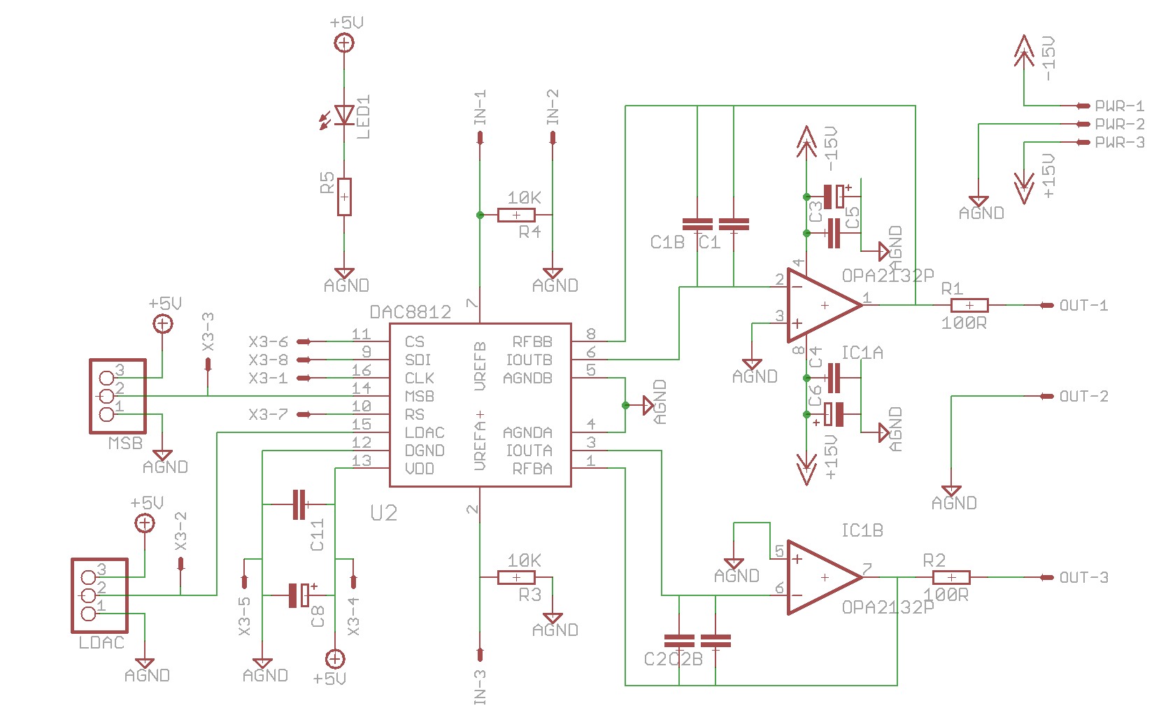

I was looking at the Muses72320 schematic and had the idea that two dacs could be put in series maybe with a buffer between to get more range. Still armchair-engineering this I wrote a little 100 line java program to find the most linear (logarithmic) steps.
idealDBs = ideal decibel attenuation
idealAttens = ideal attenuation
trueDB = the best real decibel attenuation value found
trueAtten = the best real attenuation value found
err = The err in attenuation
D1= value of dac one
D2= value of dac two
idealDBs=-1.00 idealAttens=0.89125094 trueDB=-1.001 trueAtten=0.89119212 err=0.00 D1=4091 D2=3653

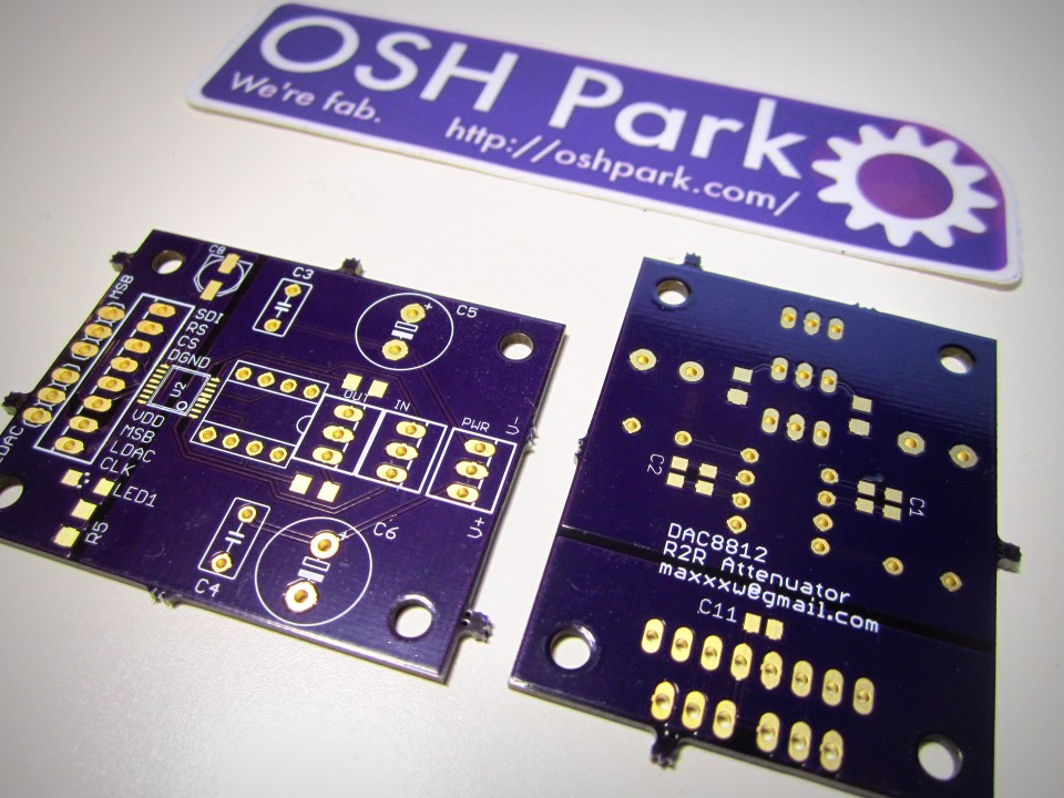

Bit of an update...
So I had a go with the AD5439 but after a period of time the IC would just stop responding to serial control. Strange, it would work for a while and then just stop. Not sure why though.
Anyway, so I moved on and made a design using the DAC8812, which is a 16 bit DAC and gives 65536 steps. I designed the PCB in eagle and then used OSH Park to get it fabricated. I can't recommend OSH Park enough! They are really cheap, pretty quick, really good quality and super easy as you don't have to generate gerber files.
