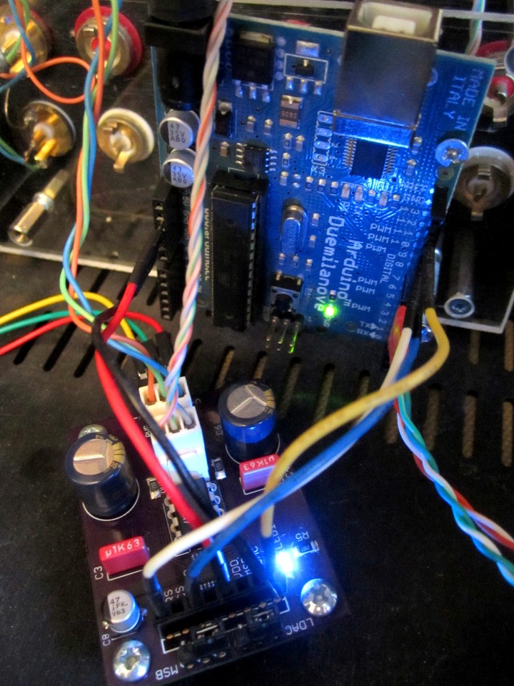

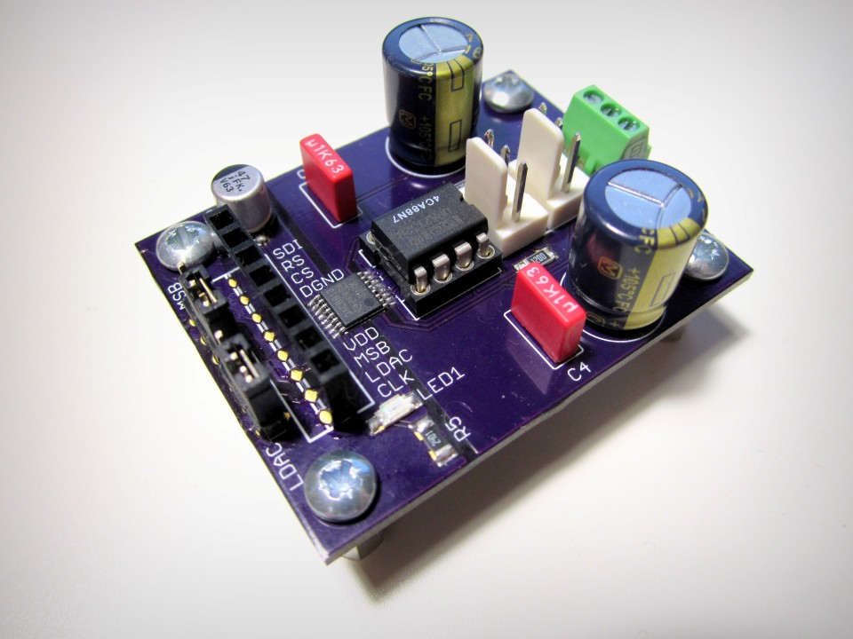

I've been testing the DAC8812 based module for the last couple days and it's really good:
- No clicks, pops or any noise.
- Drives my headphones really well.
- Sounds good!
I also used it as a preamp for some UcD180HGs and it sounds and works well.
My current code: dac_level = 65536*(pow(10, (dbLevel/20)));
Gives ~300 steps at 0.25dB or ~160 steps at 0.5dB.
It's not exactly log but it works perfectly fine. It's really fast to make changes, no delay at all.

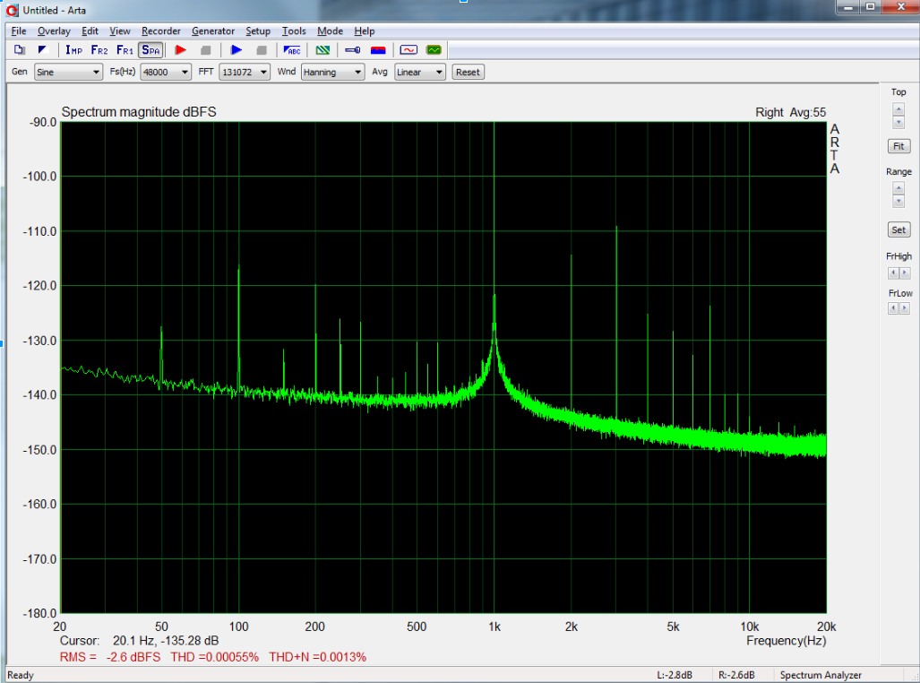

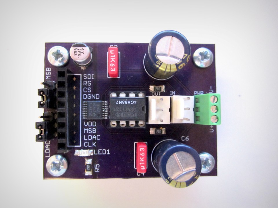

I designed a version with gain in the I/V stage, 12dB. It works really well. I also used an ADUM7440 for SPI isolation from the Arduino. I've taken measurements using my E-MU 0404 USB and it measures better than a PGA2320 🙂
