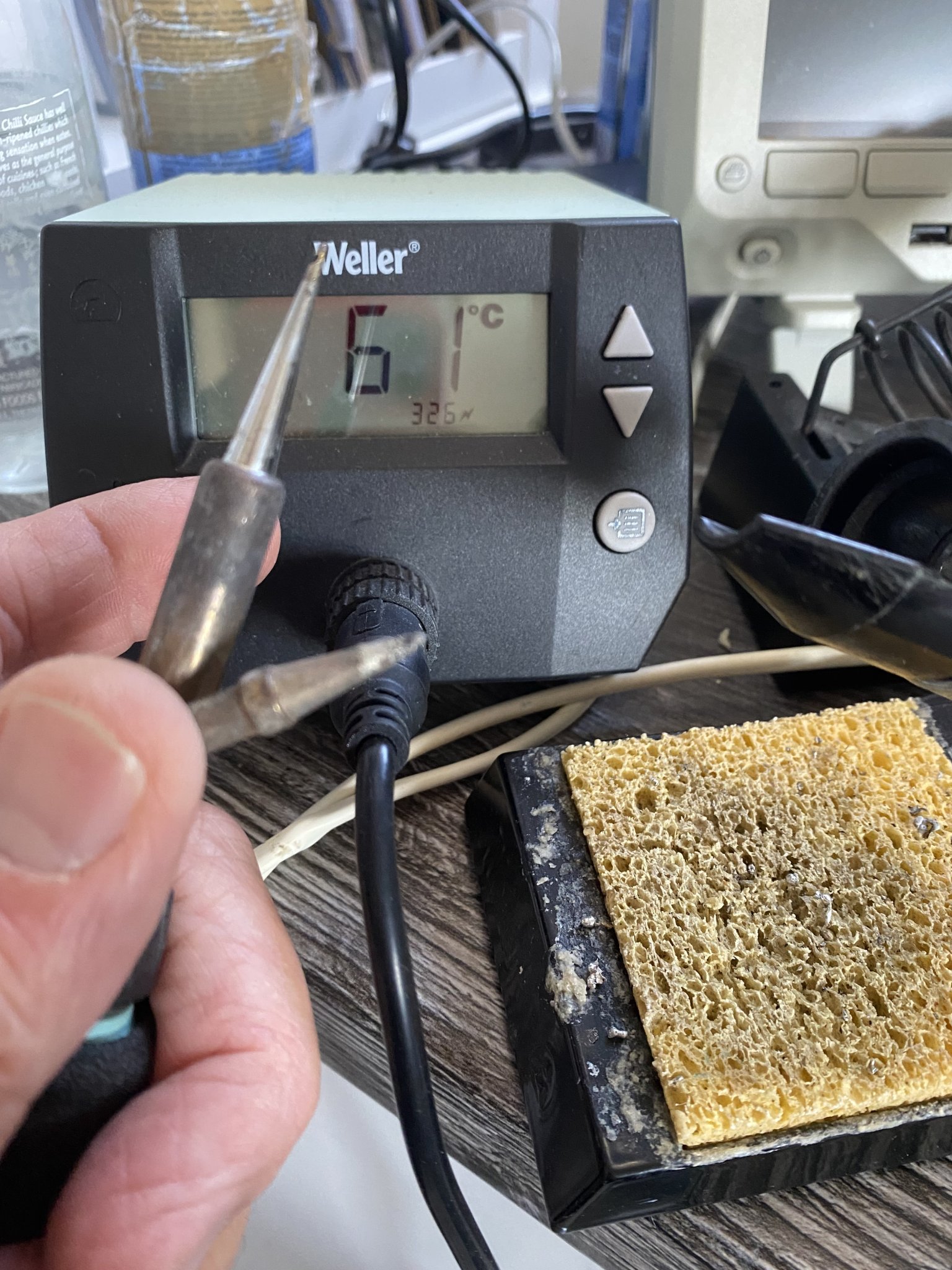

I’m getting great joints with the tip temp set to 325C. Solder flows well and 0805 and leaded components soldering well. I turfed the old bit and put a new one in - the high temps really ruined the coating on it.
Reading your posts has made me look again at my tip temperature settings. Consequently, I realised my current 350C is a leftover from when I was using lead-free solder.
When I switched back to SN63 leaded solder, I didn't reduce the setting accordingly (lead-free typically needs around 10-15C higher temps than leaded). While I'm getting good results, the flux tends to burn off quicker than I'd like so I'll drop my temp back down to 325C for my next run at soldering. Lets see how we go.

Here are Weller the tips I’m using- a conical for SMD and 3mm chisel for THP.
