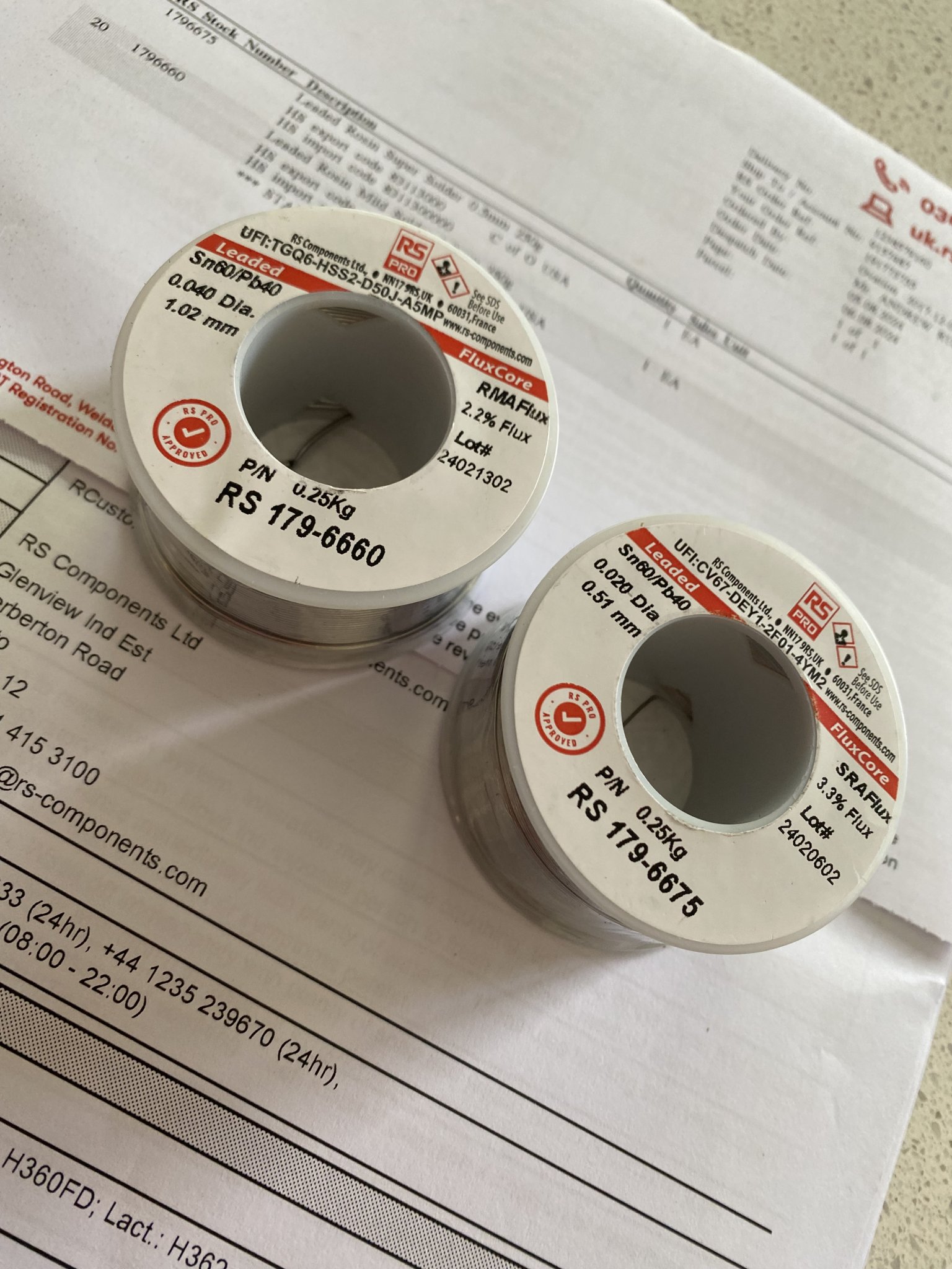

Leaded solder has arrived. 183 C melting temp. Hopefully my problems will now be over!
I thought your problem was the tip and not the solder? I have the same problem with those Weller pencil tips regardless of solder. Also why did you chose RMA/SMA flux core solder and not no-clean? Thus you need flux remover for RMA/SMA type flux.
Good luck
Good luck
I just wanted a low melting point solder so that's what I could find. I have about 3 cans of flux remover 😉
