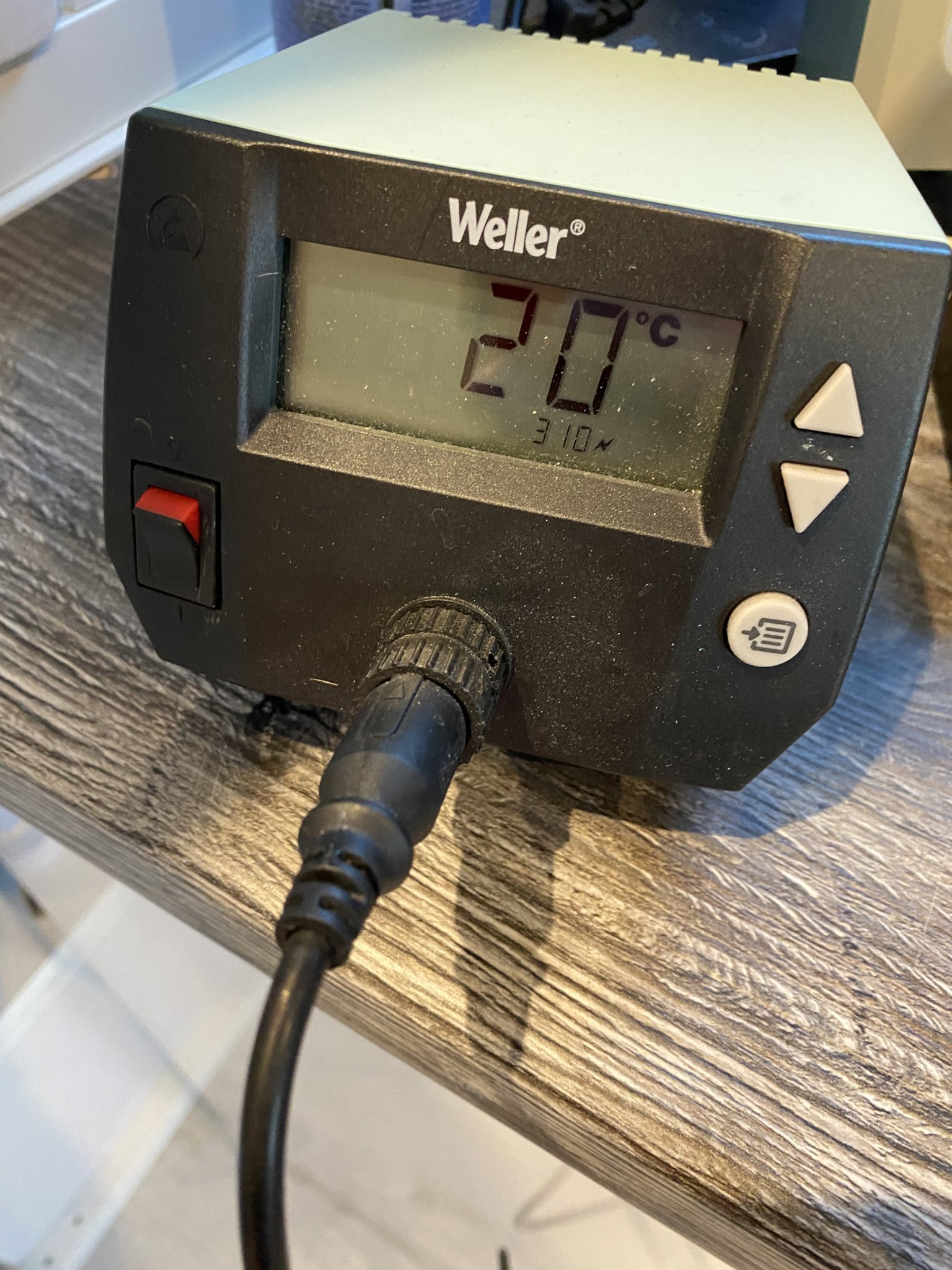

The Weller solder in Post #1 is this stuff: https://www.weller-tools.com/us/en/...ering-wire/wsw-scn-m1-05mm-100g-sn06cu005ni35. It's 99.3 % tin, 0.6 % copper, and 0.05 % nickel. That's similar to AIM 100C and ChipQuik CQ100Ge. That's actually the best lead-free solder out there. It's an eutectic alloy. It behaves almost like 63/37 Sn/Pb. I use it with an 800 ºF (427 ºC) soldering tip. That'd be a #8 in the Weller WTCP system.

Problem is Marcel I’m putting down 0805 and 0.5 mm pitch IC’s. This is s new problem for me since I never used to have this issue. I guess it’s down to the solder and getting the temp right. That said, I’ll ditch the stuff I have now and try one of the recommendations from fellow diyers.I always use the wedge-shaped bits. I never managed to get anything soldered properly with the needle-shaped one, no matter what the solder or the temperature may be.

Tom, I’m using a temp controlled ironThe Weller solder in Post #1 is this stuff: https://www.weller-tools.com/us/en/...ering-wire/wsw-scn-m1-05mm-100g-sn06cu005ni35. It's 99.3 % tin, 0.6 % copper, and 0.05 % nickel. That's similar to AIM 100C and ChipQuik CQ100Ge. That's actually the best lead-free solder out there. It's an eutectic alloy. It behaves almost like 63/37 Sn/Pb. I use it with an 800 ºF (427 ºC) soldering tip. That'd be a #8 in the Weller WTCP system.
I use a tip temperature of 700 ºF (371 ºC) for leaded solder. So a #7 tip in the WTCP system.
I wonder if the flux has dried out in that spool of Weller solder. Try cutting off a length of about 50-60 cm and see if the fresh solder on the spool will wet properly.

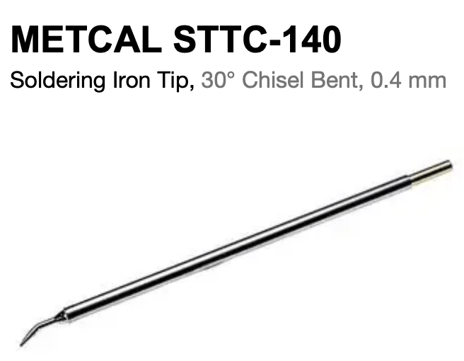

I'd use either a tiny chisel tip (0.8 mm wide) or a bent tip for that. METCAL has some bent tips like this one:0805 and 0.5 mm pitch IC’s
