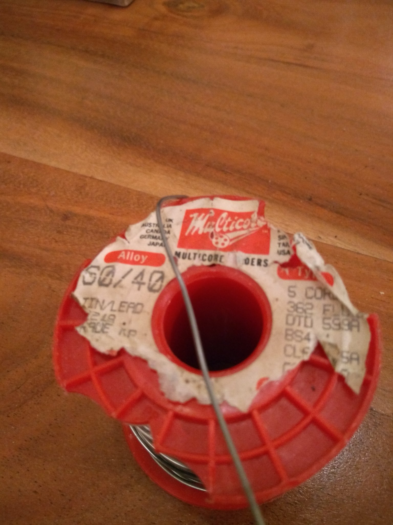

I use Multi core 60/40 for at least 50 years (partly professional), luckily have a few left. The one pictured is some 40 yo and nothing wrong with it. Together with a chisel like tip in an unregulated soldering iron 30 Watt and plenty additional flux I can solder SMT IC's with it. The flux is important!

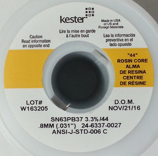

This is what I use,
