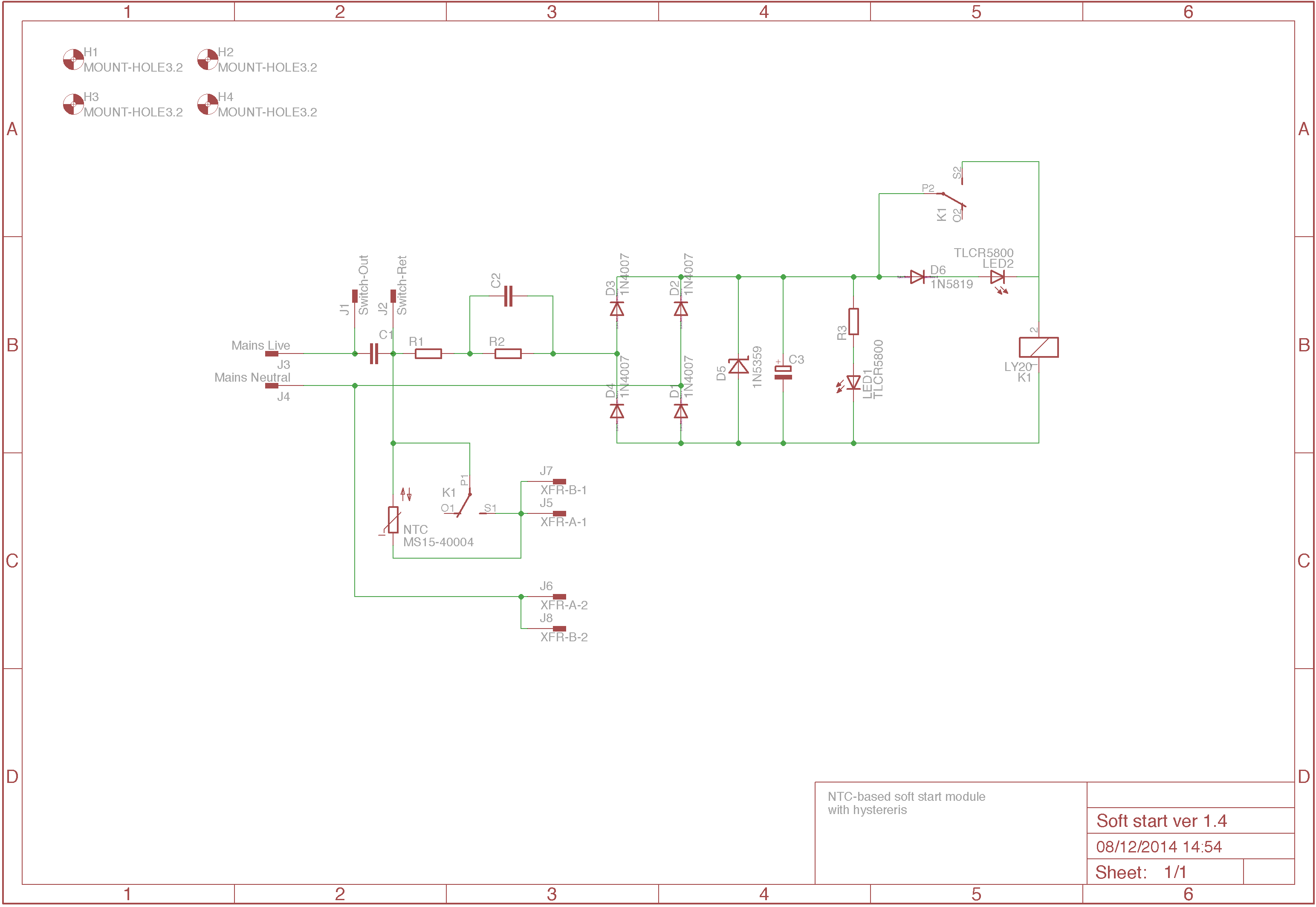

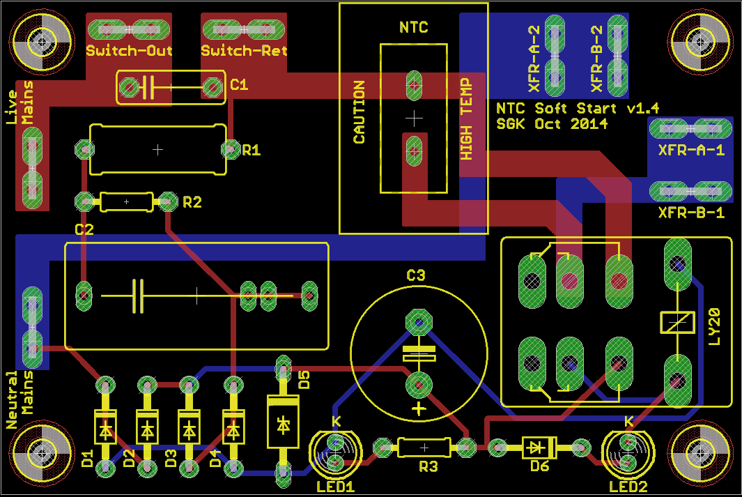

Quite some time ago, I promised to post the Gerber files for the NTC-based soft start module I made with help here. I am finally doing so. Feel free to use but entirely at your own risk. This is a live mains voltage project. I have included the BoM that I used for my project in the zip file. Also, here is the link once more to the soft circuit LTspice models I made. Anyone using the PCB will have to verify that the circuit timing/part selection is suitable for their mains supply voltage and project.

You know, in hindsight it might have been smaller or more elegant, to use a 4-diodes-in-one-package bridge rectifier instead of four 1N4007s. Here we see a 1.5A, 1000V bridge in a dual inline package. It would be perfectly adequate to drive the coil of a relay and an LED.
I think I will leave that change to the next person - if it helps I can post the board and schematic files from Eagle.
PS: The TLCR5800 have notches in their legs which I presume is intended to elevate the LED off the board. If I have this incorrect please don't hesitate to let me know.
It is your choice how high off the board you mount the LEDs. If Vishay put their little tabbie-thingies in a useful place, that's serendipitous good luck. If not you can ignore the tabs, or modify the drill hole size, or grind off the tabs with a Dremel tool before stuffing. Don't allow Vishay to dictate how you deploy their product once you've bought it. You are the designer and you make the choice.
Silly/basic question (but given safety is paramount I will ask it to be sure): should the fuse be placed (a) between IEC inlet and soft start board, (b) soft start and switch, or (c) between soft start and transformer? I assume (a) but would prefer confirmation from more experienced users...
Ok I just got a bit of a surprise when I tested the board in post #268 (circuit in #267). I wasn't expecting any of the LEDs to light up until the switch was closed. Instead they're both lit when the switch is open. Closing the switch brightens both until LED2 is bypassed (along with the NTC) and it extinguishes.
Am I misunderstanding the impact of C1 in an AC environment or do I have a problem? Either way, it wouldn't seem ideal as presumably C3 has some charge and so the circuit will trip sooner than desired?
You simulated this numerous times. What was the simulated value of current that flows thru capacitor C1 when the switch is open? What was the simulated value of current that flows thru LED1 when the switch is open? What was the simulated value of current that flows thru LED2 when the switch is open?
Are the simulation values of LED current, sufficient to light up a real LED? You could try it on the bench with your adjustable DC power supply, a 10K resistor, your digital multimeter configured as a milliammeter, and a matching LED.
You could experiment on the bench and find out how much current you can squirt thru your LEDs and yet still perceive them as "dark". Then use this as a new design constraint to find new values for C1, C2, R1, R2 which keep the LEDs "dark" when the switch is off, yet which pull in the relay when the switch is on and the mains is 10% low and all resistors are at the upper limit of their resistance and the relay coil is at the lower limit of its resistance etc.
