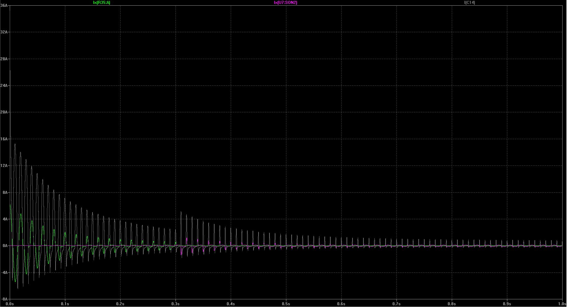

A soft start is nothing other than a current limiter. You can place a current limiter wherever you choose - either permanently or temporarily by switching it out after time x - for whatever purpose you need.
To avoid continuous repetition....
Let's say you like Mundorf M-Lytic smoothing caps. Big fat ones. 22,000uF with a rated ripple at Tmax and 100Hz of 5.4A. Over what time period would you measure RMS current through the capacitors to see if it fell below their ripple rating? The first second, half second, some shorter period? Recognising that the longer the period the lower the result.
I have attached some outputs from the simulation of a power supply I have been working on. It has two 21H transformers and over 0.2F of capacitance to be charged. It includes my current limiter circuit. Peak UK mains supply (358V peak) and 90 degree starting phase for worst in-rush.
Green is the primary side current going through the NTC. Pink is the primary side current going through the NC contact of the relay. You can see that the current limiter switches out after 300ms. At this point the NTC is still restricting mains current flow. Grey is the current through the first-in-line caps (i.e. those taking the brunt of current flow.
Have I exceeded the 5.4A ripple rating of the caps?
RMS current through the caps simulates as:
Over first second: 2.534A
Over first half second: 3.573A
Over first quarter second: 4.951A
Over first 100ms: 7.35A
