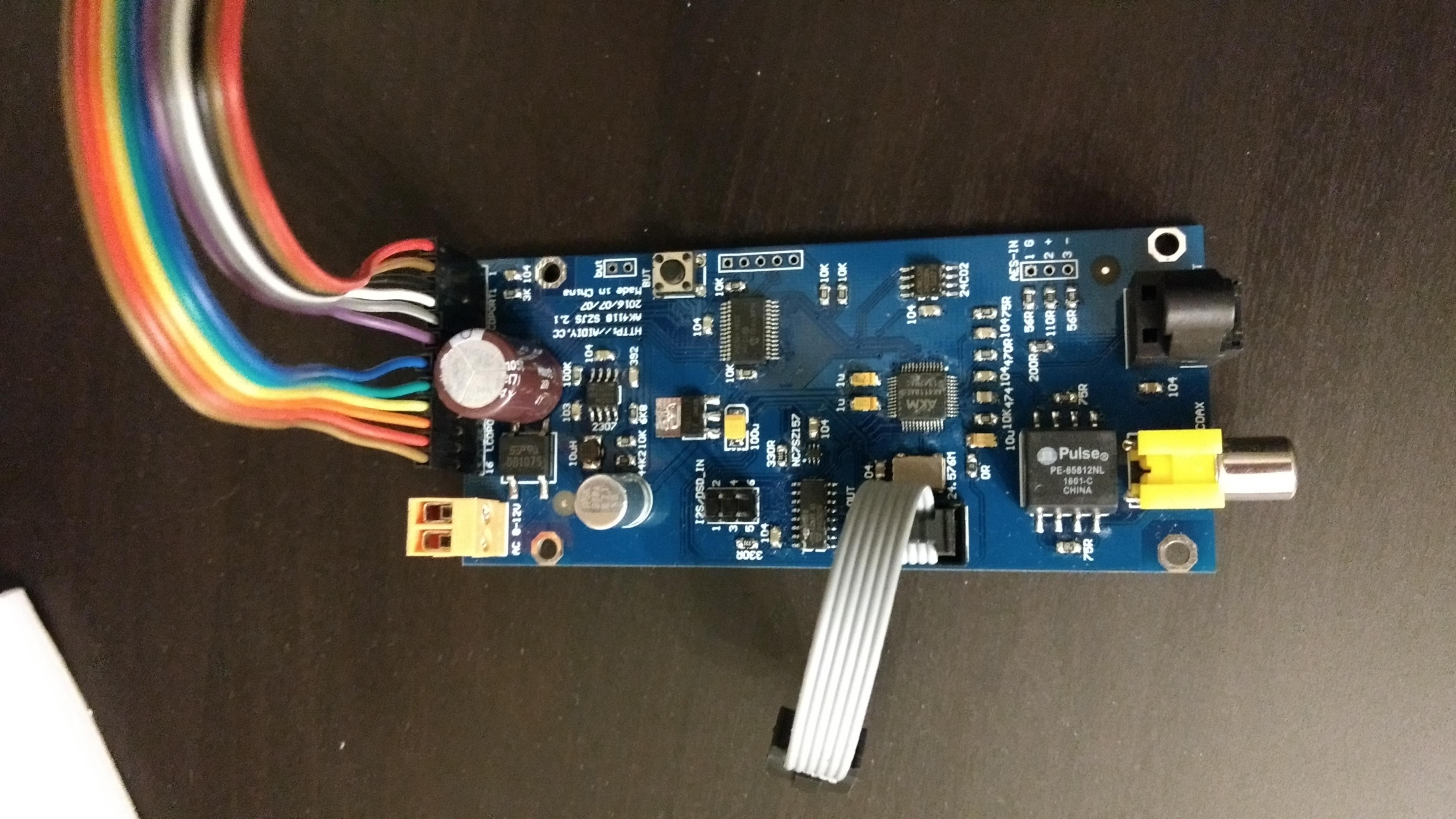

I'm thinking of using this board to provide the I2S input to the DAM board, should I attempt to find a 3.3V output from it/do you have any advice on using a board such as this please?
http://www.diyaudio.com/forums/digital-line-level/267948-soekris-s-dac-implementations-100.html#post4984687
