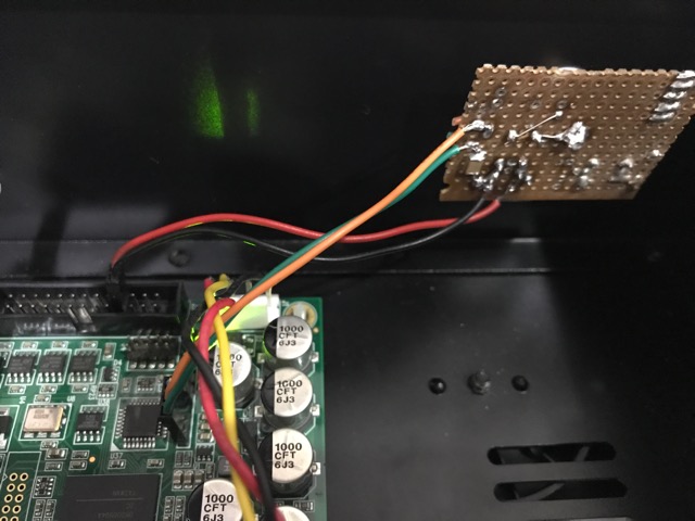

My dam1121 has a problem with locking to signal from coaxial input. I built the input circuit with a pulse transformer as recommended by Soren including 1k resitor connected to 1.2V and 0.1uF to ground.
The DAC is playing but it loses locking every few minutes. I am not sure if there is any problem with impedence matching due to my bread board implementation. Should I arrange the pulse transformer close to the the dac board or close to RCA socket?
Anyone has an idea about the potential issue? I have attached a photo.
