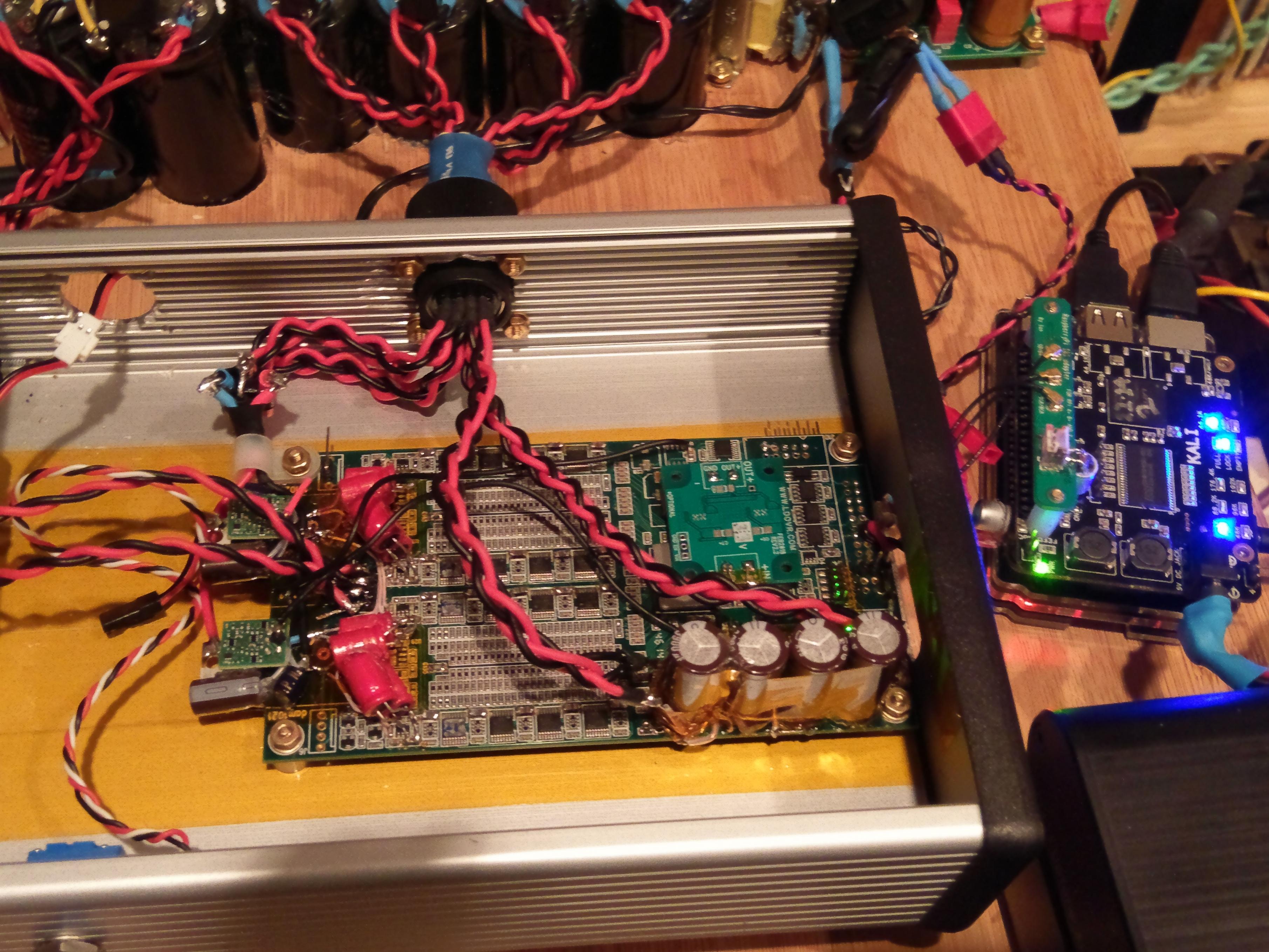

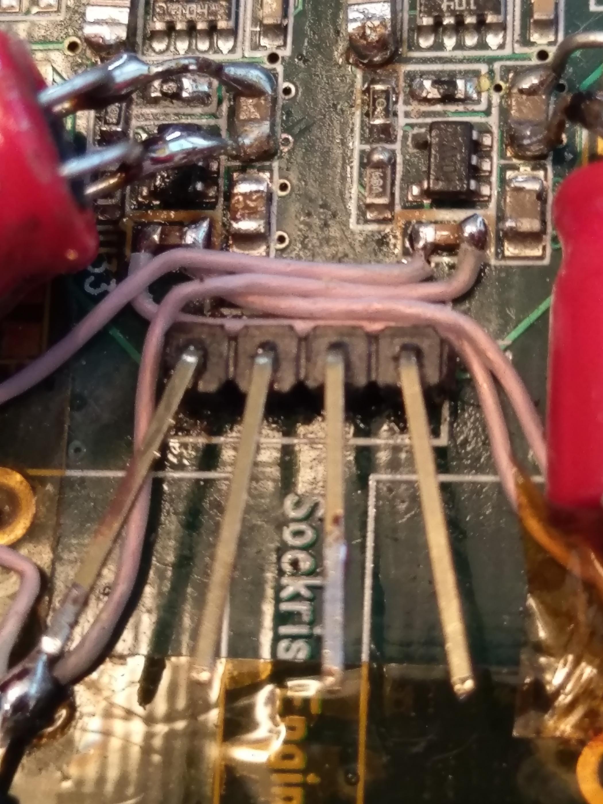

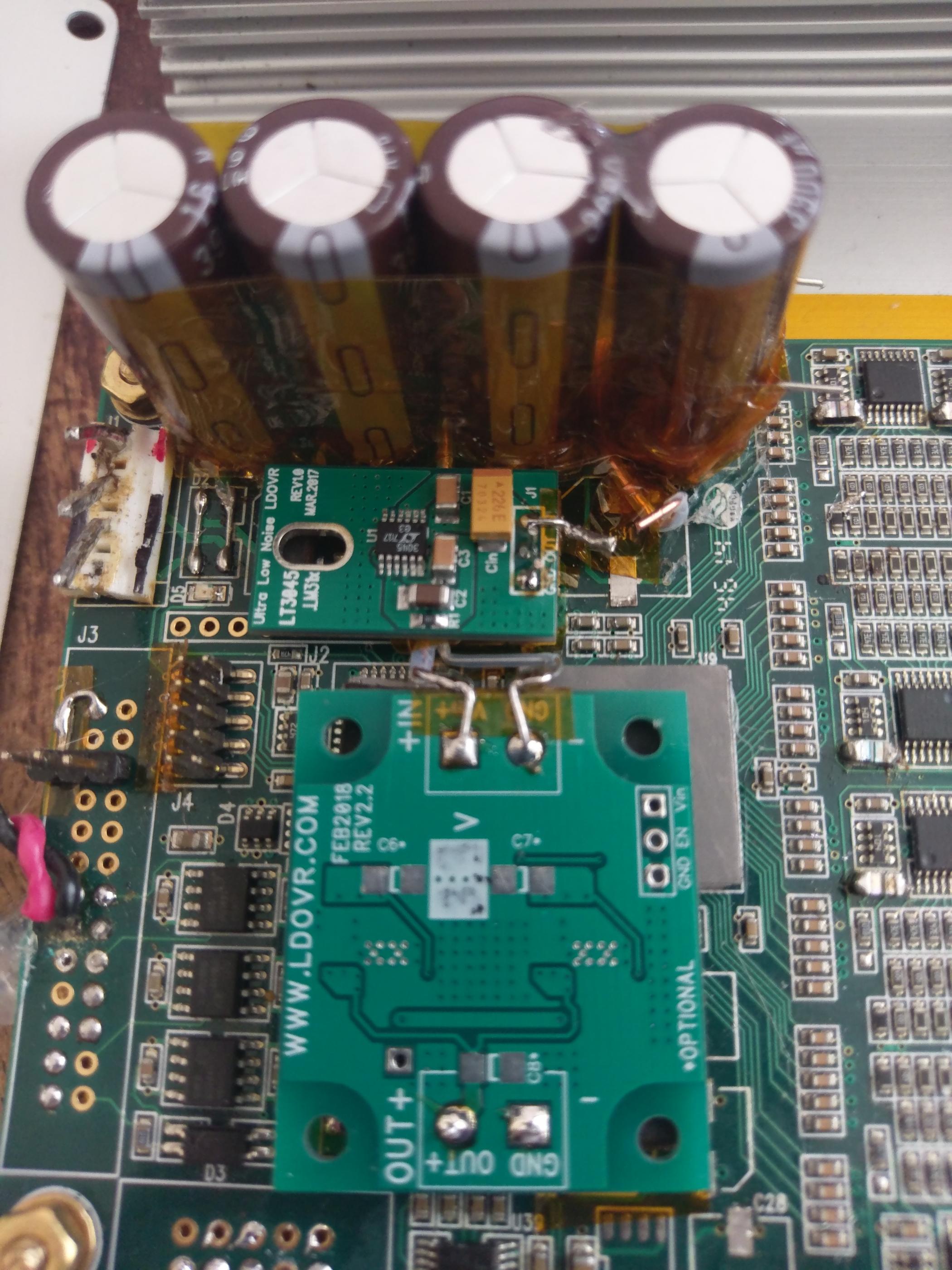

I just recently modified my 2 Soekris DAM1021 Rev1 DAC setups and thought others might be interested.
The recent mods are to replace all of the on-board regulators with upgrade units... starting with replacing the FPGA 1.2V regulator with an ldovr.com LT3045-based board and the FPGA/clock/other digital circuits 3.3V with the ldovr.com dual LT3045 board for a full 1A capacity. Each of these rails would now be fed from a separate power supply... overkill, but I'm into serious overkill!

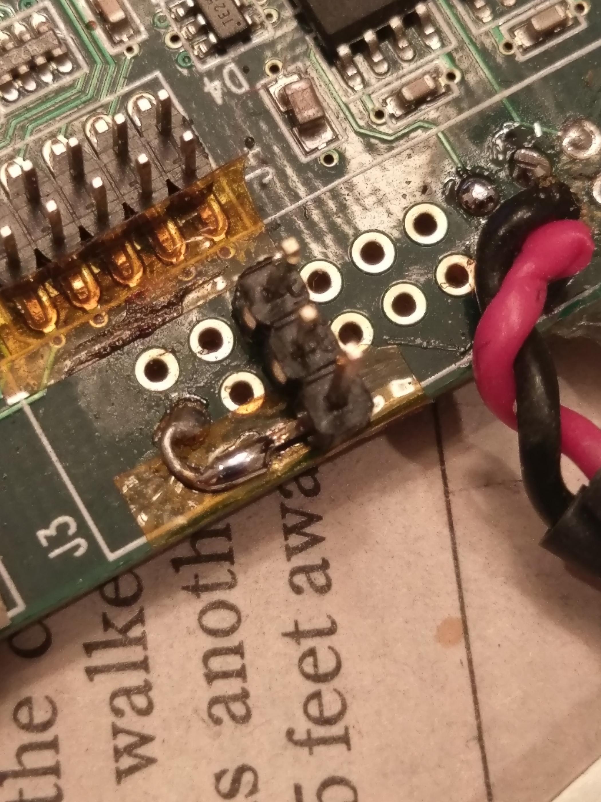

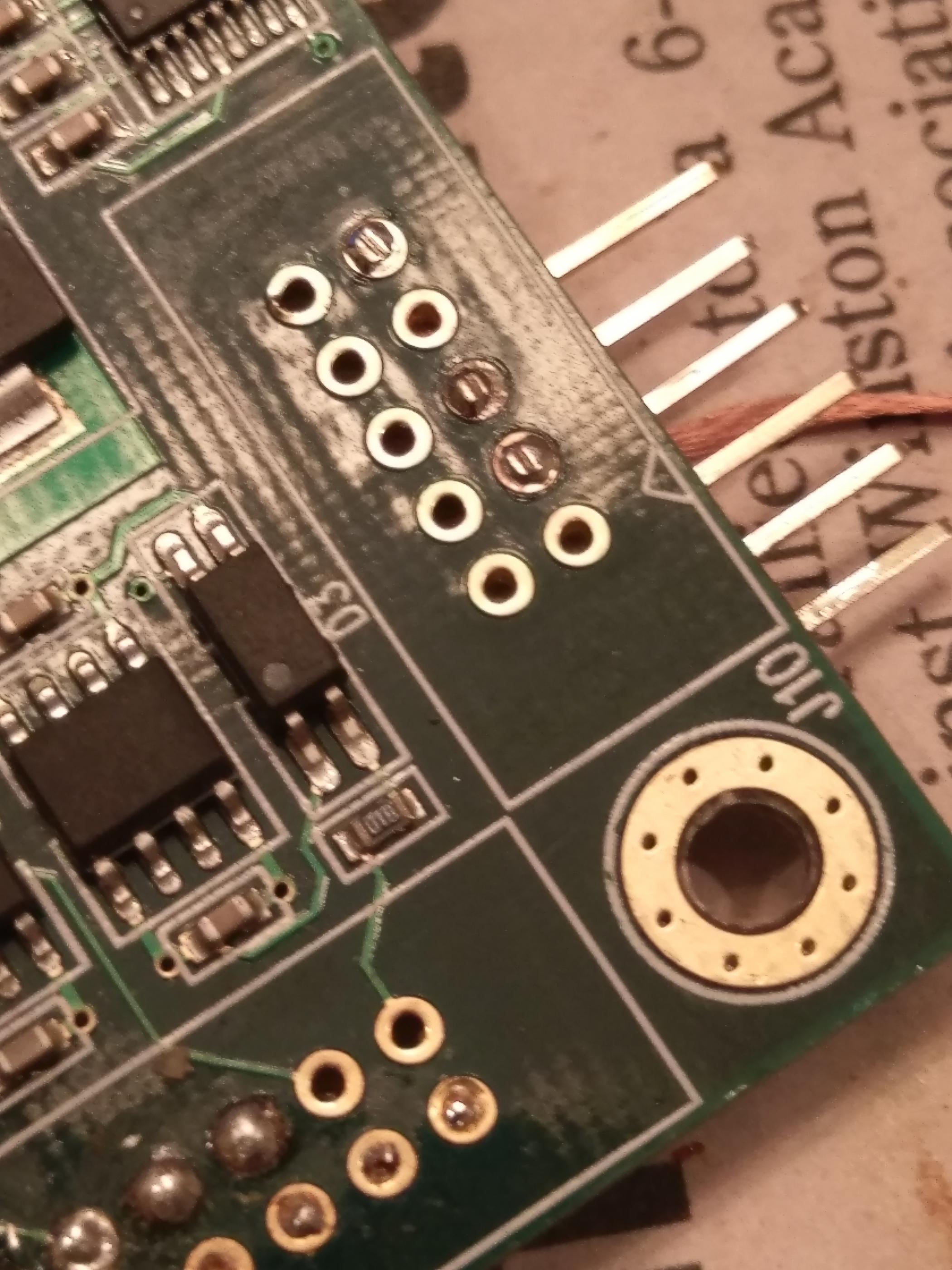

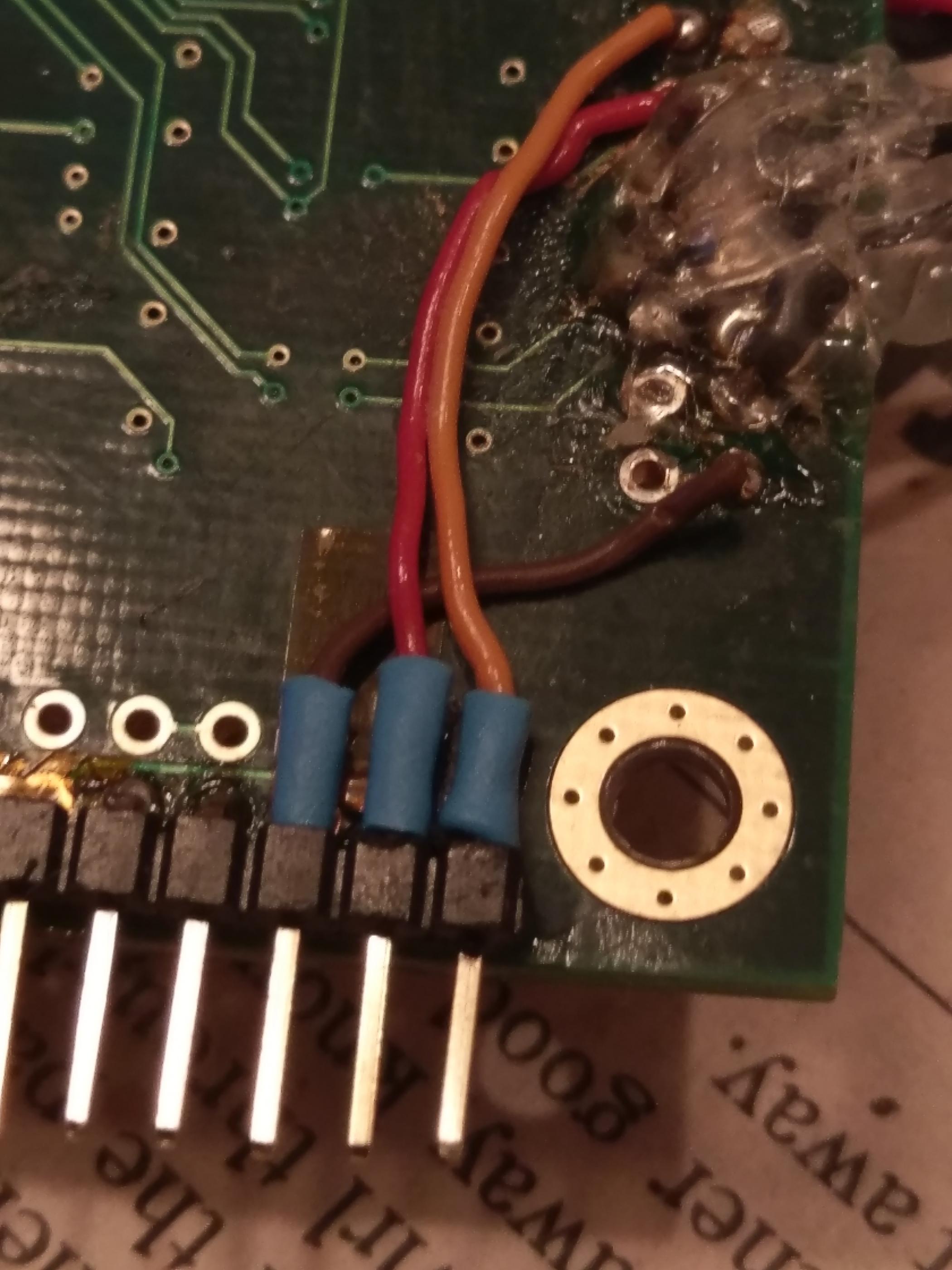

In preparation for the mods around the processing side of the board I restructured some of my original implementation details such as my isolated and non-isolated serial port connections and the connector for the volume control pot (which I re-configured to make it the same as on the Twisted Pear Buffalo-IIIPro board, as I use the same cases/bases for them and didn't want to damage a DAC board if I swapped it into a case/base previously occupied by the other and didn't remember to swap the VC connector leads).
Back to the regulator mods, I took a great deal of care to keep the regulators close to the original feed points and the connections short. The ldovr.com boards made this work well and were a good alternative to the OPC dual 4||LT3042 boards (sadly no longer available) I had originally planned to use for these positions, as those would have required much longer leads.

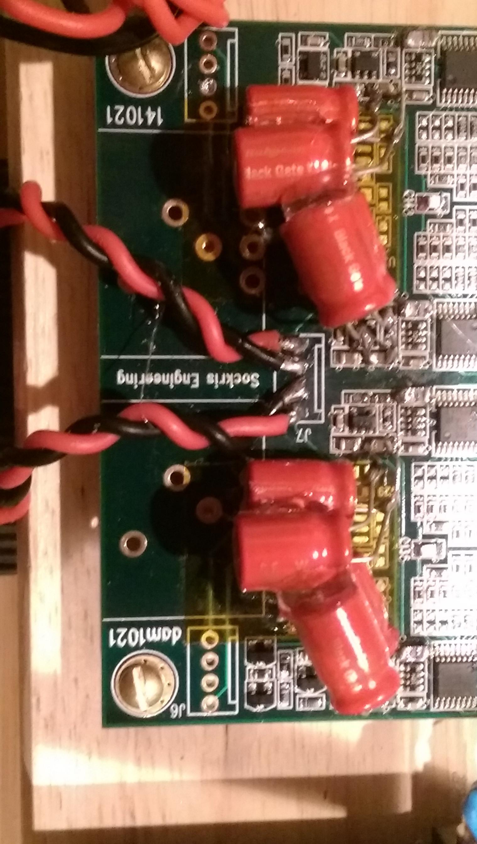

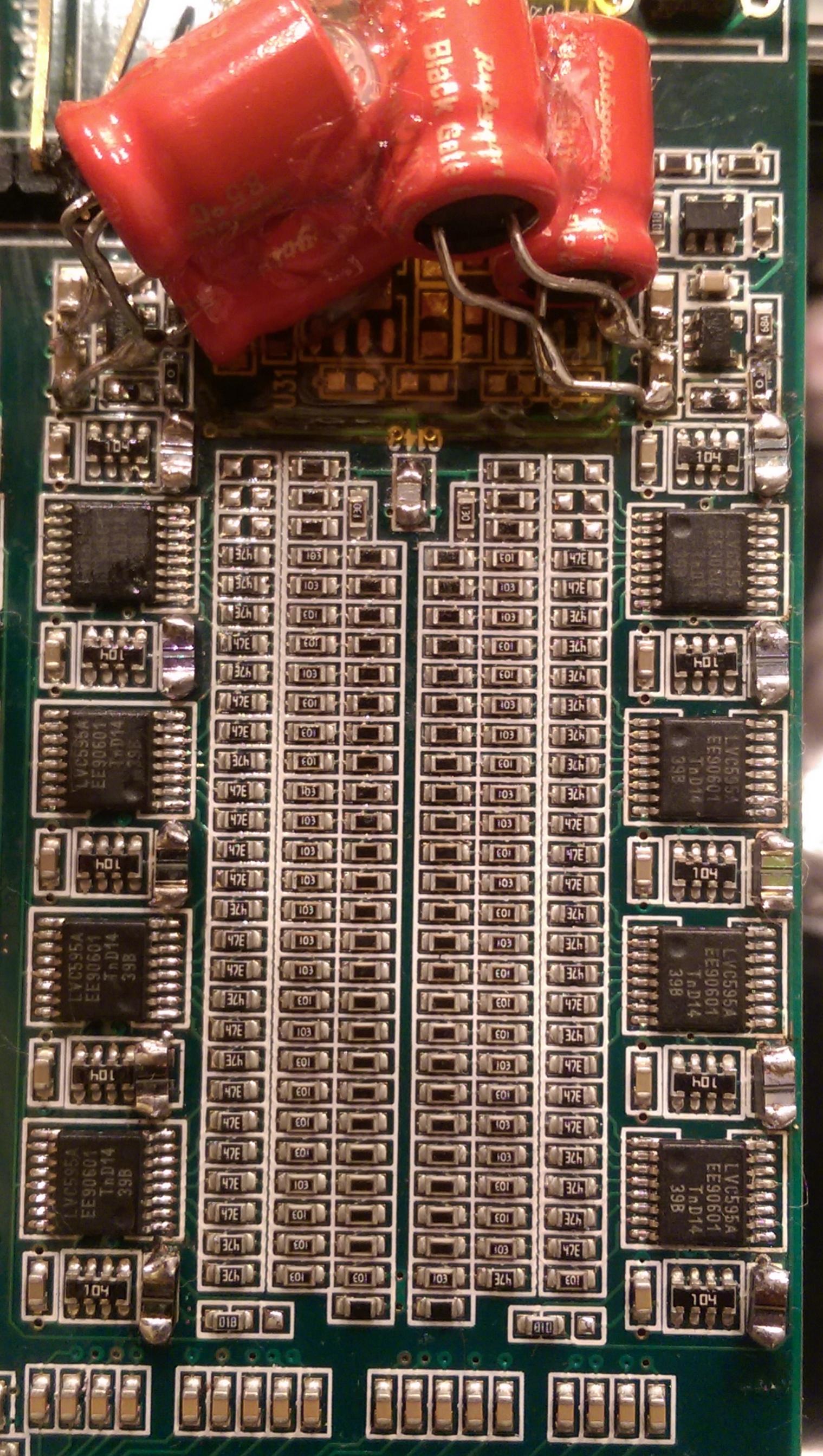

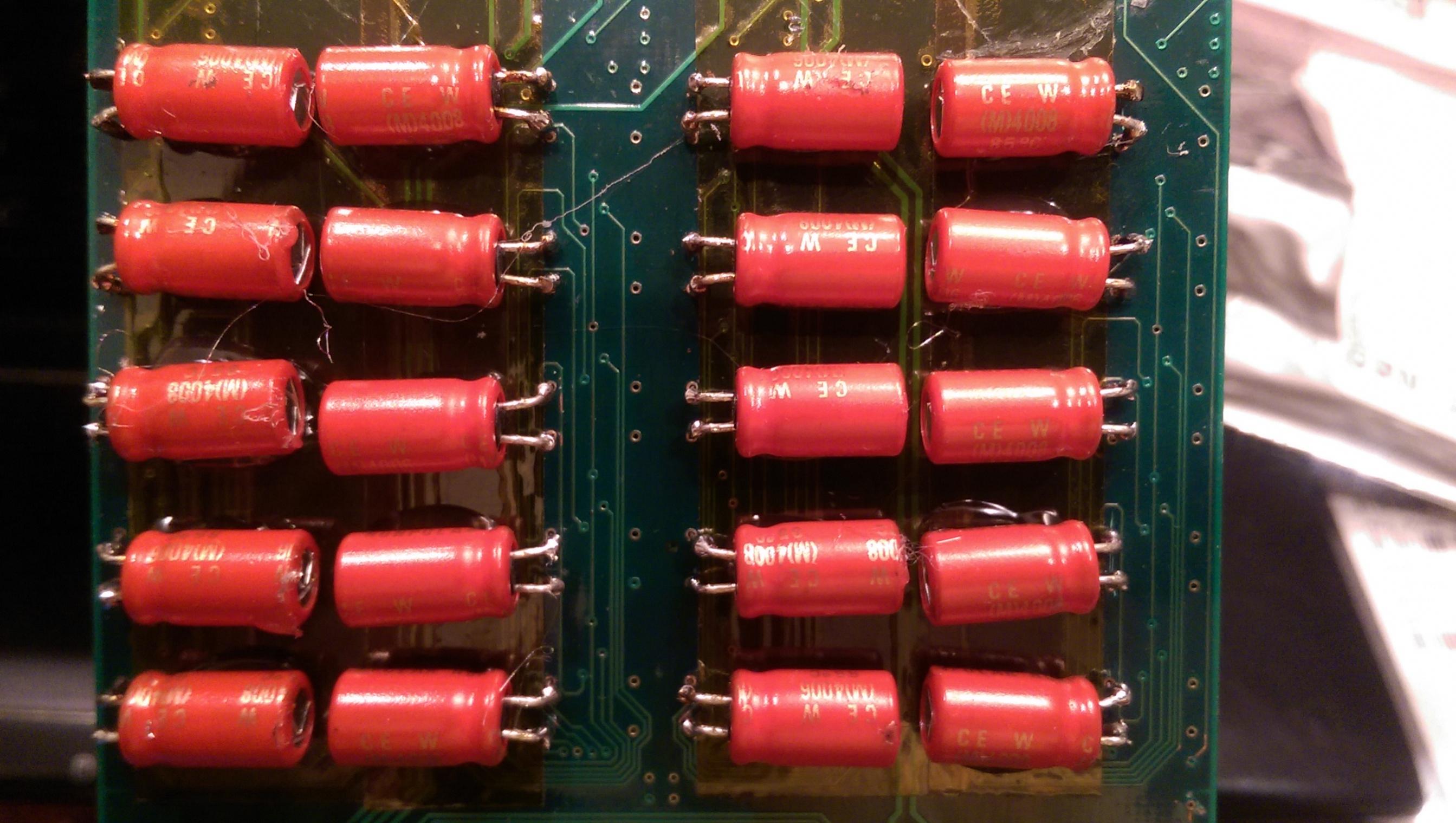

Several mods back I'd removed the output stages when I started using the RAW output and in concert with the digital-focused regulator upgrades I also would be replacing the shift register regulators and feeding them from two more separate power supplies, so I repurposed the existing filtering cap array by totally removing the negative rail array (making room for the 1.2V replacement regulator) and installing 3900uF/16V caps in the place of the positive rail caps (these were through-hole caps, I used them by insulating their bases with Kapton tape and bending the leads outward to mimic the SMD cap lead arrangement). I used the 3 caps nearest the power feed for the 3.3V rail and by removing the small filter resistor between that bank and the final cap that originally was mainly used for feeding the positive rail of the output stage, used that final cap for the 1.2V rail. ALSO by retaining the power feeds into the original cap bank, it preserved the original mute functionality and made this set of mods much easier to plan and implement.

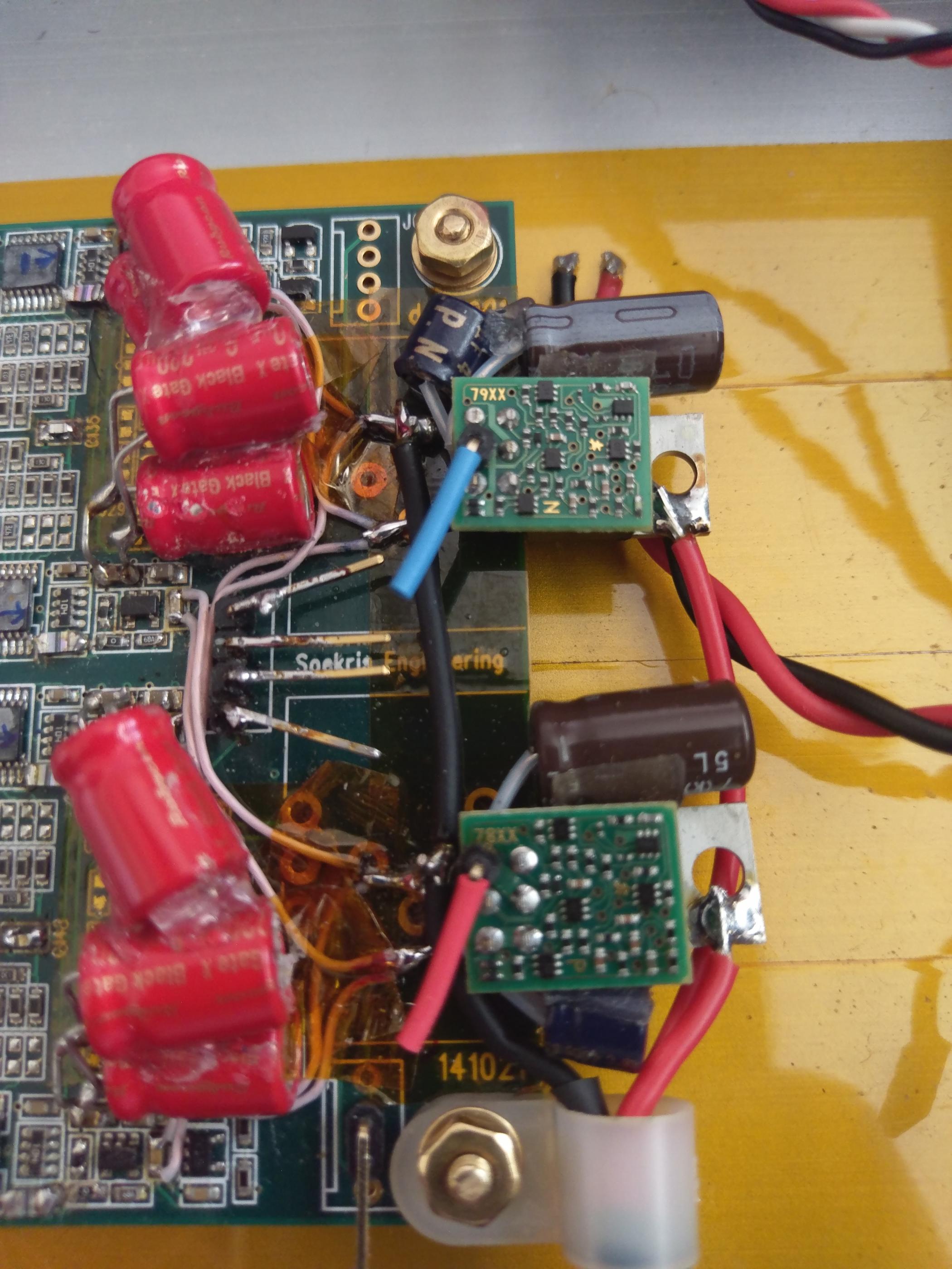

For the +-5V shift-register rails, I used a +- pair of Sparkos Labs regulators. Here, like above, I wanted to keep the regulators as close to the fed circuits as possible, so I mounted them on the output end of the board, re-using the space where the output stages had been. Then I fed the power and grounds from the regulators outputs directly to the reference voltage stages using carefully-installed 28 gauge insulated wire. These regs got 47uF Black Gate NXs on their outputs and mid-sized filter caps on their inputs.
I'd also done the VRef mods needed for my Rev1 boards a couple of years ago. Just like these mods, I went a bit over-the-top and overkill... at the VRef stages I used 2 220uF Black Gate N caps per stage and put a 33uF Black Gate N at each shift register's power feed, replacing the existing small MLCC cap with a small (.22uF as I remember) PPS SMD film cap.
Sound... was good before, better now, with better bass extension and articulation, increased macro and micro dynamics, and better instrument separation. But about the same time I also got a couple of Twisted Pear Buffalo-IIIPro implementations running and in comparison, the treble extension and detailing of the Soerkis was well behind the ESS-based setups. After some thought, I decided to try some different options for the filter caps at the output of the shift registers. Not long after I first implemented the Soekris DACs, I had replaced the ceramic caps with SMD PPS films. Originally they had been 1500pF (for some reason that was what I thought I'd seen was there value) instead of the actual 1200pF there. I THOUGHT I had replaced those with 1200pF ones at some point, but when I replaced them with 1200pF AMTRANS polyprops, it was clear that the 1500pF ones had been there all this time. My subjective assessment was that while the 1200pF polyprops provided more detailed and extended highs, I thought they could still be bettered. On a whim, I tried some LCR 1200pF polystyrenes there and the gave the extended, detailed, and sweet treble I wanted. At first I thought they might not provide sufficient filtering, thought they have improved with burn-in time. But knowing 1500pF was too much, I have some 100pF & 120pF LCRs on order to parallel with the 1200pF and tweak the the level of filtering to my preference. I mounted the caps under the board at the raw output where I already had headers in place. Sorry, I didn't take pictures when I did this... will take some of this when I try the paralleled and post them here.
Not pictured are my 4 raw supplies... I have 2 sets of them (2 separate systems) either 7A Amveco or 4A (I said I like overkill!) with some nice 30A fast recovery IXYS HiPerFRED diodes into a 47,000uF Jensen 4-Pole cap per rail. As an alternative I can also power each rail with an Uptone Audio LPS-1 or LPS-1.2 with an adapter I made... Before the mods I slightly preferred the AC-connected supplies due to slightly greater dynamics, though they did not sound as refined and quiet. I haven't tried the Ultracap supplies since the mods, but will at some point. Also the 3.3V for the input side of the I2S isolators are powered separately too, either from another AC-supply (good) or another LPS-1 set to 3.3V (better).
Yah, way over the top with some serious overkill. Worth it? YES, to my ears. Of course, YMMV!
Greg in Mississippi

Pix of one of my 2 Soekris setups, this one fed I2S from an RPi stack with an allo.com Isolator board and Kali reclocker. You can see the filter caps from the 4 supplies feeding the DAC rails in the background, along with the 2 caps for the output stage supply, not used on my Soekris setups anymore.
The other setup gets I2S from an SDTrans384 SD card player.
The main supplies are connected via a couple of multi-pin Hirose connectors, which allows me to use the same supplies with multiple DAC setups. You can see the opening for the output stage connector in the Soekris DAC box... I removed the connector since I'm not using any output stages with these DACs, I have plenty of volume and drive into my high-impedance passive volume controls in my setups.
