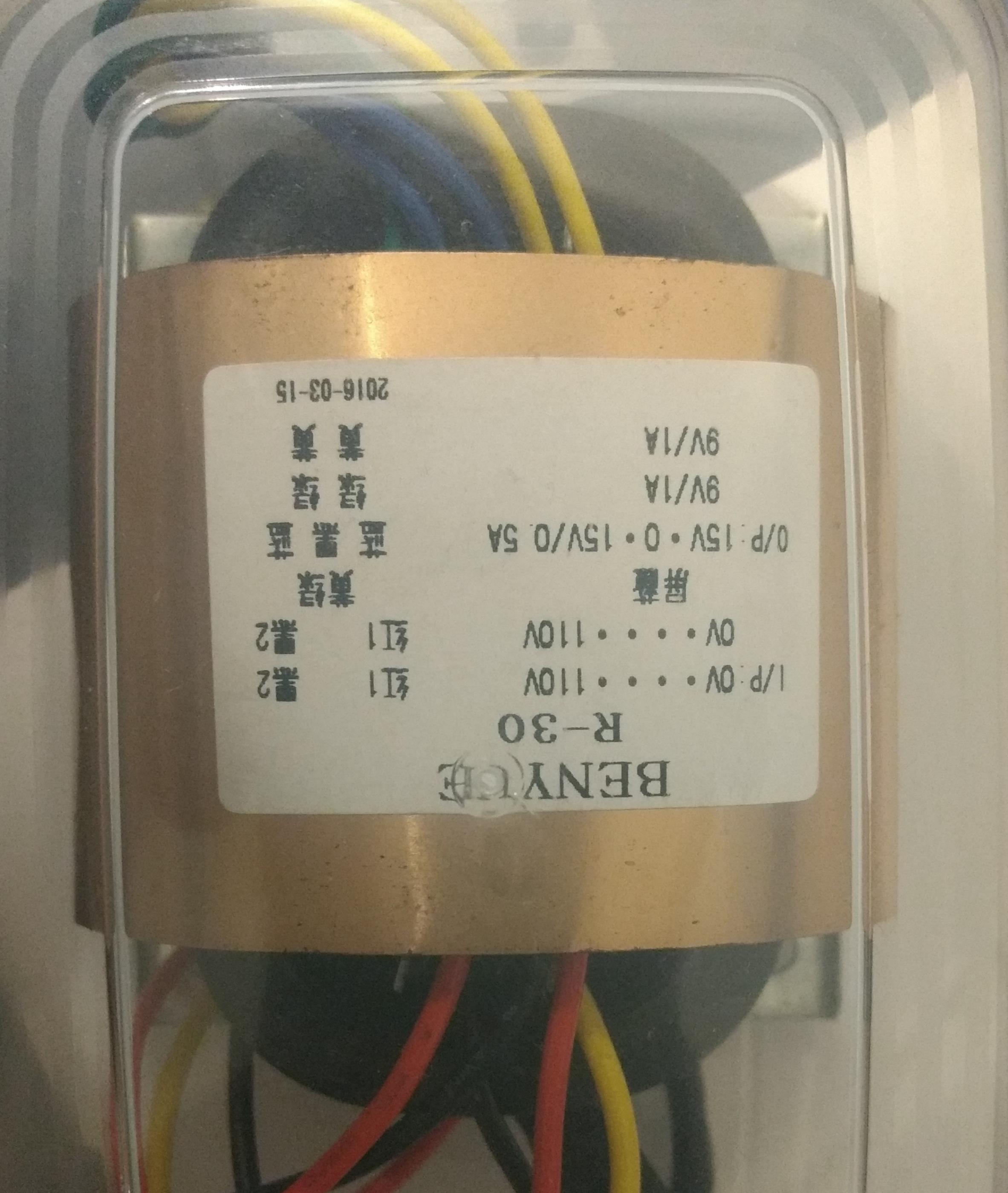

You mean also two pairs (and more) together ?
Pairwise (so that the noise gets balanced out).
You mean also two pairs (and more) together ? (I don't ask for how it's look but really if it makes a difference in a Pre or a DAC if you have several secondaries from several traffos...)
No, just individual pairs.. i didn't notice he did it with both pairs together.. that shouldn't have any effect to my knowledge
Indeed. Basically you want twisted pairs.
(I'm breathing, cause if you look at the photograph I linked : there is also a 5 traffo not in he photograph ! It would have been a little complicated to twist all together ! )
You would have had to find someone who is really good at braiding

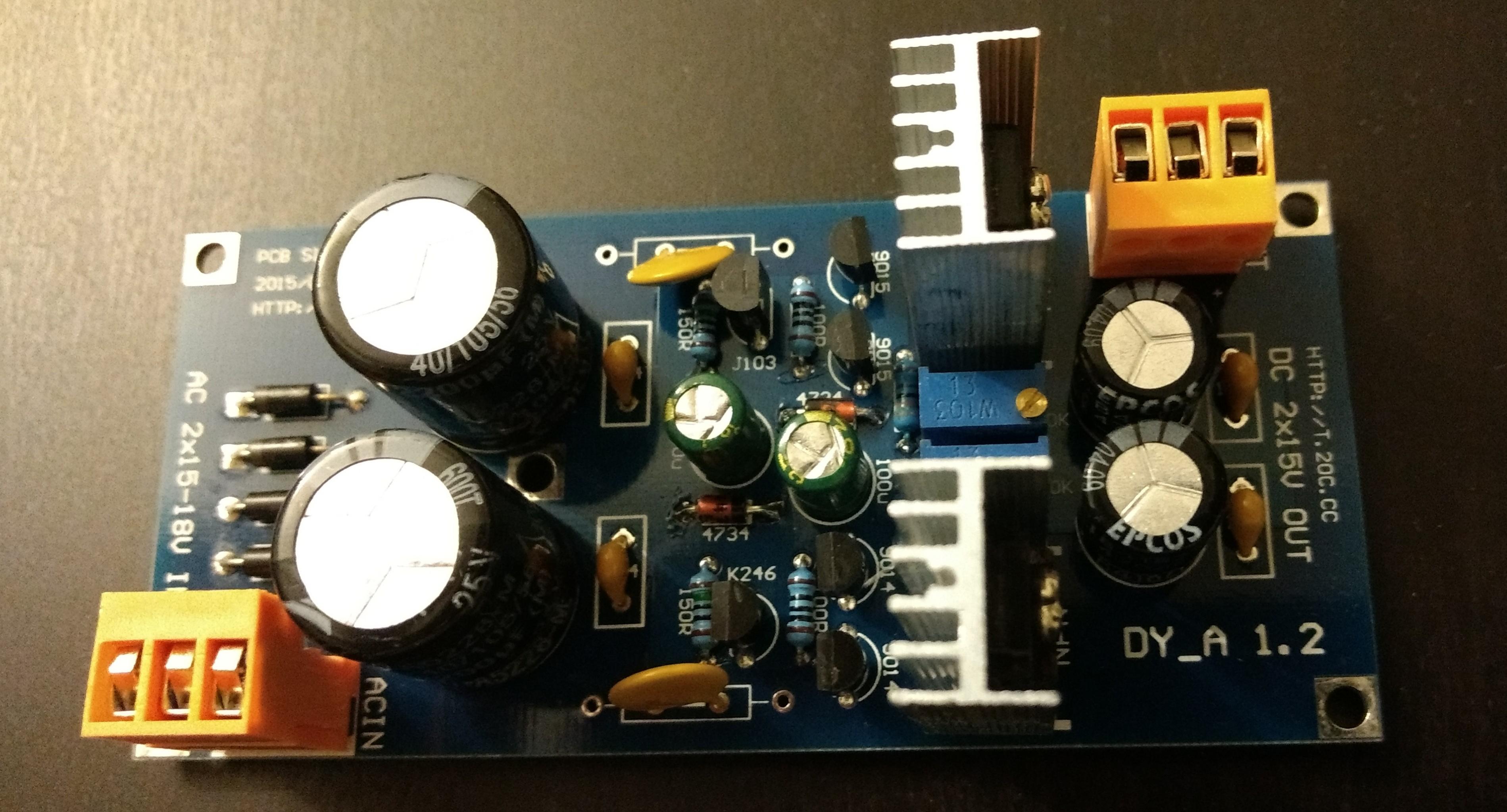

If you aint using the buffered/balanced outputs then why not feed the board directly with +-5v on the secondary side of the 5v regs... lt3032 should be better than the on board 5v regs... altough i havent checked for the obvious place to connect the power input - but there is probably a few people here that have made that mod..
Thanks, I'll look into that.

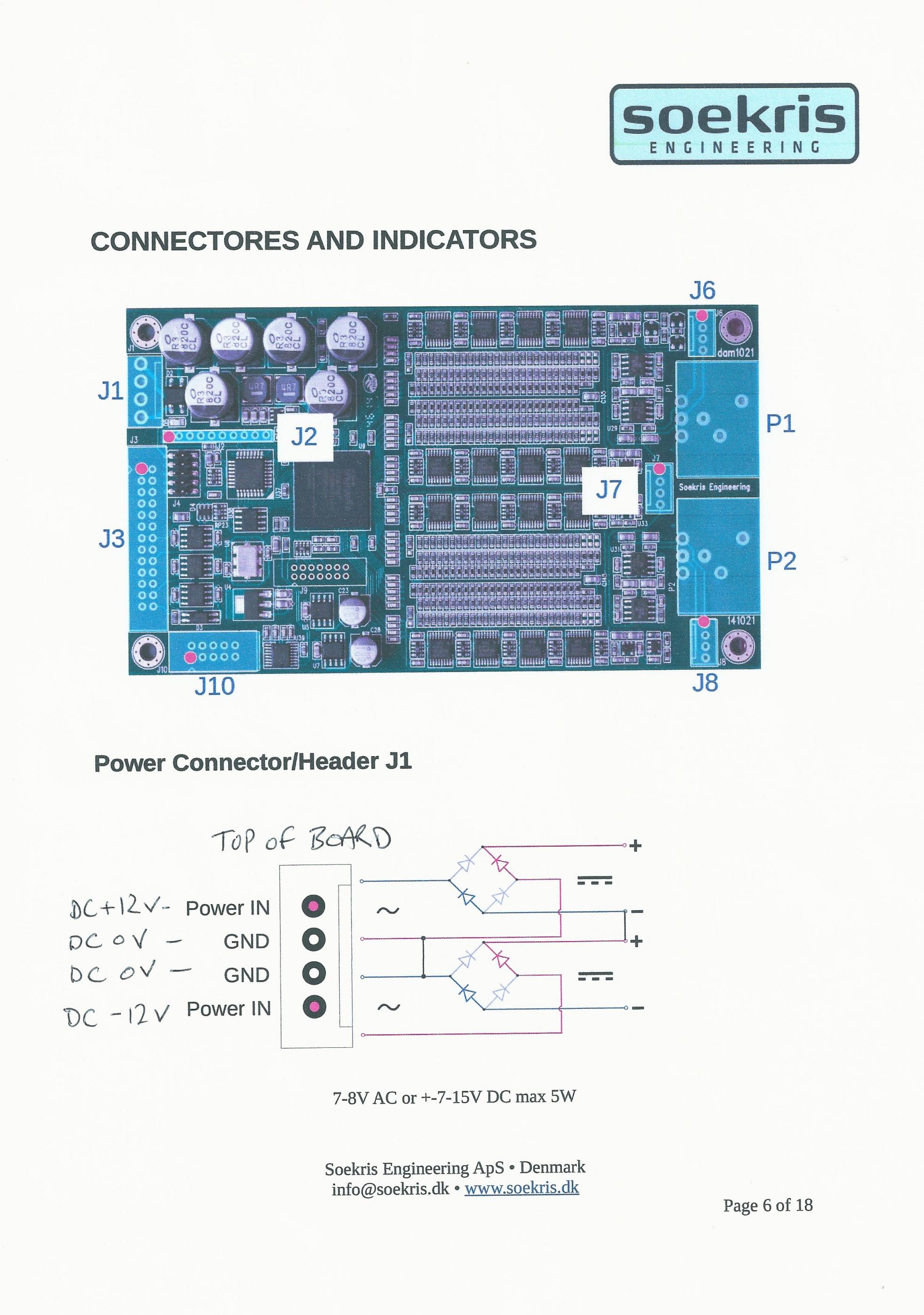

Although I'm slightly embarrassed to ask the Forum - please could you advise as to whther, if using +12V 0V -12V DC power supply to the Soekris DAM 1021 board, should I connect it as I have drawn on the reference manual page?
I've just received my board and don'twant to make a stupid mistake and watch smoke curl into the air above it.......!

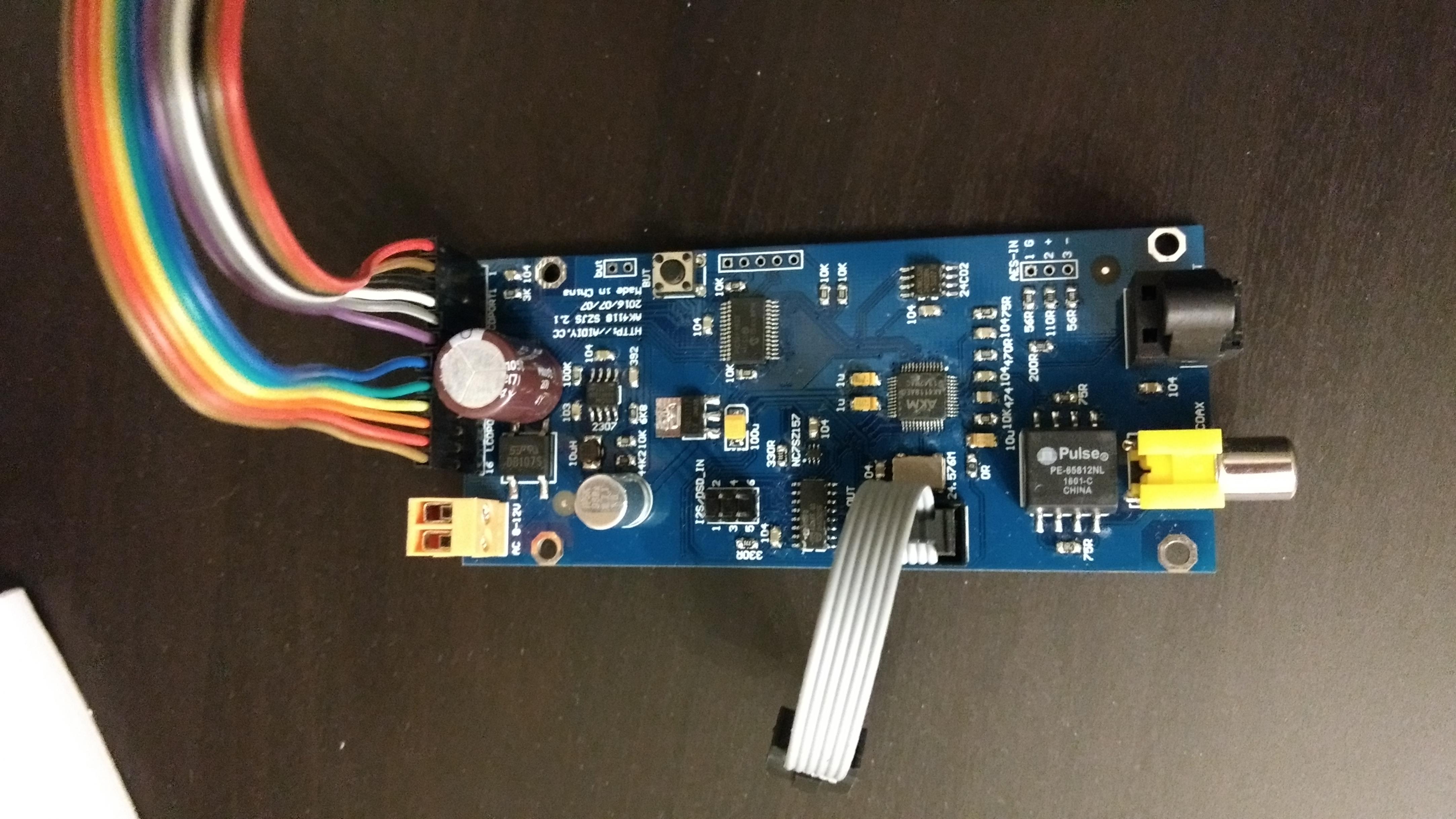

and this board (powered from the 9V ac output of the above transformer) to provide the i2s input to the Soekris DAM from an optical/coaxial S/PDIF input.
I'm just figuring out how I'm going to provide the 3.3V dc that I have read that the i2s input requires though!

Try here: https://hifiduino.wordpress.com/2015/03/16/soekris-dam-1021-r-2r-dac-users-guide/

Many thanks vdi_nenna - that guide is really helpful
